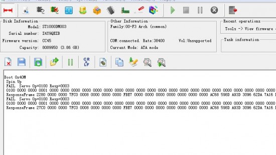

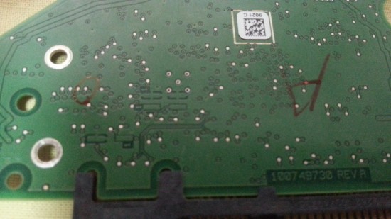

 Post subject: LuxorLite-94 ST1000DM003-1SB102-Z9A5KRPD
PostPosted: September 27th, 2018, 1:40
Joined: September 10th, 2018, 5:48
Posts: 97
Drive spins up in starting and spins down as terminal message appears.
i think virtual loader might help.
i am looking for the loader file please help and support with suggestions.
S2.PNG [ 48.6 KiB | Viewed 21084 times ]
S1.PNG [ 50.77 KiB | Viewed 21084 times ]
 Post subject: Re: LuxorLite-94 ST1000DM003-1SB102-Z9A5KRPD
PostPosted: September 27th, 2018, 2:26
Posts: 474
Location: spain
The first thing you have to do is unlock the firmware.
With this you will have access to read the SA.
Once you have access to the SA, make a complete copy of all the resources of the SA, if it leaves you and then you will know that it is not a problem of heads.
I think that disk can be easy to solve, but do not rush.
 Post subject: Re: LuxorLite-94 ST1000DM003-1SB102-Z9A5KRPD
PostPosted: September 27th, 2018, 6:06
Joined: September 10th, 2018, 5:48
Posts: 97
i need 3D to test it virtually.
if anyone can help with that?
 Post subject: Re: LuxorLite-94 ST1000DM003-1SB102-Z9A5KRPD
PostPosted: October 4th, 2018, 4:04
Joined: September 10th, 2018, 5:48
Posts: 97
Sure,
Thanks you so much for your guidance.
i will try to swap head and check it again.
Thanks again
 Post subject: Re: LuxorLite-94 ST1000DM003-1SB102-Z9A5KRPD
PostPosted: October 4th, 2018, 12:12
Posts: 474
Location: spain
I do not understand a thing of this case.
If the heads are wrong, how can the model and capacity detect without problems?
 Post subject: Re: LuxorLite-94 ST1000DM003-1SB102-Z9A5KRPD
PostPosted: October 5th, 2018, 8:15
Joined: September 10th, 2018, 5:48
Posts: 97
Tried Virtual Boot, Error in exchange commands.
Not Successful.
Head Swap Done, Same result.
Any more solution?
 Post subject: Re: LuxorLite-94 ST1000DM003-1SB102-Z9A5KRPD
PostPosted: October 5th, 2018, 10:28
Posts: 474
Location: spain
I would do the following:
First unlock the firmware to access the SA.
Then repair mcmt problem.
And I hope you have access to the data.
I hope they have not damaged their heads.
screen.jpg [ 221.86 KiB | Viewed 20849 times ]
 Post subject: Re: LuxorLite-94 ST1000DM003-1SB102-Z9A5KRPD
PostPosted: October 10th, 2018, 6:59
Joined: September 10th, 2018, 5:48
Posts: 97
Failed to Unlock ROM.
 Post subject: Re: LuxorLite-94 ST1000DM003-1SB102-Z9A5KRPD
PostPosted: June 17th, 2019, 9:05
Posts: 489
Location: Usa
Strange HDD doesnt have sticker originaly.
No info about HDD.
PCB:100749730 revA
PCB died. Client send me a donor PCB. Lucy Its compatible.
I removerd patient ROM . Readed. And writed to Donor PCB.
Here ROM Patient.
ROM.rar [264.83 KiB]
Downloaded 902 times
20190617_124351.jpg [ 272.65 KiB | Viewed 19284 times ]
cc45.JPG [ 70.88 KiB | Viewed 19284 times ]
Also Head swap necesary. Heads died.
How could I chose donor for head swap.. I need help.
No terminal access. Not get T level or anything. Stopping after
Boot 0x40M
Spin Up
FAIL Servo Op=0100 Resp=0003
0100 0000 0000 0001 0000 0000 0000 0000 0000 0000 0000 0000 0000 0000 0000 0000 0000 0000 0000 0000 0000 0000 0000 0000 0000 0000 0000 0000 0000 0000 0000 0000
ResponseFrame 2280 0000 0000 7FC0 0008 0000 0000 0000 FBE7 0000 0000 0000 0000 0000 0000 0000 AC68 598D A93D 3096 62DA 7A16 FBF3 FD00 BF21 F4A1 0000 007F 0004 0000 FFF7 0004 0010
20190617_161059.jpg [ 387.43 KiB | Viewed 19283 times ]
20190617_161118.jpg [ 364.33 KiB | Viewed 19283 times ]
Is ıt read channel marked with circle?
Sexy Womans from your town
 Post subject: Re: LuxorLite-94 ST1000DM003-1SB102-Z9A5KRPD
PostPosted: June 17th, 2019, 11:38
Joined: March 6th, 2010, 3:46
Posts: 627
Location: Kolding | Denmark
@HddDonorMarket
I hope not this drive is a client case, you really need some basic training.
ROM for that drive will tell you all you need to chose the right donor.
Digitalsupport Data Recovery
https://digitalsupport.dk
 Post subject: Re: LuxorLite-94 ST1000DM003-1SB102-Z9A5KRPD
PostPosted: June 17th, 2019, 13:05
Posts: 489
Location: Usa
What a ....
HDD owners saying drive not opened. But opened before. No filter inside. Ramp mounted wrong so head stacked front ramp. Sticker removed by someone. I saw when look again drive cover closely. I am not sure about if that rom original. So guarantee paper come with drive. Drive model number different on that paper.
I have 2 donor. But don't know whether possible to get data if ROM not original.
Look like I would spend 1 random donor . Look like this would be a bad experience and I would spend a donor. I don't like Seagate also.
Sexy Womans from your town
Last edited by HddDonorMarket on June 17th, 2019, 13:11, edited 1 time in total.
 Post subject: Re: LuxorLite-94 ST1000DM003-1SB102-Z9A5KRPD
PostPosted: June 17th, 2019, 13:09
Posts: 489
Location: Usa
digisupport wrote:
@HddDonorMarket
I hope not this drive is a client case, you really need some basic training.
ROM for that drive will tell you all you need to chose the right donor.
This is client case. But after closer look , there is very bad DIY attempt happened before to drive.
Sexy Womans from your town
 Post subject: Re: LuxorLite-94 ST1000DM003-1SB102-Z9A5KRPD
PostPosted: June 17th, 2019, 17:50
Joined: July 12th, 2010, 4:38
Posts: 1455
If ROM is not original, you can't do nothing to recover it.
ACELab partner
