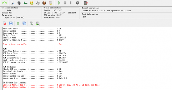

 Post subject: WD LDR REQUIRED 0015002G Dragfly2
PostPosted: October 13th, 2018, 5:46
Joined: September 10th, 2018, 5:48
Posts: 97
If anyone can help with that
wd LDR.PNG
wd LDR.PNG [ 38.32 KiB | Viewed 8205 times ]
 Post subject: Re: WD LDR REQUIRED 0015002G Dragfly2
PostPosted: October 13th, 2018, 10:08
Posts: 474
Location: spain
Can you put a complete image with the status indicators, just when it detects it without performing any operation?
 Post subject: Re: WD LDR REQUIRED 0015002G Dragfly2
PostPosted: October 14th, 2018, 8:03
Posts: 1388
Location: isreal
https://forum.hddguru.com/viewtopic.php ... 91#p210904
 Post subject: Re: WD LDR REQUIRED 0015002G Dragfly2
PostPosted: October 15th, 2018, 5:52
Joined: September 10th, 2018, 5:48
Posts: 97
not working.
Users browsing this forum: No registered users and 64 guests
