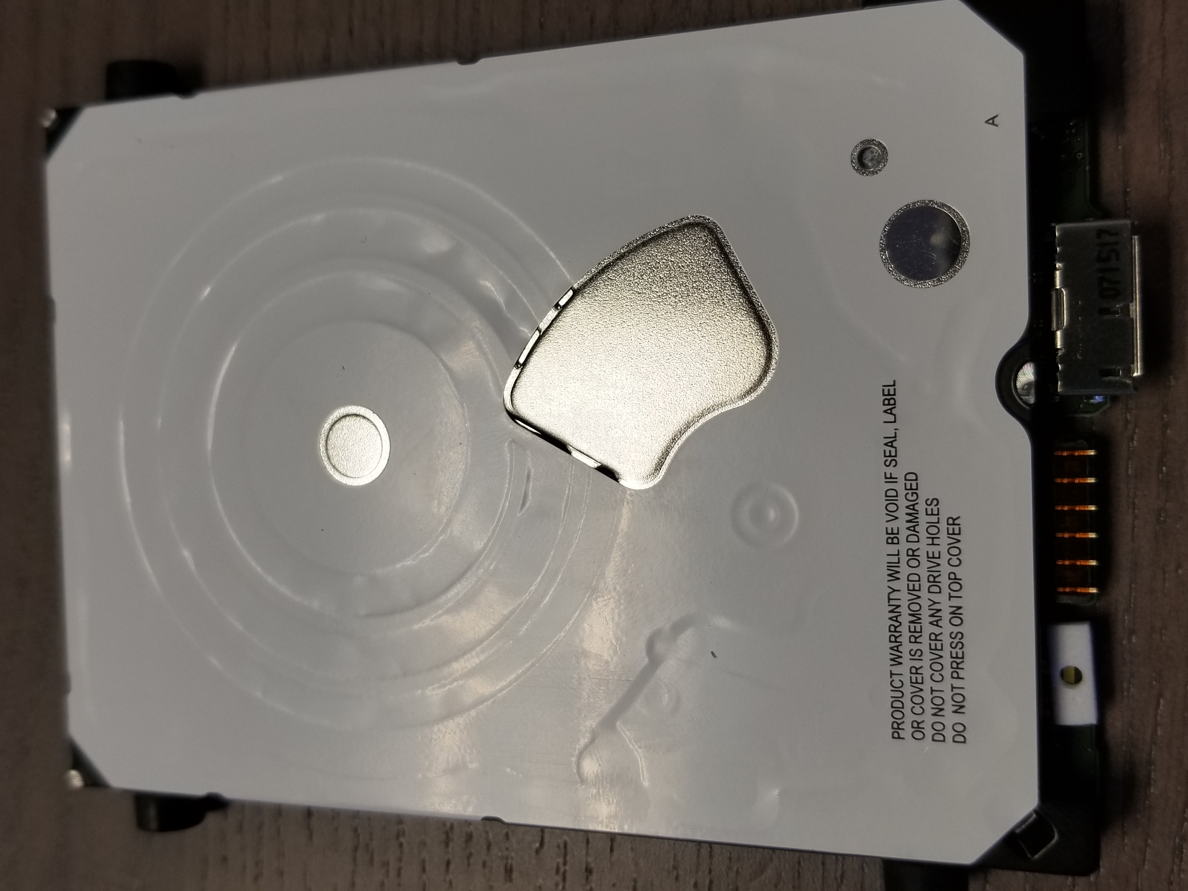

 Post subject: WD Thin Label Removal
PostPosted: November 2nd, 2018, 14:37
Posts: 1777
Location: Phoenix, AZ USA
Anyone found a good way to remove the label on these drives? Rosewoods are easy in comparison.
20181102_113410.jpg [ 2.6 MiB | Viewed 5903 times ]
 Post subject: Re: WD Thin Label Removal
PostPosted: November 2nd, 2018, 16:48
I do it in similar manner as Rosewood...just with more tearing and yelling at it.
 Post subject: Re: WD Thin Label Removal
PostPosted: November 2nd, 2018, 16:51
Posts: 1777
Location: Phoenix, AZ USA
lcoughey wrote:
I do it in similar manner as Rosewood...just with more tearing and yelling at it.
LOL. Yes you can't seem to help tearing the label, a real PITA. Makes us look unprofessional if a client decides not to go ahead with the recovery and you hand them back a hard drive that look like my dog has chewed it.
 Post subject: Re: WD Thin Label Removal
PostPosted: November 2nd, 2018, 17:39
Posts: 3598
Location: Chicago
I see that Chargers are everywhere now
Fun drives
I just cut through, peeling is PITA
 Post subject: Re: WD Thin Label Removal
PostPosted: November 3rd, 2018, 1:02
Give it a gentle hot air round to loosen the glue and those labels peel off smoothly.
Users browsing this forum: Majestic-12 [Bot] and 113 guests
