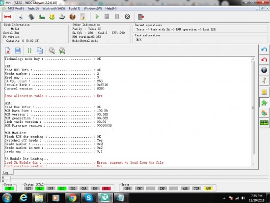

 Post subject: Zone allocation table : ........................: Err
PostPosted: December 29th, 2018, 10:29
Joined: December 25th, 2018, 3:15
Posts: 11
Location: Varanasi
Technology mode key : ..........................: OK
RAM:
Read HDD Info : ................................: OK
Heads number : .................................: 2
Head map : .....................................: 3
SA Cyl Count : .................................: 256
Serials Mark : .................................: 0xFE16
Control version : ..............................: 63B0
Zone allocation table : ........................: Err
ROM:
Read Rom Infos : ...............................: OK
ROM Data Size : ................................: 192 Kb
ROM version : ..................................: 03.36B
ROM generation : ...............................: 03.36B
Link table version : ...........................: 03.0Q
ROM Firmware version : .........................: 00030036
ROM Modules:
Flash ROM dir reading : ........................: OK
Switched off heads : ...........................: Yes
Heads number : .................................: 0x2
Heads number in use : ..........................: 0x2
heads map : ....................................: 0,1
SA Module Dir Loading...
Load SA Module dir : ...........................: Error, suggest to load from the file
Configuration reading : ........................: Err
500.jpg [ 211.86 KiB | Viewed 8258 times ]
