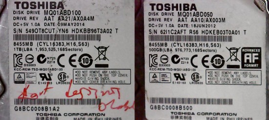

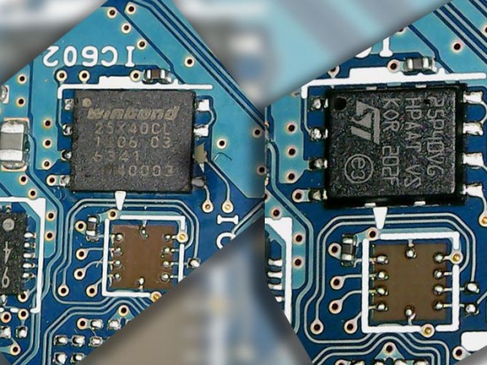

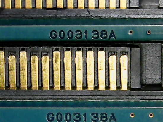

 Post subject: Toshiba MQ1ABD050 PCB Hot Swap Tested
PostPosted: January 6th, 2019, 11:13
Posts: 489
Location: Usa
This PCB Hot Bios Swap working.
Tested
MQ1ABD050
MQ1ABD100
same PCB Number
diffrent brand Bios Chip .
Its compatable. Tested. Ok
2.jpg [ 212.22 KiB | Viewed 4641 times ]
1.jpg [ 139.4 KiB | Viewed 4641 times ]
Sun Jan 06 17-43-47.jpg
Sun Jan 06 17-43-47.jpg [ 84.9 KiB | Viewed 4641 times ]
Sexy Womans from your town
 Post subject: Re: Toshiba MQ1ABD050 PCB Hot Swap Tested
PostPosted: January 6th, 2019, 11:48
Posts: 489
Location: Usa
I love Toshiba.
Allways nice 4 my recovery arrempt.
Toshiba hdd PCB match so eays . Don't look anything. Just match PCB number.
Mostly WD PCB also same.
Sexy Womans from your town
Users browsing this forum: Majestic-12 [Bot] and 74 guests
