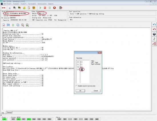

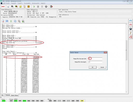

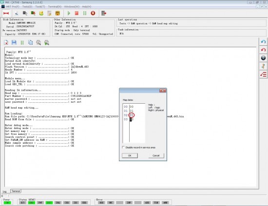

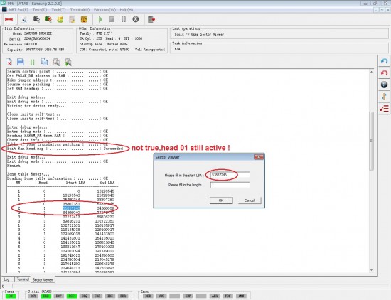

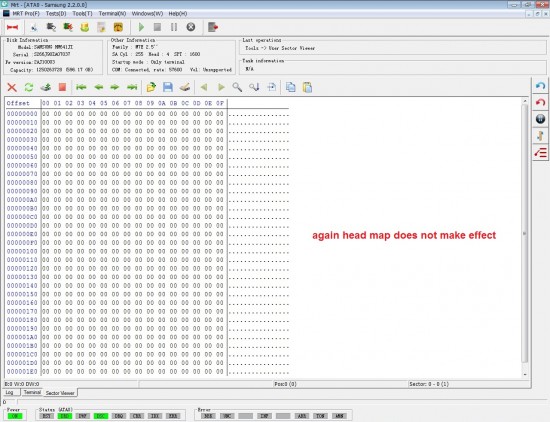

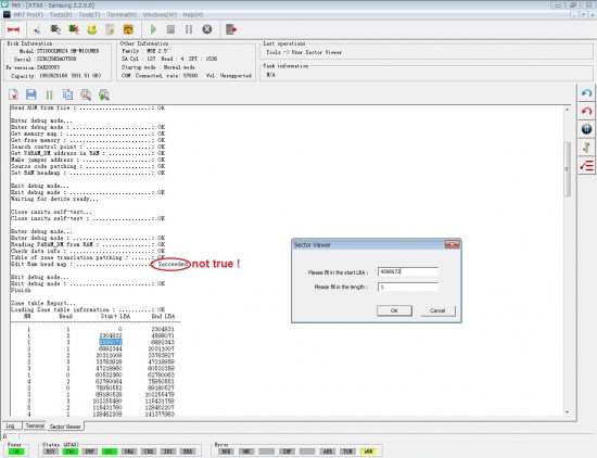

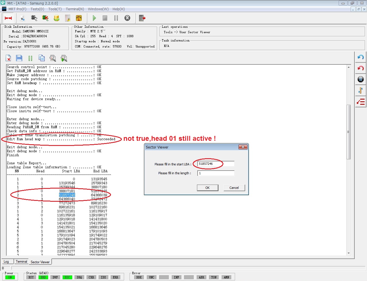

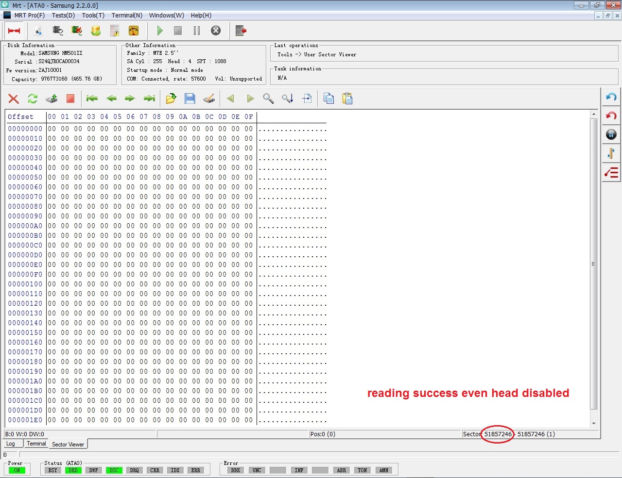

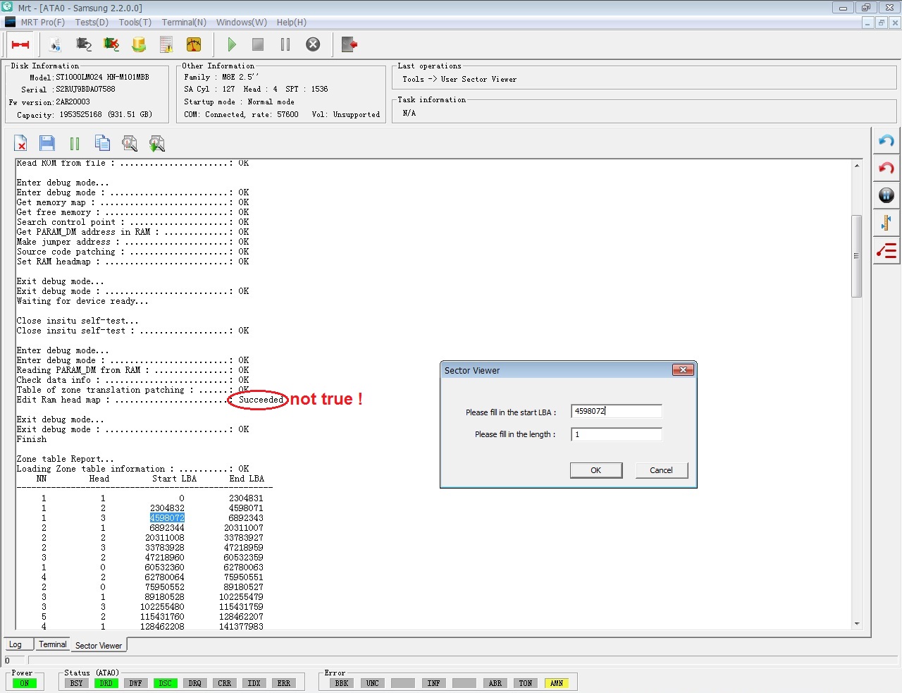

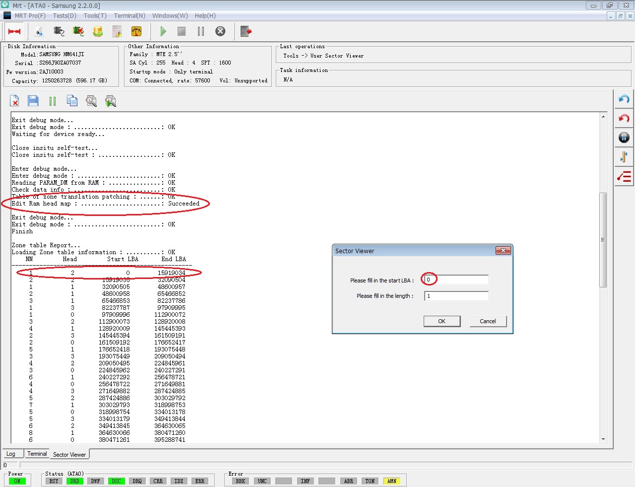

reco wrote:
drives produced during 2010-2016,such as?
Yea,the list you mention worth nothing,MRT used old trick instead report fail software report succeeded while in fact it failed.
And @vx1 if MRT want to base they tool on seagate they should inform people,we geting drives to recover data also from samsung,hitachi,wd,toshiba and for those drives MRT support list (I mean real support) growing extremely slow.

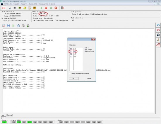

Seems you already updated and tested the program with research purpose like what I am doing right now. But if your investigation goes deeper, you may find that when you disable head 01 by filling 00, the original map directing to sector of head 01 would be redirected to other sectors located on tracks not belonging to head 01. This is my assumption based on my observation so far.
