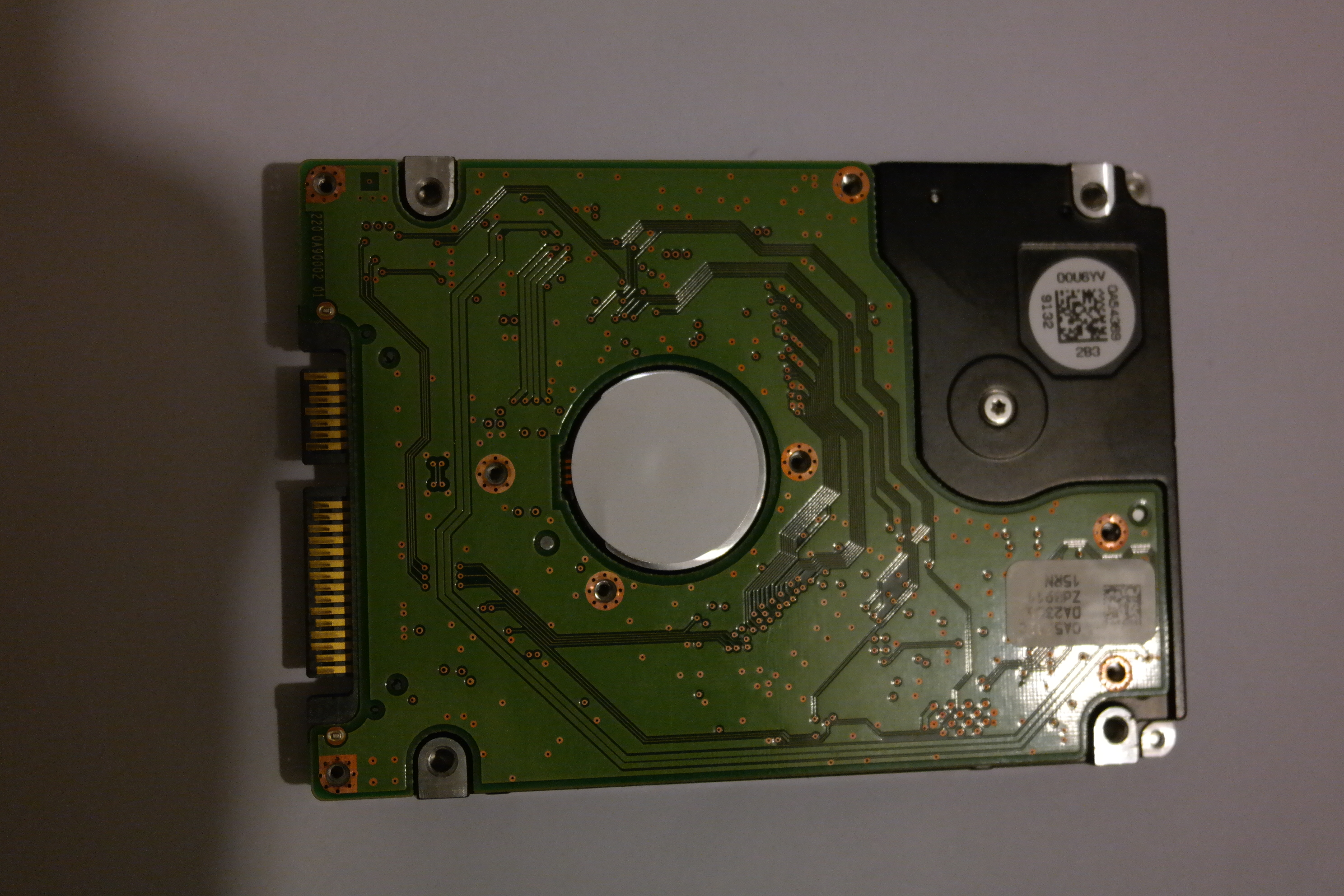

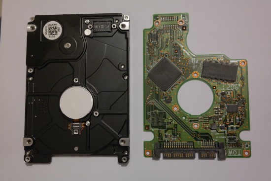

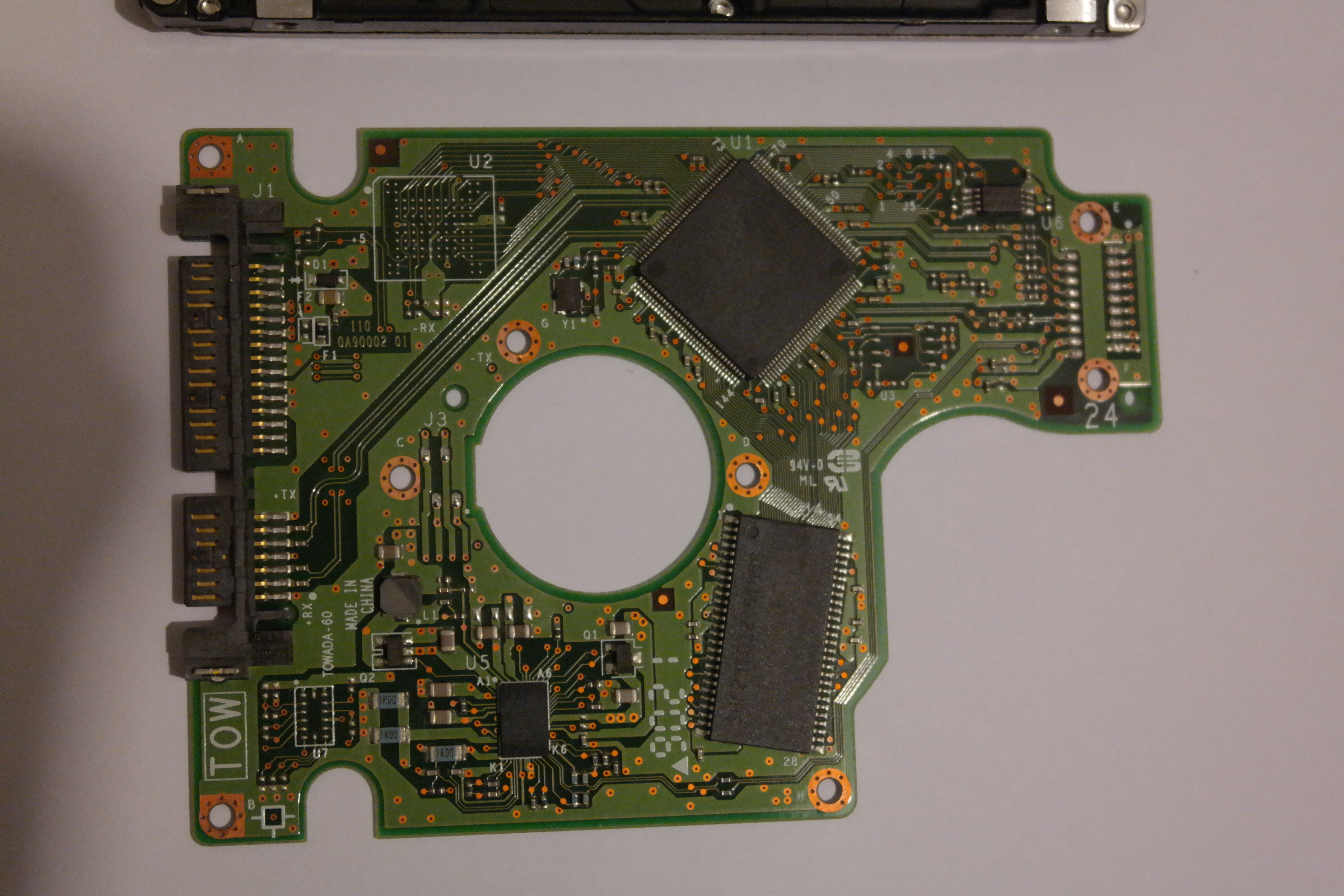

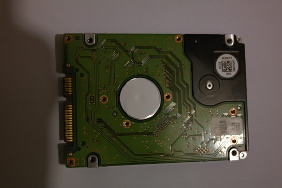

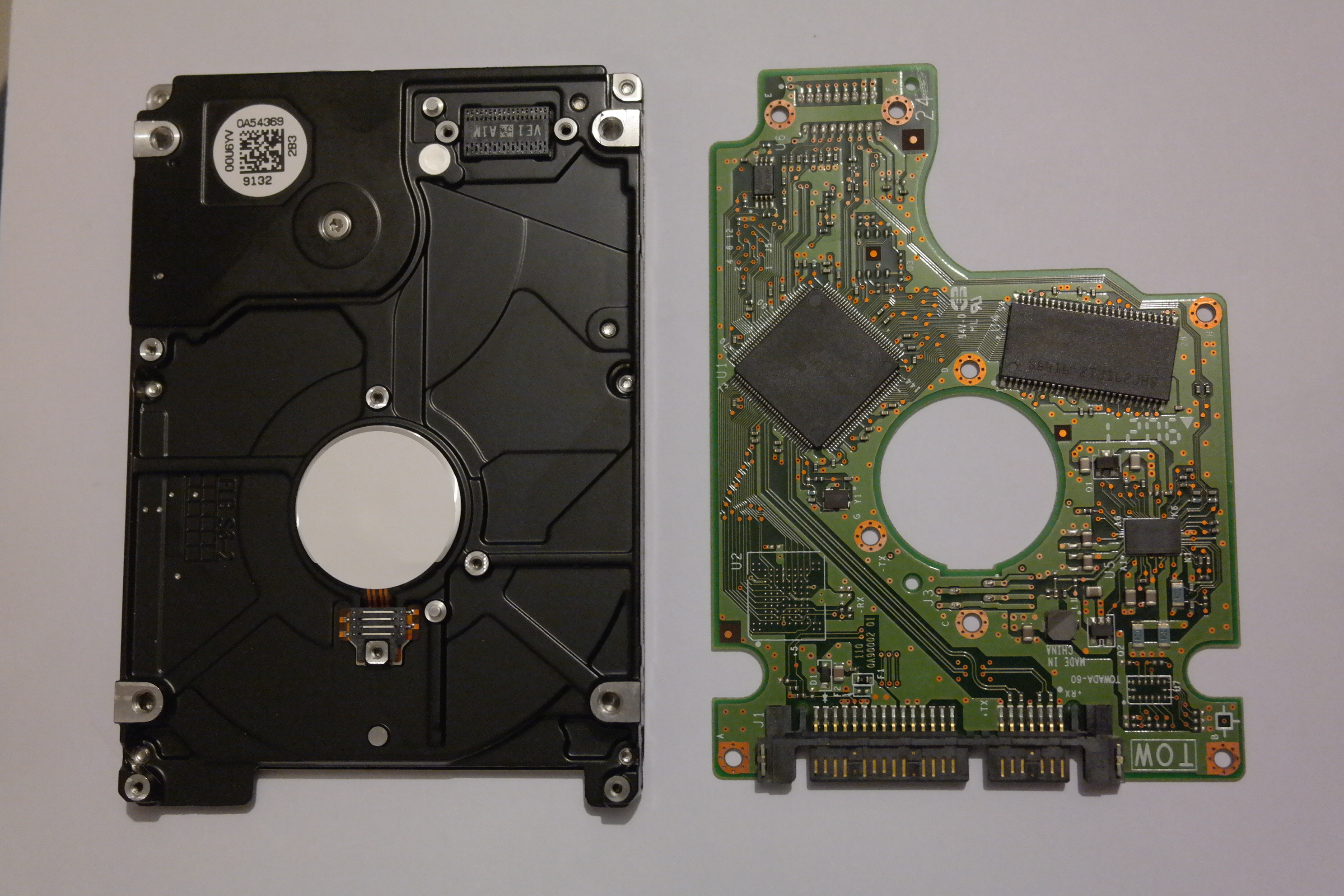

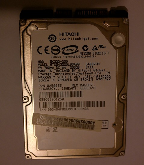

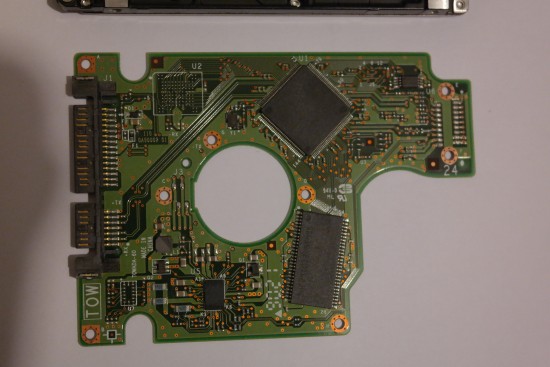

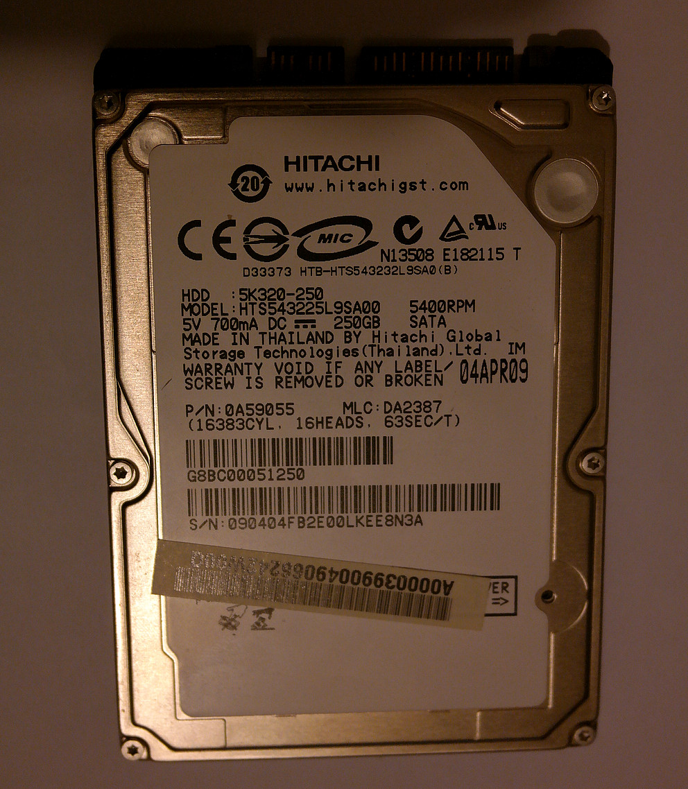

My laptop's HDD stopped spinning. The drive's model is 5K320-250 / HTS543225L9SA00, from 2009, 2.5" form factor, 250GB capacity.
Background :
It was plugged to my main desktop computer through a USB adaptor for a few days (actually it's the USB board from a 3.5" external enclosure – I won't trust these things anymore as their power supplies seem unreliable), I was transfering files to a larger HDD, and trying to figure out a strange issue which happened a few months ago (I haven't used the laptop computer since), probably unrelated (1), proceeding quite slowly.
Yesterday it was functioning normally, today it doesn't spin at all, no noise, nothing. I tried plugging it internally, no luck either. There's no visible sign of damage, burnt component or similar, that I can identify. Before that the drive had 3 reallocated sectors, but they were there already when I acquired that computer (purchased used in 2012), and it has remained stable ever since (up until yesterday HD Sentinel displayed a 95% health status for that drive). All my computer related devices are powered through a UPS (2).
Pretty much everything on the “Data” partition is saved somewhere, while the most important data from the “Vista” system partition is also backed-up. I was planning on doing a full system backup with Acronis True Image right after those operations, but now it's too late – unless I manage to get the drive operational again, at least temporarily ; I do have a full system backup but it's from 2014, although little has been changed since then to the system or the installed programs, so at worst I could still rely on that to get the computer up and running. But of course ideally I'd like to get that drive working again, so that I can at least make an updated system backup and/or clone the whole contents to another drive (3).
Questions :
– Could it be a case of a shorted TVS diode ? How can I identify those, and how can I test those ? (I've read several threads regarding similar issues but never had the opportunity to perform practical tests so I forgot the specifics.) If one of these tiny things turns out to be the culprit, can it safely be removed using a regular soldering iron, or does it require a specific tool ?
– Failing that, is this a model on which the PCB can be swapped directly in order to regain access to the drive, or is there a ROM component to solder onto the replacement board, or does it require professional firmware tools ?
– Could it be another kind of issue, not related to the PCB ?
Thanks,
G.
(1) In the course of a very long work session – the computer had been put in hibernation repeatedly for weeks or months with no reboot – the system began acting up (I don't remember the details), I tried to save everything I was doing and reboot normally, but it froze instead, I had to shut it down the hard way ; then the next time it booted I noticed that the files I had created just before rebooting (while trying to save everything useful from the open windows) were unreadable, they appeared as blank. Yet, when opened through WinHex's own explorer, I could see seemingly random contents at their location on the volume, but in the “Attributes” column they were marked as “partial init.”, meaning, according to the integrated help, that the contents on those files' locations do not correspond to the actual contents of the files (it usually is former data which was present before the file was created), and therefore those bytes are interpreted by the system as empty (even if I open one of these files in WinHex from Windows Explorer, it appears as blank ; R-Studio displays and saves them as blank, while Recuva displays and saves their erroneous contents, same as WinHex when reading them from within its own explorer). It's the first time I see something like this. Also, several programs were no longer working properly (most notably, Firefox failed to restore the previous session, even with a backup made days before those issues appeared).
(2) Sunday afternoon the UPS has been briefly emitting an alarm, about 3 times 1-2 sec. within an hour or so, and when it did the “battery capacity” was reported as 1-2%, which is abnormal since it stays plugged continuously and each incident was very brief (now it's back to 100% capacity but I don't know if I can trust it), so it's possible that there were electrical problems in my area, or that the battery from the UPS is malfunctioning, or both ; this may be related with the current issue.
(3) I was planning on migrating that drive's contents to a 240GB SATA SSD, having installed a PCIe SSD on my desktop computer, but I've had weird issues with that too (most notably an abnormally long wake-up time from hibernation, about 5min. with a Samsung 950 Pro, I still haven't solved this), so it's one more thing that has been lagging lately...

Without current:
Prove that f1 is driving 0 ohm.
d1 (tvs or diode zenes I do not know) does not have to be short-circuited.
With isolated pcb current.
f1 5v at both ends.
d1 on one end 5v on the other gnd.
Do you use MRTLAB or something similar, if you do not mind saying it?
You can also measure the resistance of the motor as indicated in:
https://forum.hddguru.com/viewtopic.php?f=1&t=37525

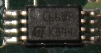

- You need to move ROM chip (on ARM) + ROM chip and NVRam chip on older IBM based drives from the broken PCB to the new one, assuming the code on the chip is ok.
And so am I correct in assuming that the ROM chip is located in “U6”, on the thinner portion of the PCB ? Where would the NVRam chip be ? On that particular model, what would it be ? Moving one of those tiny chips seems to be a tricky procedure, especially on a 2.5" drive ; what kind of tool is required to perform this safely ?

 Post subject: Re: Hitachi 2.5" 250GB suddenly stopped spinning
PostPosted: October 28th, 2018, 19:47
Posts: 17230

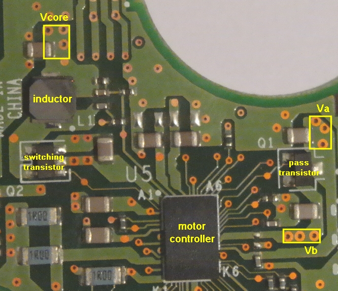

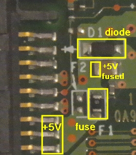

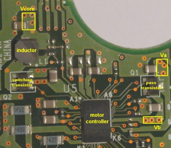

Measure the voltages at the test points marked +5V, +5V fused, Va, Vb, and Vcore.
PostPosted: November 5th, 2018, 22:20
Posts: 309
Location: France
@fzabkar :
It's hard to say for sure with that messed-up multimeter (for now I made a quick-and-dirty repair with a needle as a makeshift probe), and I'm not sure where exactly to put the probes when there are three points, but :
– I get 4.97V at "fuse" (that one at least is consistent)
– at "+5V" I get 0V if I place the two probes at either of the three points you highlighted, but 4.97V between either one of those three points and the one above that (in front of "fuse") or the one below that...
– at "+5V fused" I get 0V but I'm not sure if I'm measuring correctly as you highlighted the left side only...
– "Va", "Vb", "Vcore" are all at 0V, no matter where I put the probes...
– I get about 1.50V at the two points near the upper edge of the second picture (regs.jpg), at the right side of Vcore, but it's not stable, I've measured it at 1.25, 0.9, 0.1, just moving a tiny bit it goes up and down... and I've no idea if it's at all relevant...
PostPosted: November 6th, 2018, 0:21
Posts: 17230
When you measure a voltage, you are measuring a difference in potential between two points. One point is usually the ground reference, eg a screw hole. That's where you place the black probe. The red probe is placed on the test point that you wish to measure, eg Va, Vb.

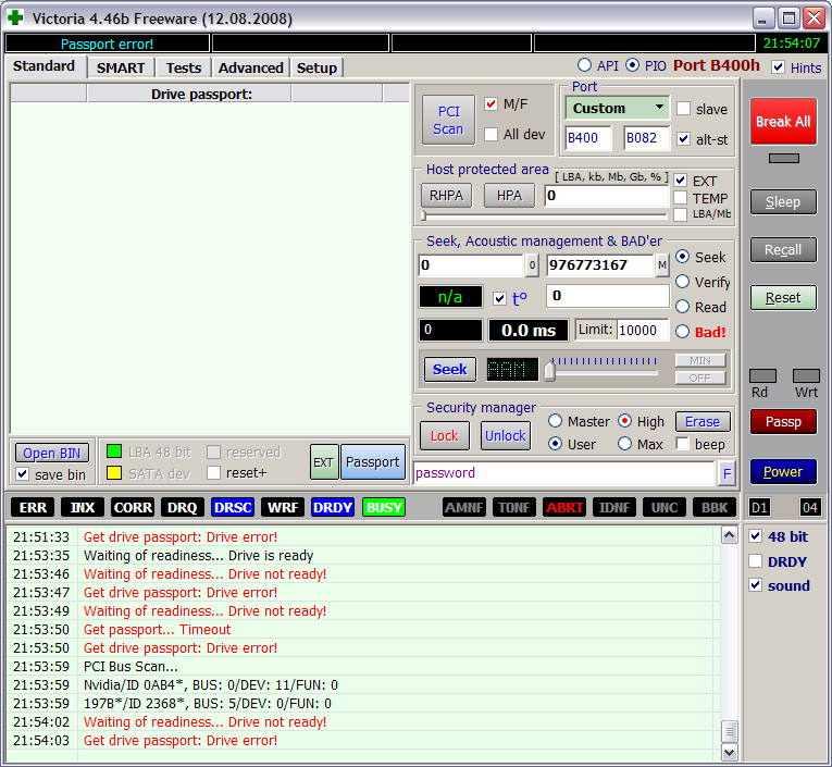

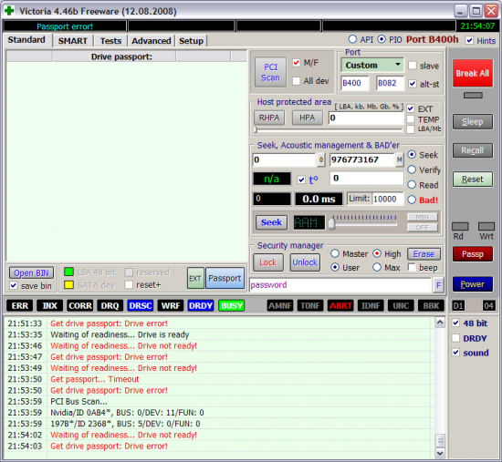

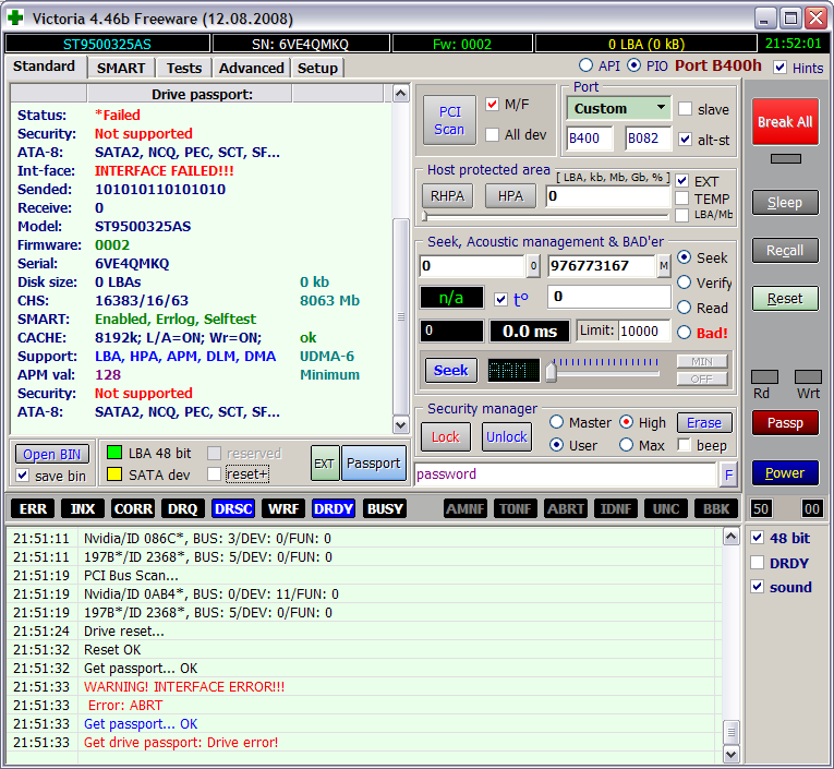

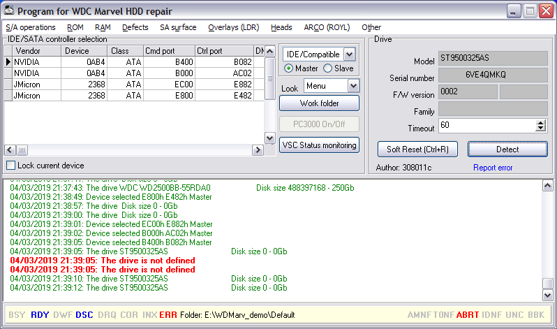

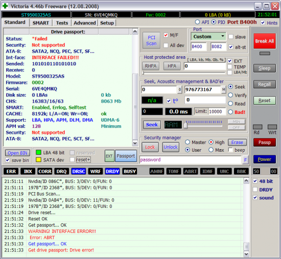

PostPosted: March 4th, 2019, 20:32
Posts: 309
Location: France

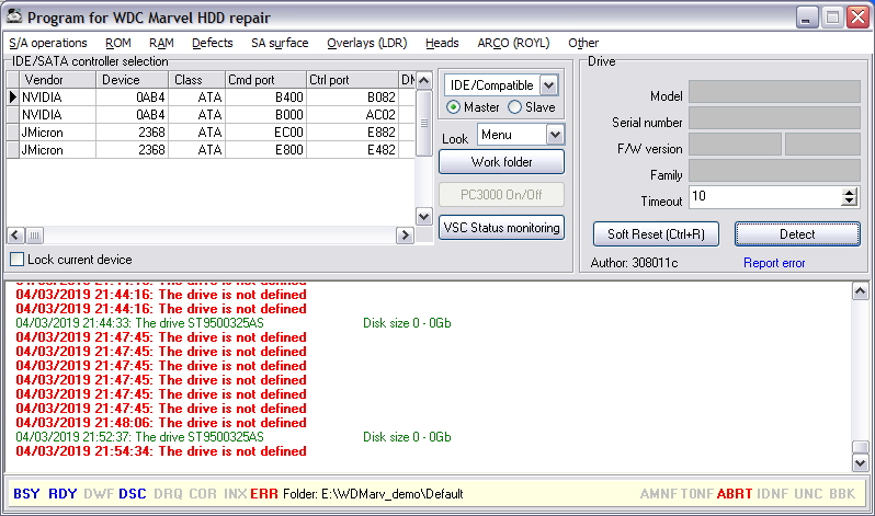

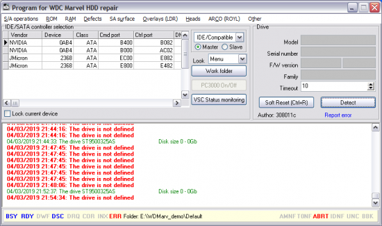

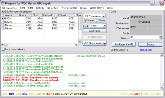

So, today I made a fresh Windows XP install, in SATA mode (the original install on my former computer was made in RAID mode, which probably explains why I didn't get the expected results – I had tried with Hiren's boot DVD, didn't work, turned out that the DVD drive is probably defective), and made some more tests with Victoria and WD Marvel Demo :
– I first plugged a known working complete 3.5" HDD, at first it showed nothing, but after some tinkering both tools displayed the correct model on the first channel.
– Then I plugged a PCB from a known working 2.5" HDD on the same cable, both tools displayed the correct model on the same channel.
– Then I plugged the PCB from the non working 2.5" drive on the same cable : both tools can't detect it.
I switched between the Seagate and the Hitachi PCB 2-3 times with the same outcome, so it confirms that the latter is indeed gone.
Victoria - fonctionne en cochant M-F et décochant reset+, carte du ST9500325AS correctement identifiée.png
Victoria - fonctionne en cochant M-F et décochant reset+, carte du ST9500325AS correctement identifiée.png [ 97.76 KiB | Viewed 23608 times ]
Victoria - carte Hitachi 5K320-250 non identifiée.png [ 77.12 KiB | Viewed 23608 times ]
WDC Marvel - carte du ST9500325AS correctement identifiée.png [ 29.8 KiB | Viewed 23608 times ]
WDC Marvel - carte Hitachi 5K320-250 non identifiée.png [ 29.09 KiB | Viewed 23608 times ]
Now, what are my options ? If there's a slight chance of bridging a failed component (from what you said earlier it's unlikely with this brand but it's still worth a shot), how can I pinpoint the culprit ? If not, are there PCB resellers proposing to perform the ROM chip swap, and how much would they charge ? Or would it be wiser to just purchase a replacement PCB and find an experienced PCB repair technician locally ? Would someone please confirm that the ROM chip is the one located at the bottom of the board, near the “U6” marking ?
Thanks again.

Anyone ?... :cry:
PostPosted: March 7th, 2019, 12:04
Posts: 309
Location: France
I'm gonna have to ask again :
– Generally speaking, what would be the recommended course of action in such a situation, to solve the issue at a “reasonable” cost ?
– In any case, I'll need a new PCB, so how specific must the matching be for that particular drive ? Is it likely to work if I just buy a drive of the same model on second-hand market ? Or is it preferable to buy from a specialized PCB reseller ?
– What are the recommended places to purchase HDD PCBs in Europe ?
– Can the PCB seller perform the required ROM chip transfert ? at what cost on average ?
– Or, if I just get a replacement PCB, what component(s) should be transferred from the defective one ? (See below.)
– What are the odds that the operation fails anyway ?
@Spildit – you wrote earlier :
Could you (or anyone) be more specific, and point to which component(s) you're mentioning on the PCB's pictures ? In what circumstances can the code on the chip be corrupted ? When that code is corrupted, is it game over ?
Thanks...
PostPosted: March 7th, 2019, 19:22
Posts: 17230
Can you retake the voltage measurements, this time with the black probe on a ground point?
PostPosted: April 13th, 2019, 16:15
Posts: 309
Location: France
@fzabkar
Sorry for the delay, other stuff to deal with at that time period, kinda overwhelmed on the outside and underwhelmed on the inside, as often...
Well, if I'm doing this right this time:
– +5V : 4.99V
– +5V fused : 0.00V
– Va, Vb, Vcore : 0.00V
What would be the normal values ? Are these measurements consistent with a particular type of failed component ?
And going back to the 2nd post from “mhp666” :
– in F1 I get 4.99V on the side of the “F1” marking, but 0.00V on the opposite side
– in D1 I get 0.00V on both sides
Does that mean that the F1 fuse is burned ? Would it be worth trying to replace it / bridge it, hoping that it works long enough to image the drive ? Or is it too risky to even attempt this ? According to “Spildit” it never works on Hitachi drives, does that mean that the PCB fails again right away and no actual recovery can be done ?
@Spildit
Send the drive to a reputable data recovery firm or browse for PCB re-sellers that do sell PCBs and offer free adaptation service / move NVRam to new PCB. This option will not work if the drive does have other problems to add to the "possible" PCB problem ...
I was hoping that someone here could recommand a known reputable PCB re-seller (preferably in mainland Europe) that does offer that service (or propose it as a “reasonably” priced option), since browsing can lead to shady places, and if I have to send the damaged PCB, I only have one shot...
From the results of my tests, I think that the PCB problem is certain, not just "possible" – don't you agree ? And as I said there was absolutely no sign of impending failure before this happened – but I'm aware that whatever caused that issue may have also damaged internal components. In which case I'll have to use that old backup and rebuild the rest with what's been saved, not ideal but way better than nothing... (Paying for a full-blown data recovery job, beyond the fact that I definitely couldn't afford it right now, wouldn't be worth the ~5% of non backed up data on that drive.)
PostPosted: April 13th, 2019, 18:47
Posts: 17230
The fuse is open, possibly because the diode is shorted. Measure the resistance of the diode.
PostPosted: April 14th, 2019, 15:09
Posts: 309
Location: France
With no current, if the multimeter is set to Ohm / 200, I get 130.0 to 130.4. If set to Ohm / 2000, I get 165 to 168. If set to Ohm / 20k, I get 0.42. Seems weird. Measuring again a few minutes later, now I get about 124.0 / 158 / 0.39... then a bit later, ~118.0 / 150 / 0.37... :shock:
What would be the expected value ?
I still don't know for sure if the ROM chip is the one in U6.
PostPosted: April 14th, 2019, 18:13
Posts: 17230
The diode is probably OK. Can you measure the resistances between ground and each of Va, Vb, and Vcore?
I suspect that U6 is the NVRAM. The unpopulated location at U3 is probably reserved for the ROM, so this would suggest that the ROM code is embedded within the MCU. Can you tell us the markings on U6?
PostPosted: April 14th, 2019, 20:53
Posts: 309
Location: France
Wasn't that established based on the fact that plugging the drive internally did not cause the PSU to shutdown ?
(By the way, is this rule also true when plugging the drive through a USB adaptor ? Does a shorted diode shut down the adaptor's power supply ?)
With the multimeter set to Ohm / 2000 : Va = 1152-1153 / Vcore = 325-355 (again it seems to be going down with each subsequent measurement) / Vb = “1 ”, but 10.68 if set to Ohm / 20k -- that would mean 10680 Ohms, right ? (as it may be quite apparent I barely know what I'm doing here ! :) I'm almost completely illiterate on the purely electronic side of HDD related things...)
I suspect... is probably... this would suggest...
So it's not even something standard and easily recognized with a bit of experience ? You have to do the guesswork for every single drive model ? :shock:
Which would mean that dumping the code with advanced software tools is required, right ? But is that even possible if the PCB doesn't register any status, as per the tests I made with Victoria / WDC Marvel ?
Very small and hard to read, but most likely “C66WP / KB44” :
PostPosted: April 14th, 2019, 22:37
Posts: 17230
U6 is a 93C66 NVRAM. The ROM is embedded in the MCU. Therefore you would first need to find a replacement PCB with the same ROM firmware, and then transfer the NVRAM.
That said, there are no short circuits at your Vcore and Vio supplies, so it may be that the fuse is open circuit due to "fatigue" rather than an actual fault. You could try replacing the fuse, or bridging it (risky). Hopefully that's all that you need to do. Otherwise, try to find a PCB with matching firmware.
BTW, the reason that a shorted diode would not have shut down your PSU is that the open fuse disconnects the entire PCB, including the diode, from the supply.
