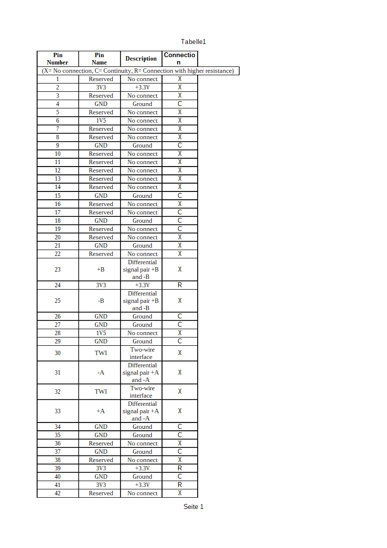

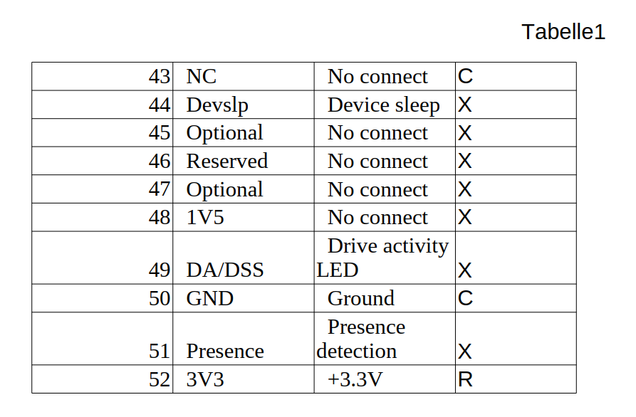

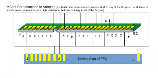

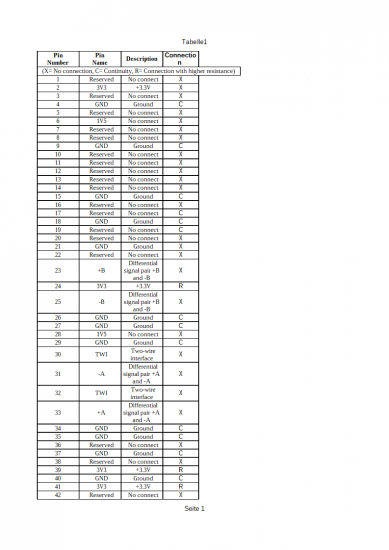

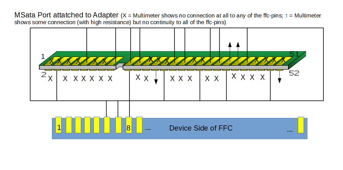

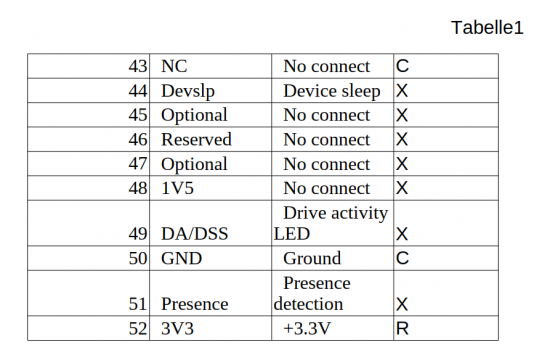

Hello again,
sorry it took longer, than I had planned. I have finally got results with the multimeter. And they are a bit suprising to me.
First of all: I didn't got kapton tape yet (as johnkeates has suggested), so I used insulating tape instead. I know this could be a source of error and I will try to get kapton tape in the next days.
How I worked: I used the multimeter to test continuity between the mSata-Port of the adapter and the device end of the ffc. I did check the connection of all 52 Pins of the msata port to the first 8 pins of the custom end of the ffc. The pins of the mSata-Port could be divided into 3 categories:
1: The Ground-Pins; they all (with one exception) have continuity to the same three pins.
2: The Pins, which deliver a voltage of 3.3V. They all (with one exception) have a connection with resistance over 50 ohm to all of the pins.
3: All other Pins (this includes Pins described as "no connect" and others, like signal pairs). They are almost all not connected to anything at all. Two of the "reserved" pins and one NC pinn are connected like the Ground-Pins, but the signal pins are all dead to every ffc-pin.
There could be measuring mistakes.
I hope this was understandable. I have attached an image which shows the connections and a list with the results.
I do not know much of the electronical processes in this kind of connection, but I guess, that the "signal"-pins having no connection mean, that it doesn't work.
As said above I will try and get kapton tape to see if the results are any different.

I was expecting that you would measure the resistances between each end of the 40-pin flex cable using the connector pins (laptop motherboard and adapter) as your test points. In this way we could determine whether the cable is making solid contact with each connector.

The FFC has the 40 pins only on one side. It is an Y-Cable with an bigger end to the mainboard and is also connected to the optical drive. That made me think I would not know which pins belong to each other. But I guess the wires can't cross inside a ffc, so that was a bit stupid. And at the adapter I used the mSata instead of the 40-Pin because it was easier to measure. Looking back this makes no sence at all :roll:
I will come back tomorrow with usefull results...
