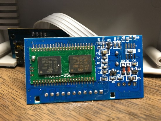

I have this little chinese NES knockoff which has built in games that aren't obviously the originals for copyright reasons. I am not asking anyone for help with anything illegal, rom related etc.
I am new to playing with flash memory at a hardware level, and I'd like to learn how to dump the contents of these chips. There are 2 on a controller board of some sort called "M400X2-256A". Ideally I'd like to access the filesystem and change files, look at them etc to learn about it.
I have experience microsoldering, have a microscope, hot air, oscilloscope etc, and some general electronics knowledge, but I will be the first to admit I have a lot to learn. Hence asking these questions. But to give you an idea what I can maybe pull off, is why I posted that info.
Anyway thanks for your time and consideration!

Could we see the PCB?
BTW, a better forum for this type of question would be EEVblog.com or a forum that discusses arcade games, etc.

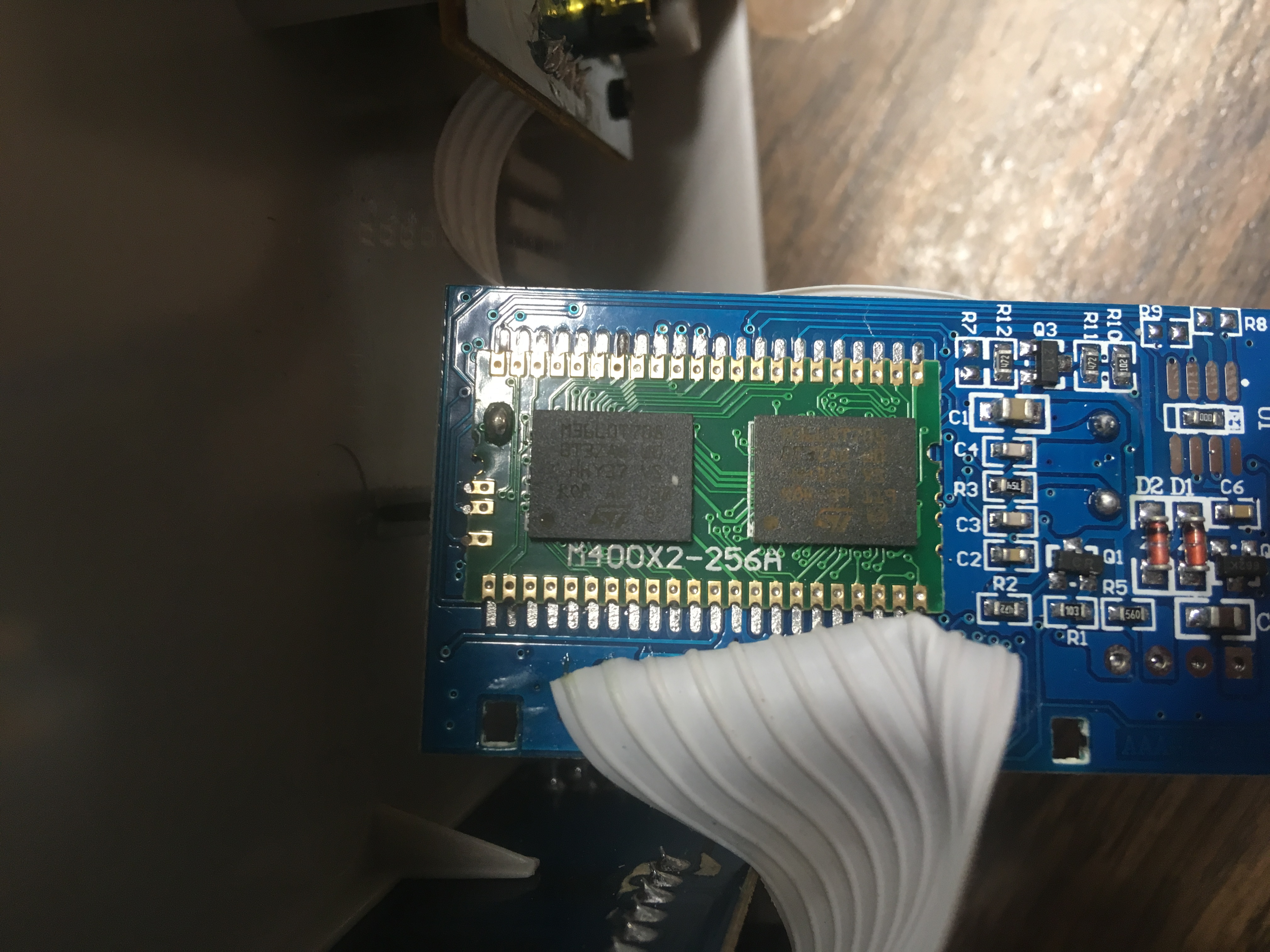

Here you go, let me know if you need a closeup of anything and I'll post it tomorrow when I get back to work.

The part number is M36L0T705 and the manufacturer is STMicroelectronics.
I can't find any reference to it, but in any case you may be better off determining the pinout of the 47-pin memory module and working with that. To this end you would need to identify the CPU and hope that its pinout is in the public domain.
FWIW, the M36L0T704 is a 16384 Kb "flash chip" used in the Siemens DreamTeam A31 phone:
http://forum.gsmhosting.com/vbb/f360/dreamteam-a31-flash-error-whats-wrong-343104/
 Post subject: Re: Accessing/Modifying/Dumping M36L0T05 Flash Contents
PostPosted: June 18th, 2019, 18:45
Posts: 17215
There is a Google search result which suggests that this chip may be a combination of 128MB SDRAM and 32M flash memory:
http://www.odysseyelectronics.net/gsitemap4316.html
ICM 128+32 FBGA88 M36L0T7050T · ICM 128M+64M FBGA88 M36L0T706
    M36L0T704 -> 128M SDRAM + 16M flash
    M36L0T705 -> 128M SDRAM + 32M flash
    M36L0T706 -> 128M SDRAM + 64M flash

https://datasheetspdf.com/pdf-file/673255/Numonyx/M36L0T7050T2/1
https://datasheetspdf.com/pdf-file/673253/STMicroelectronics/M36L0T7050T0/1
PostPosted: June 18th, 2019, 19:31
Posts: 17215
    M36L0T7040Tx -> 128M flash + 16M RAM
    M36L0T7050Tx -> 128M flash + 32M RAM
    M36L0T7060Tx -> 128M flash + 64M RAM

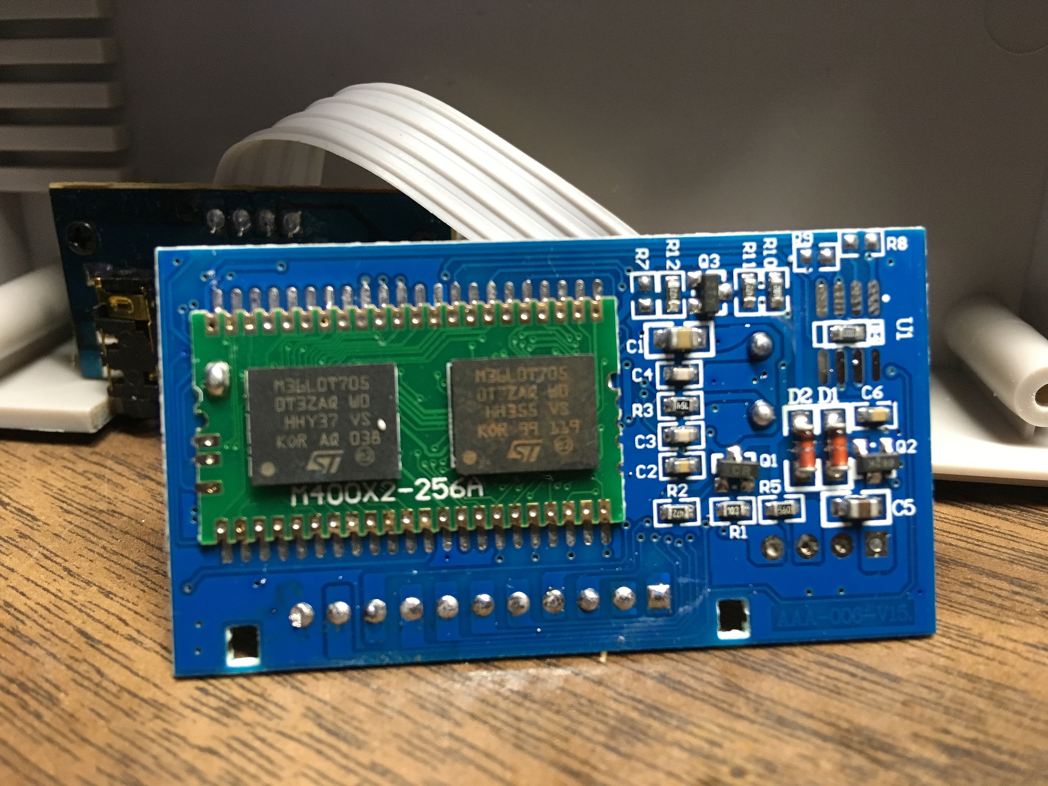

just having a very quick look at this thread at work, and chips with address pins A0 - A22 could be CFI (common Flash Interface). Devices that can read it are things like the FlashCAT USB https://www.embeddedcomputers.net/products/FlashcatUSB/
definitely not regular NAND flash.
Ive tried a few times to read a CFI but not had success yet, there is not a lot of info about it. And looking for any homebrew CFI readers has came up with nothing so far.
I would be interested in the device, and getting one to hack on when time permits, and link to the thing?
any chance of full pics of all PCBs?

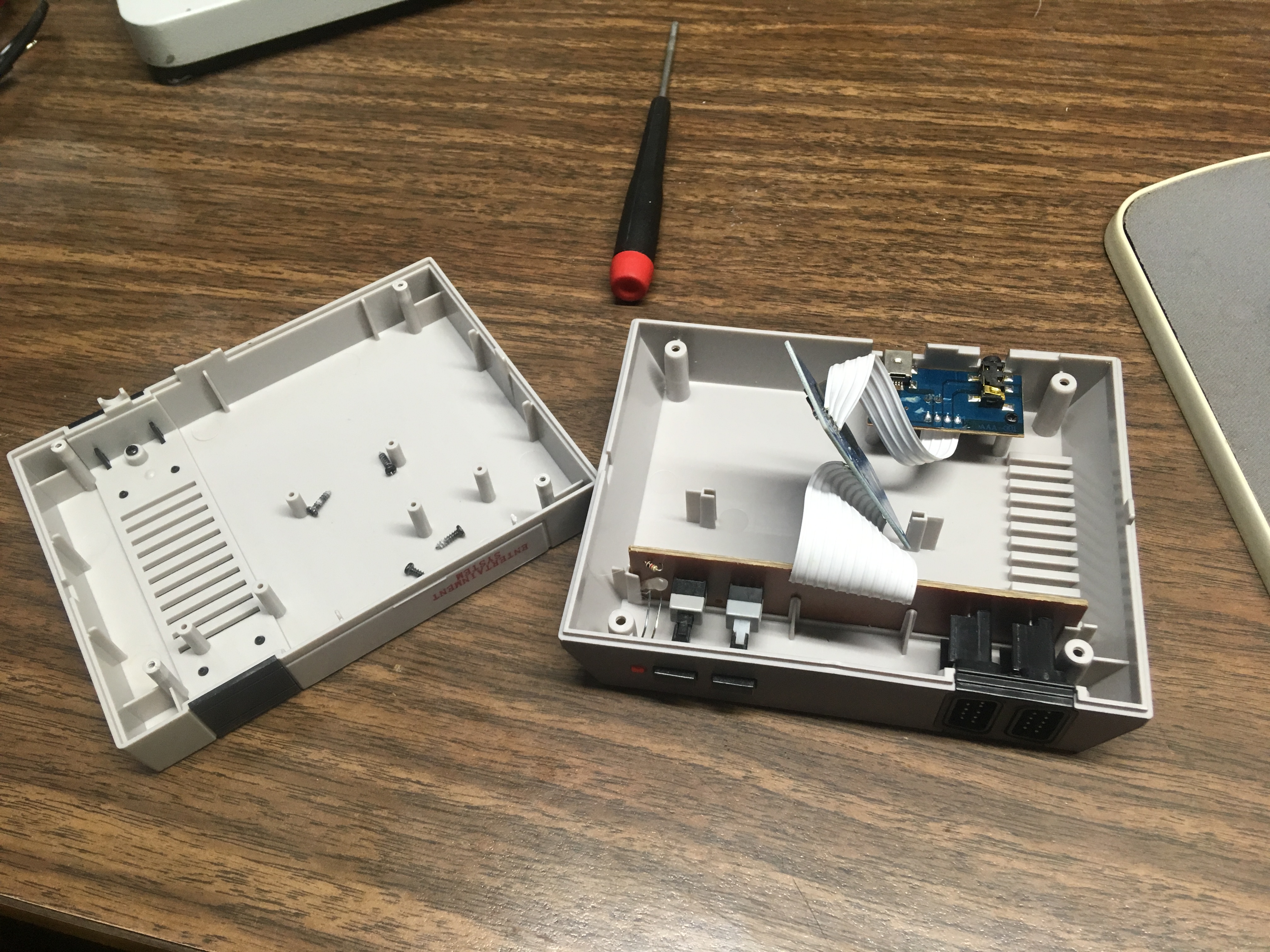

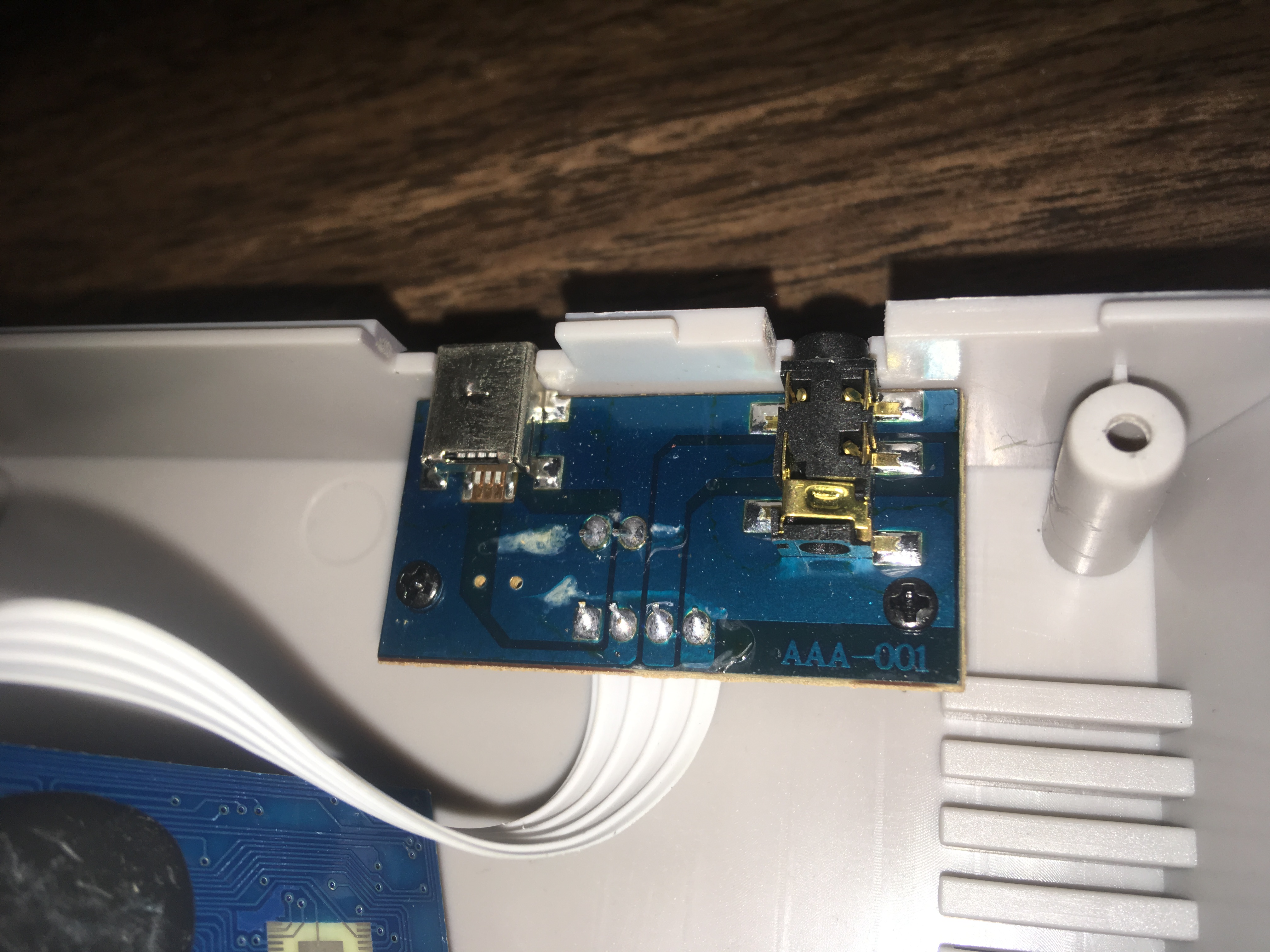

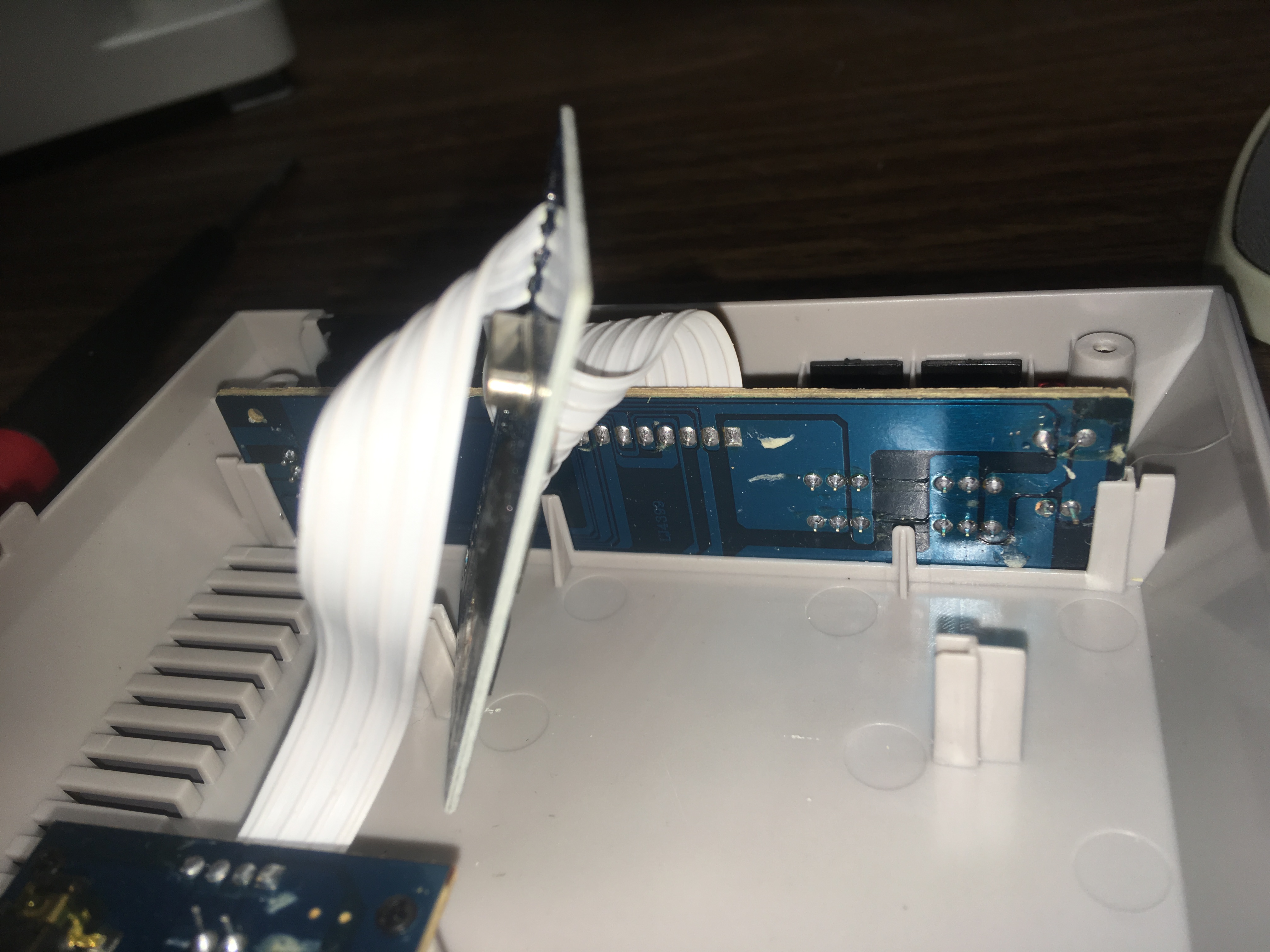

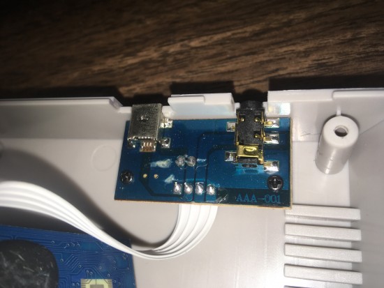

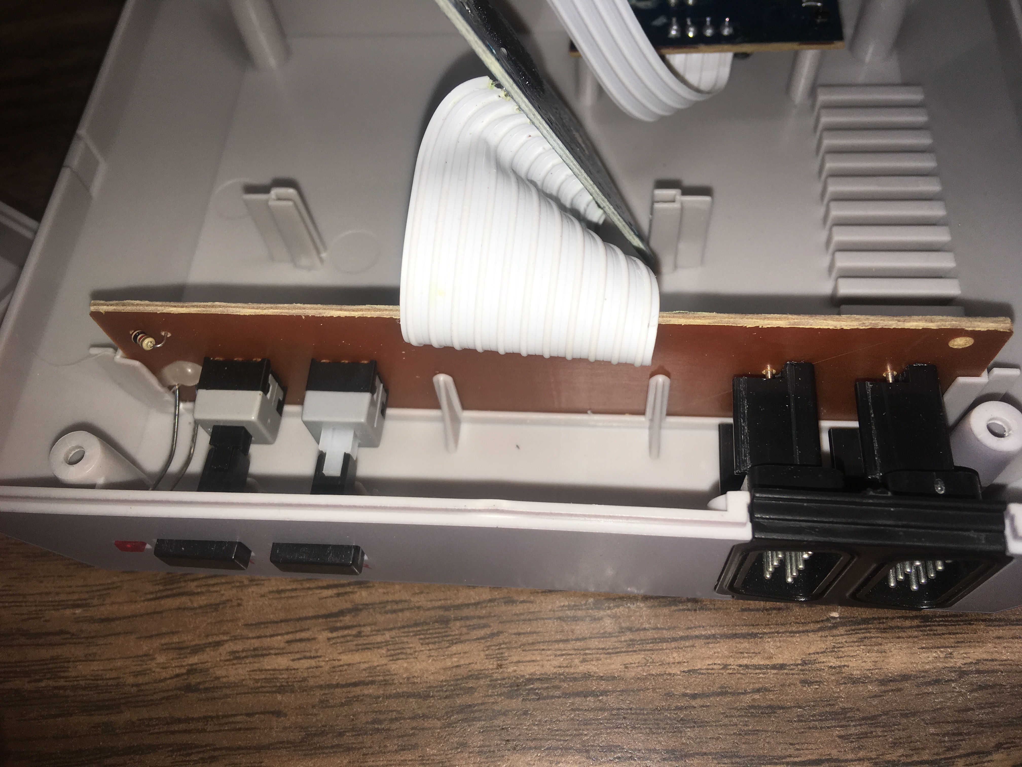

Here are pics of everything, and a link to the device (well nearly identical, the controllers are different.) I bought it from a wholesaler i deal with for $17.
https://www.amazon.ca/Handheld-Retro-Fa ... way&sr=8-4
File comment: Overview
File comment: usb dc in and headphone type RCA out
File comment: backside of controller input and power button/reset button board
File comment: front side of controllers/power/reset
File comment: back of the main board I first showed, im guessing the cpu is under the black hot snot?

I posted pictures of everything, and a link so you can see the product online. The message said awaiting approval though, probably due to the link? In the meantime you can search "620 games" on amazon and youll probably see it. just looks like an NES with 2 controllers, but tiny.
Sorry about the part number in the first post, you're right. It was an unfortunate typo.

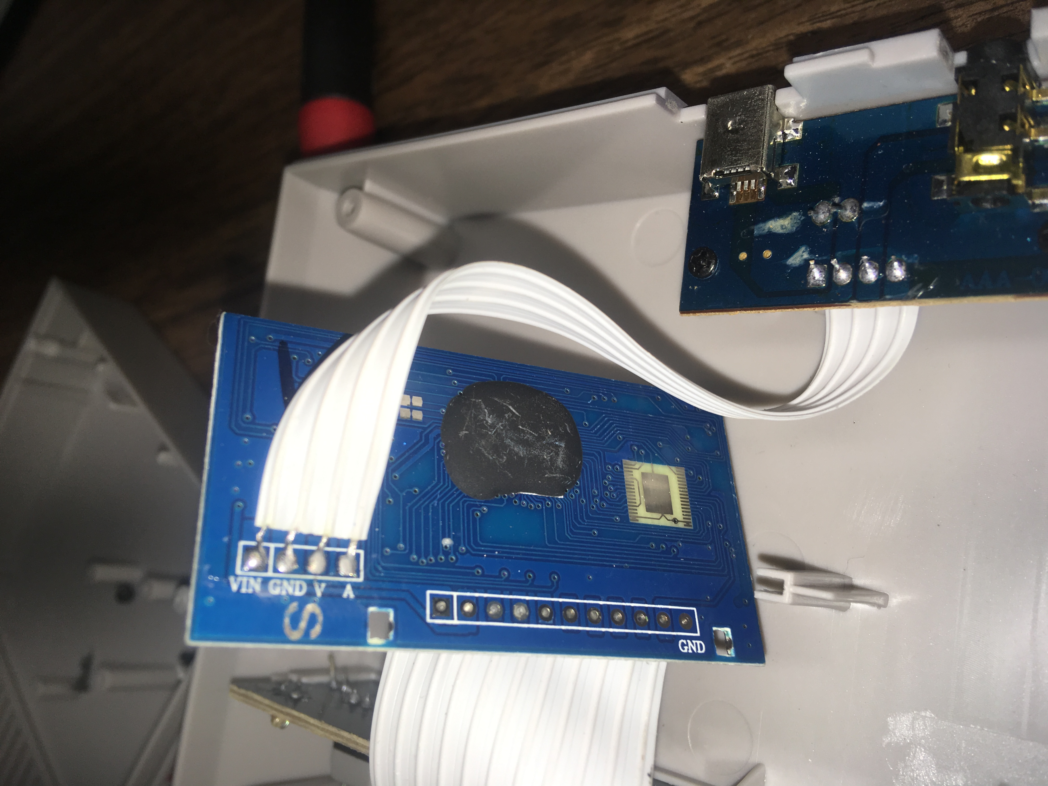

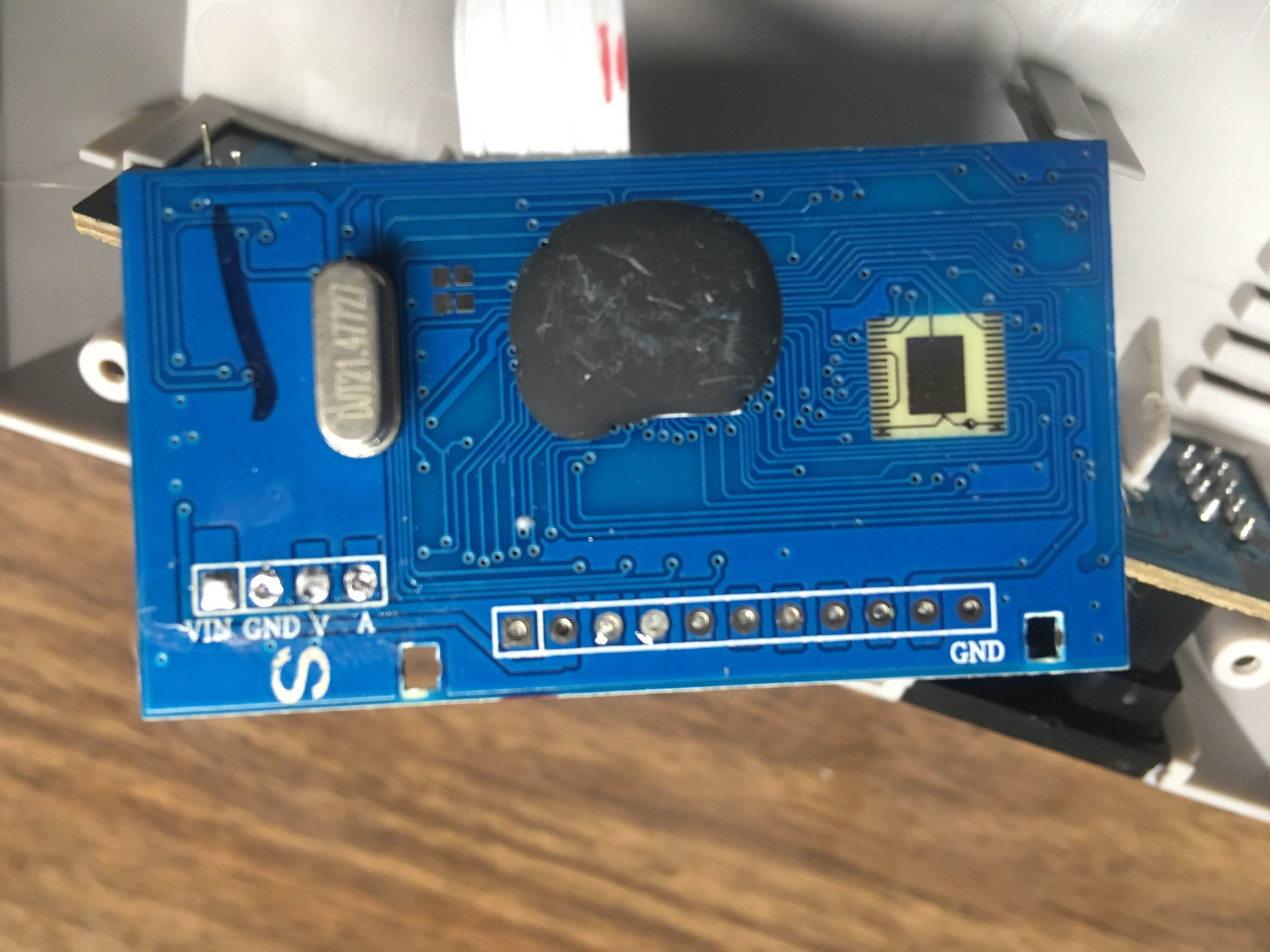

could you post top down pics of both sides of the board in the last photo showing the whole board, and cable out the way? I'm guessing this is the one with the memory board on it. I already suspected a blob controller. Shame I was right :(
PostPosted: June 20th, 2019, 9:07
Joined: June 18th, 2019, 17:36
Posts: 11
Location: hereandthere
Of course, here you go:
RE: the black snot on the processor, is there a good way to remove it besides hot air and pick at it? Is it worth trying?

Thanks a lot.

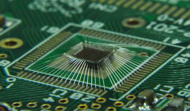

No there is no reason to remove the black crap, it is just there to protect the cpu or whatever is under there.
A method might be something like : http://travisgoodspeed.blogspot.com/2009/06/cold-labless-hno3-decapping-procedure.html
These are called COB for chip-on-board. Something like this:
if you need to hack it at that level, then it really starts to get interesting.
There may be other interfaces on the board, Serial port, JTAG etc.

Being not sure where to begin in cases like this where there is no clear serial port, JTAG or easily identified controller is normal, so currently you are on the right track!
As Franc said, not having access to CPU pinout or any markings does present a stumbling block. But what you do have is a nice open board with the ability to easily probe it and solder around if need be.
The 4 pads in between CPU and crystal Osc could be something, or could be nothing! interesting the crystal is same frequency as original NES, not a common part to find these days!
The memory board interests me, as it HAS to be a kind of drop-in part from somewhere that gets used on other devices or different variations of devices like this, otherwise they would just create a mainboard to hold the memory chips directly. Also, I am not sure of the age of this product, but the memory chip technology looks rather old. memory such as this was popular for things that used files/data straight off the chip, rather than something like NAND where it would be read from the chip but then converted straight to files or sent to RAM or needed to work through something like a flash controller (USB flash drives for example). common uses were early cell phone memory, bootloaders for embedded systems etc.
I seriously doubt any type of protection to hacking.
