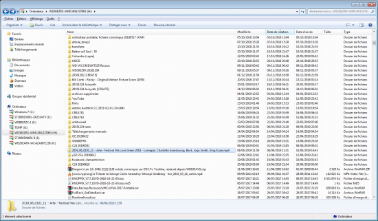

On one of my HDDs, a 3TB WD30EZRX, a MP4 video file inexplicably became a folder. It may or may not be related to errors found by CHKDSK a few days ago when I first noticed the issue :

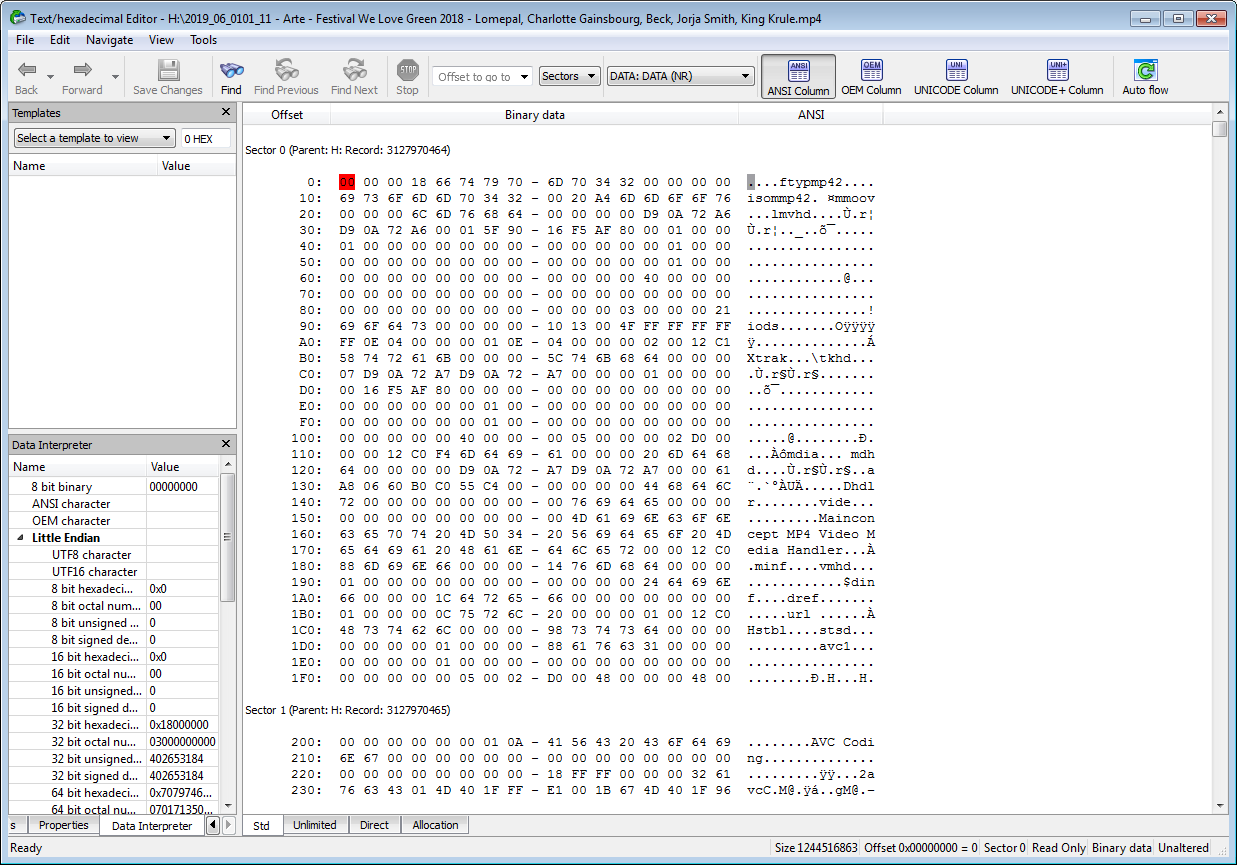

The MFT record for that file (obtained from DMDE) is number 620549, so it's not one of those which were fixed. If I open the partition in R-Studio, that file also appears as a folder, but if I open it with the Hex viewer, I can see the normal contents (valid MP4 header, correct size), however if I attempt to recover it, it is extracted as a folder (a regular folder with a size of 0 byte).

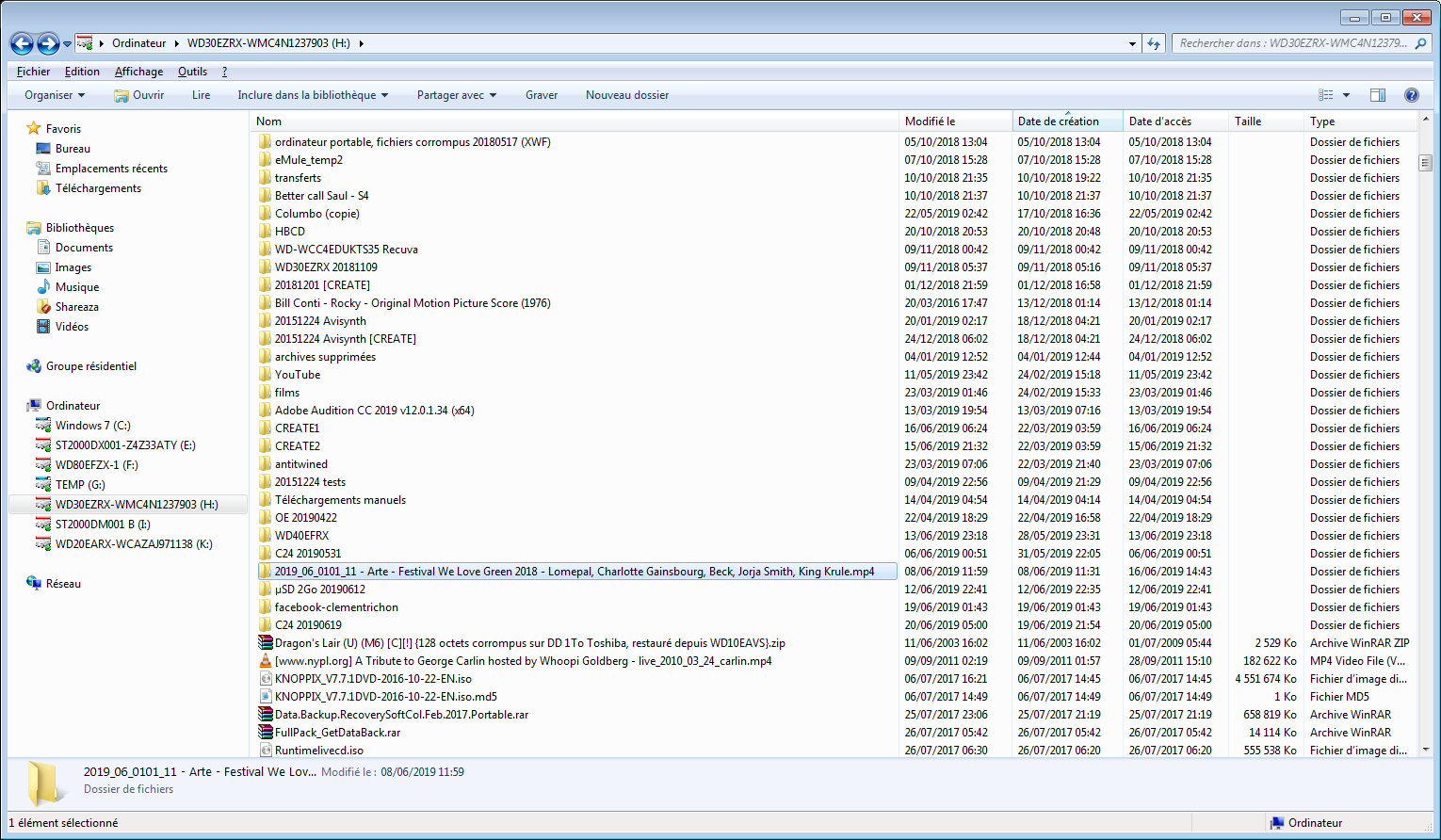

Otherwise, it behaves just like a folder : I can open a command prompt in it, copy it with Robocopy, even move a file inside...
First, how is that possible ? NTFS directory entries have a distinct structure, yet there is no warning that this one is abnormal.
Then, after the above CHKDSK analysis, a new analysis found nothing abnormal, despite this clear inconsistency.

And then the file was once again listed as a folder, and the 0x16 flag in the MFT record was back to 03 ! How can it be ? Where could there be a reference to that file, listed as a folder, which would explain why CHKDSK considers that it should be listed as such ? (I did the above twice with the same outcome.) And how can I fix it so that CHKDSK does no longer complain ? Could it be something in the directory entry where that file/folder is located (which is the root directory) ?

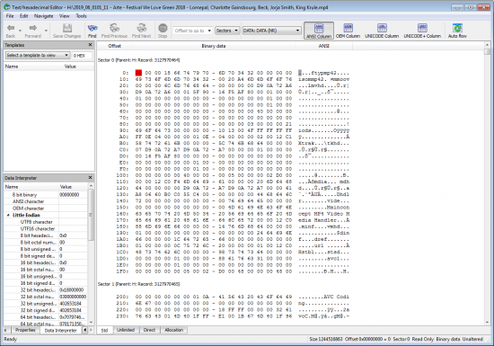

Just to make it clear : recovering the file is not the issue (as I could re-download it), I'm trying to understand what's going on, and improve my understanding of the NTFS filesystem.
2019_06_0101_11 - Arte - Festival We Love Green 2018 - Lomepal, Charlotte Gainsbourg, Beck, Jorja Smith, King Krule.mp4 -- explorateur.png
2019_06_0101_11 - Arte - Festival We Love Green 2018 - Lomepal, Charlotte Gainsbourg, Beck, Jorja Smith, King Krule.mp4 -- explorateur.png [ 149.45 KiB | Viewed 8958 times ]
2019_06_0101_11 - Arte - Festival We Love Green 2018 - Lomepal, Charlotte Gainsbourg, Beck, Jorja Smith, King Krule.mp4 -- R-Studio hexadecimal viewer.png
2019_06_0101_11 - Arte - Festival We Love Green 2018 - Lomepal, Charlotte Gainsbourg, Beck, Jorja Smith, King Krule.mp4 -- R-Studio hexadecimal viewer.png [ 96.75 KiB | Viewed 8958 times ]
