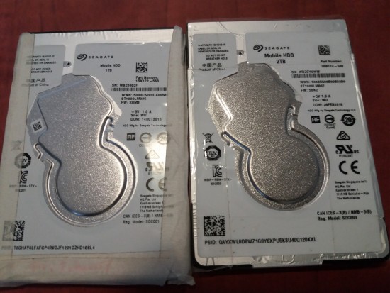

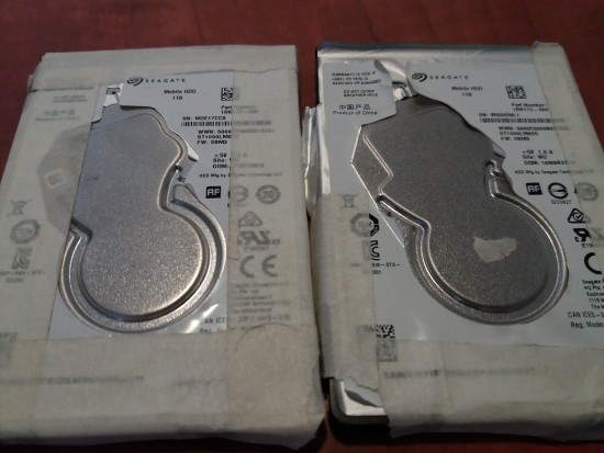

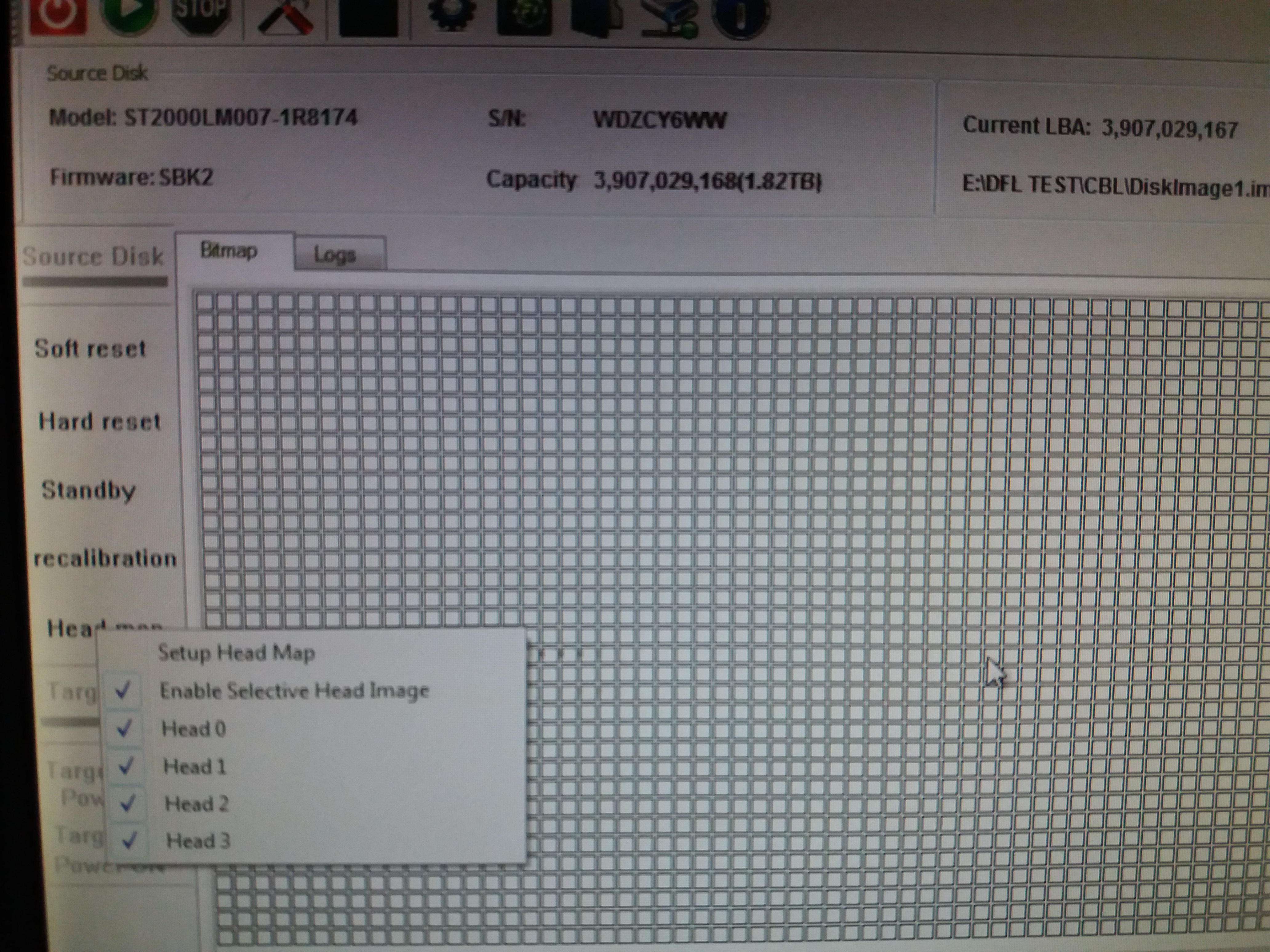

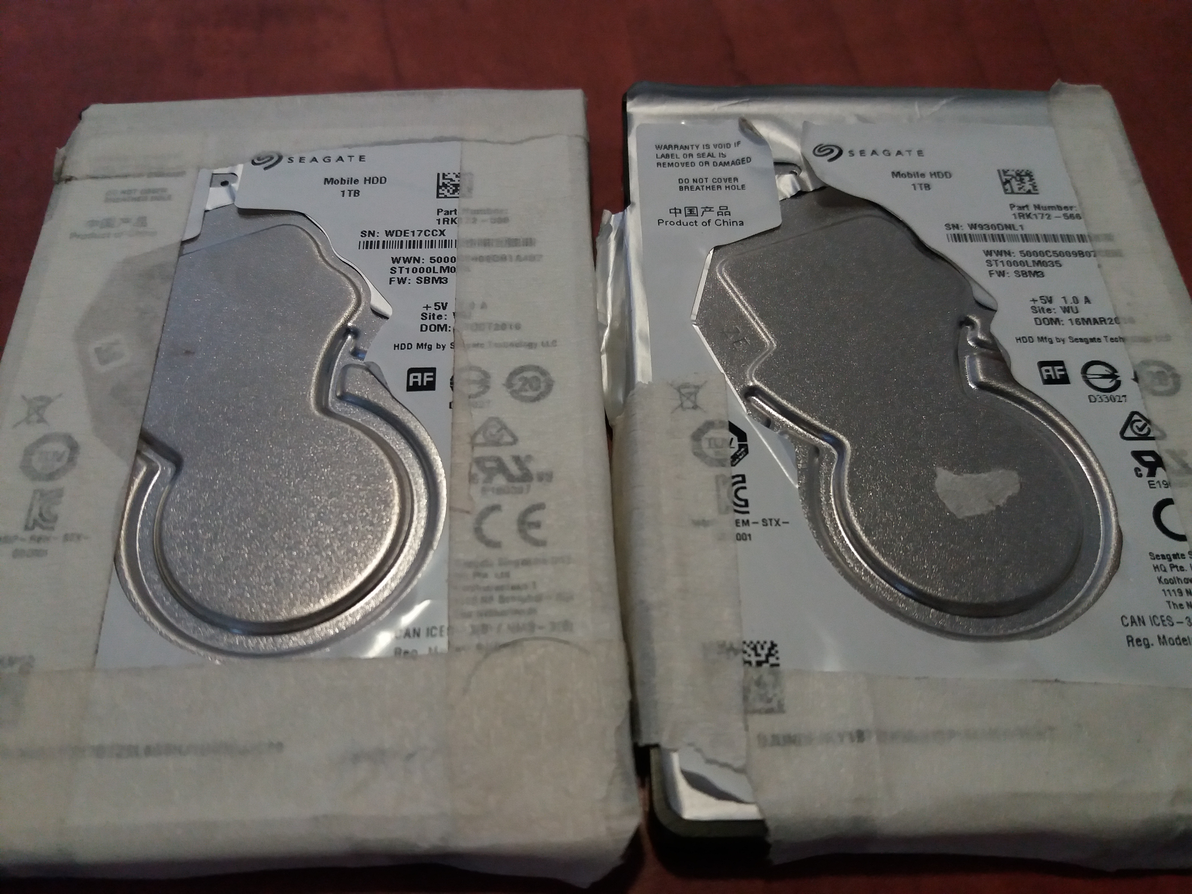

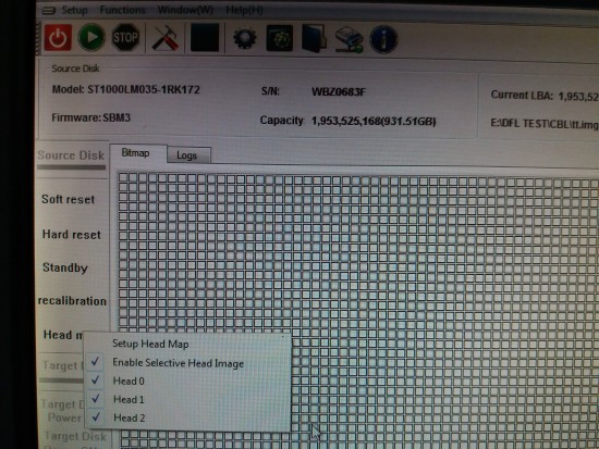

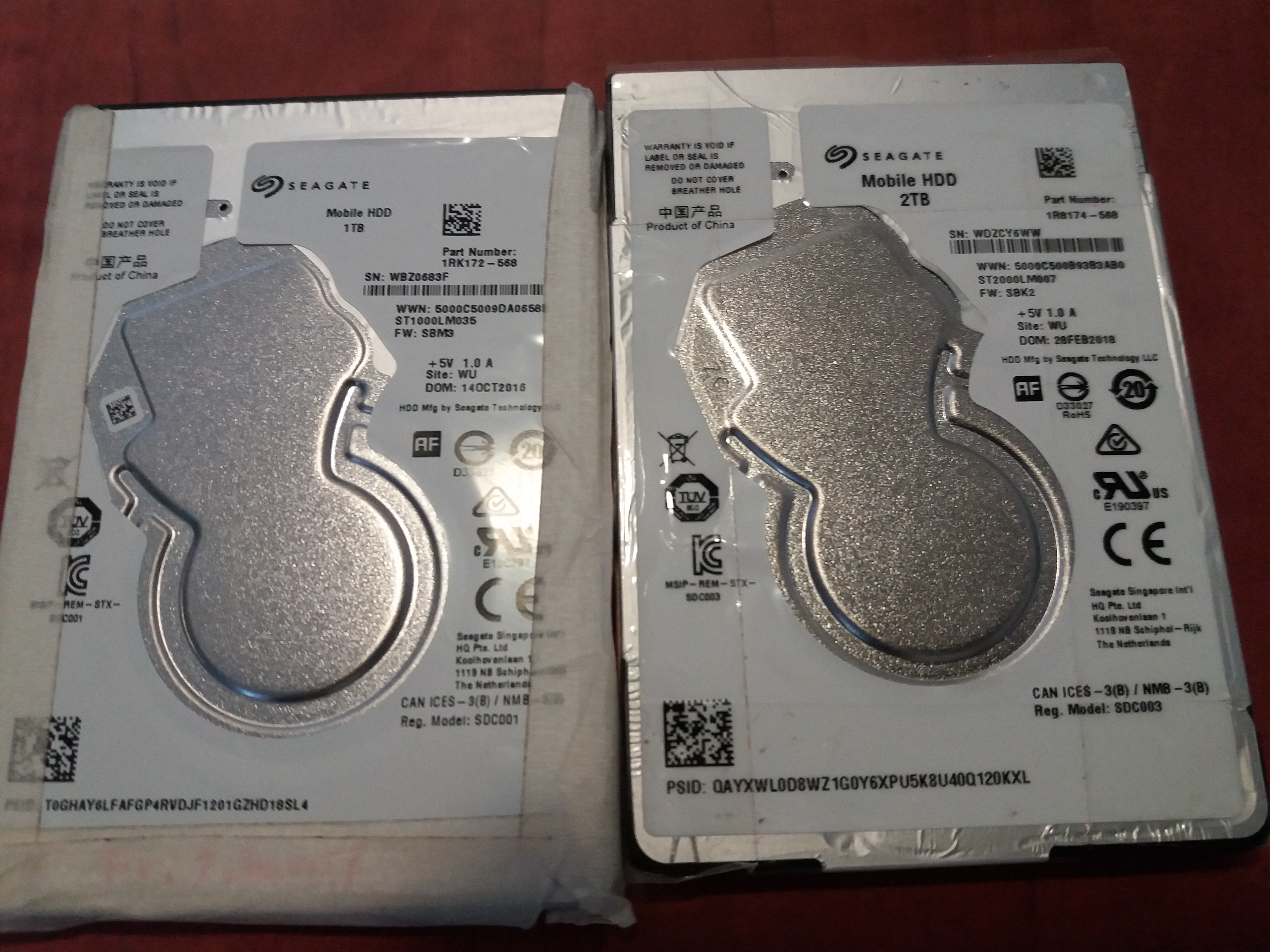

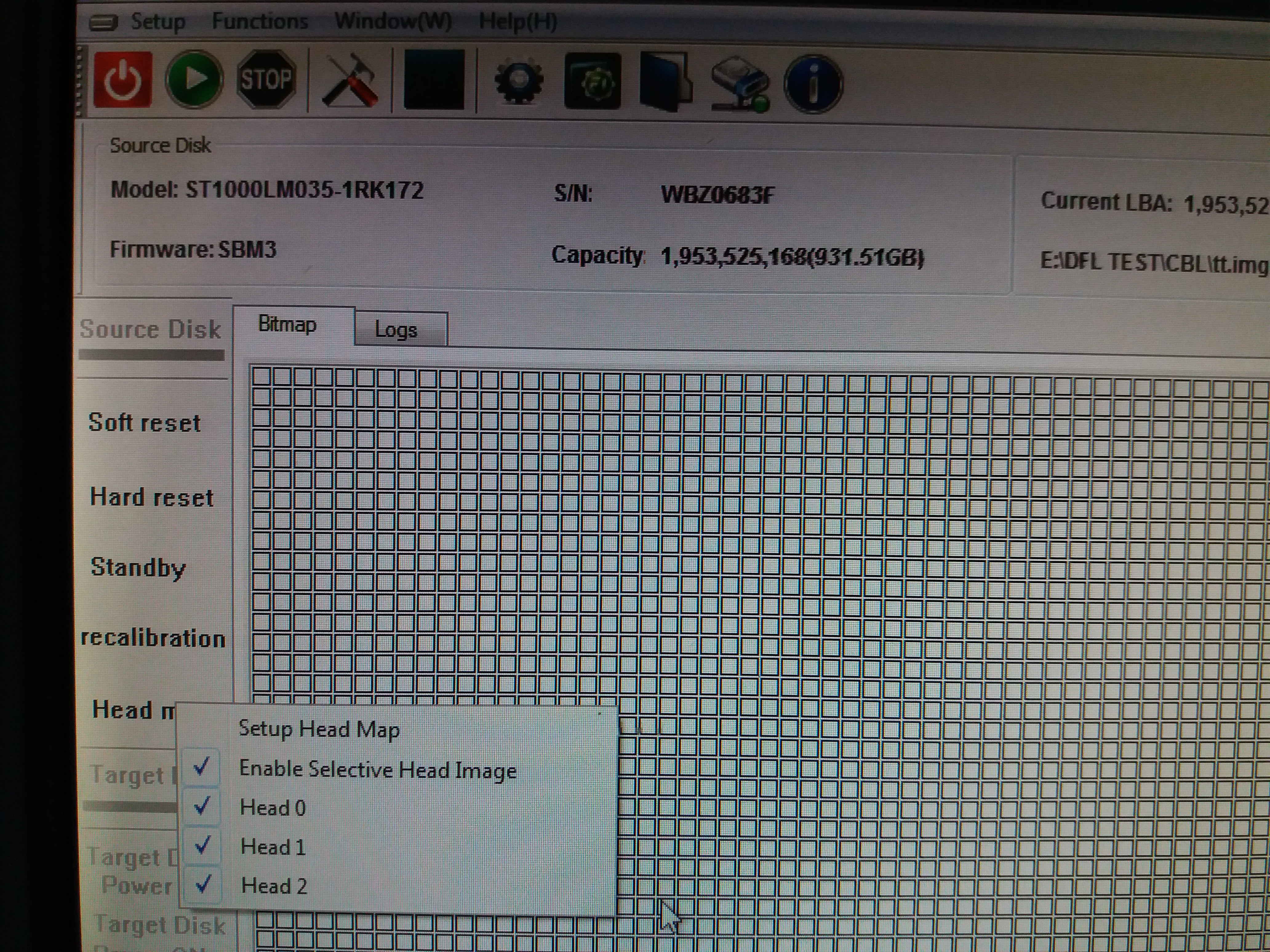

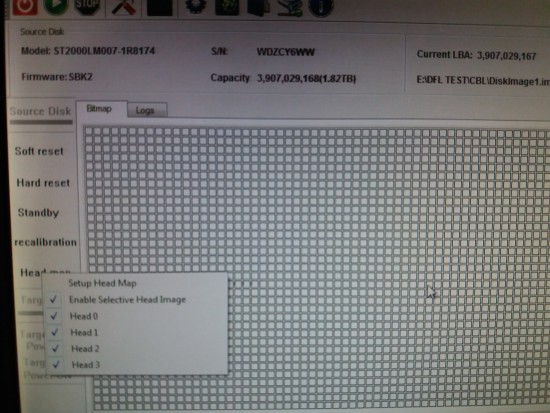

Joined: February 2nd, 2019, 1:21
Posts: 192
Location: Sri Lanka
hi friend Icoughey
i appriciate you great info on your forum. but sometime we can 100% judge about st1000lm hard drive.
according to your forum wbz has 2 heads. but i can show you wbz 3 heads hard drive.(physically 4).
this is 1tb hard drive(patient) i got 2 tb wdz hard for heads.
@magnet.
other set is successful head swapped case. deferant s/n

PostPosted: June 28th, 2019, 6:38
Can you read the specific family number for the 3 head model and the 4 head model? I have only recorded what I have found and verified, in the past week or two.

 Post subject: Re: donor for seagate st1000lm035
PostPosted: July 1st, 2019, 13:06
Posts: 192
Location: Sri Lanka
Rosewood A5
PostPosted: July 16th, 2019, 9:11
Dananjaya wrote:
Rosewood A5
Thanks, documented.
