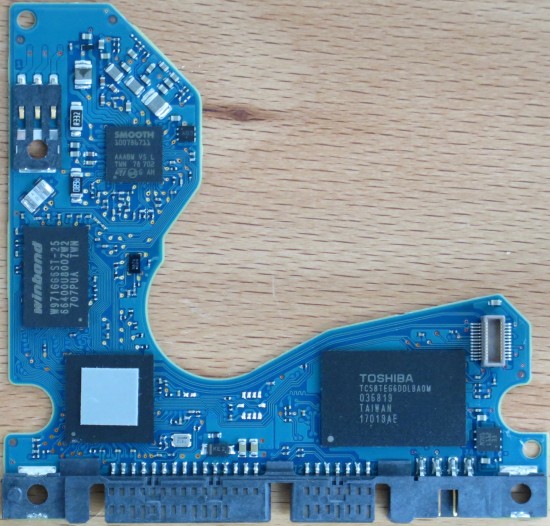

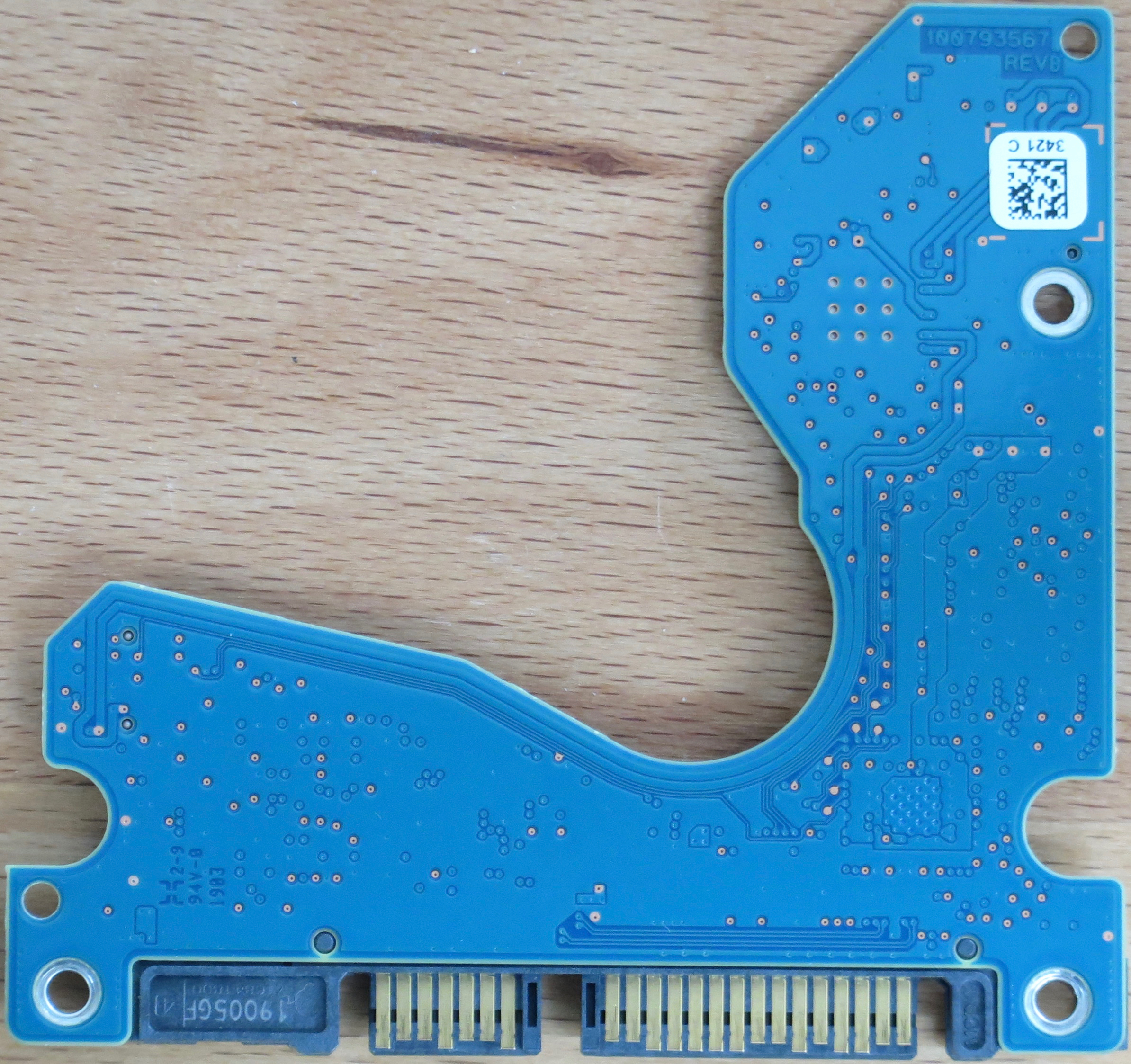

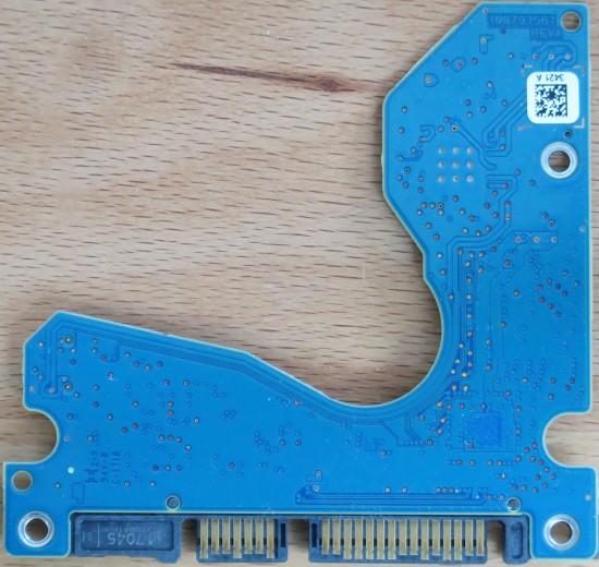

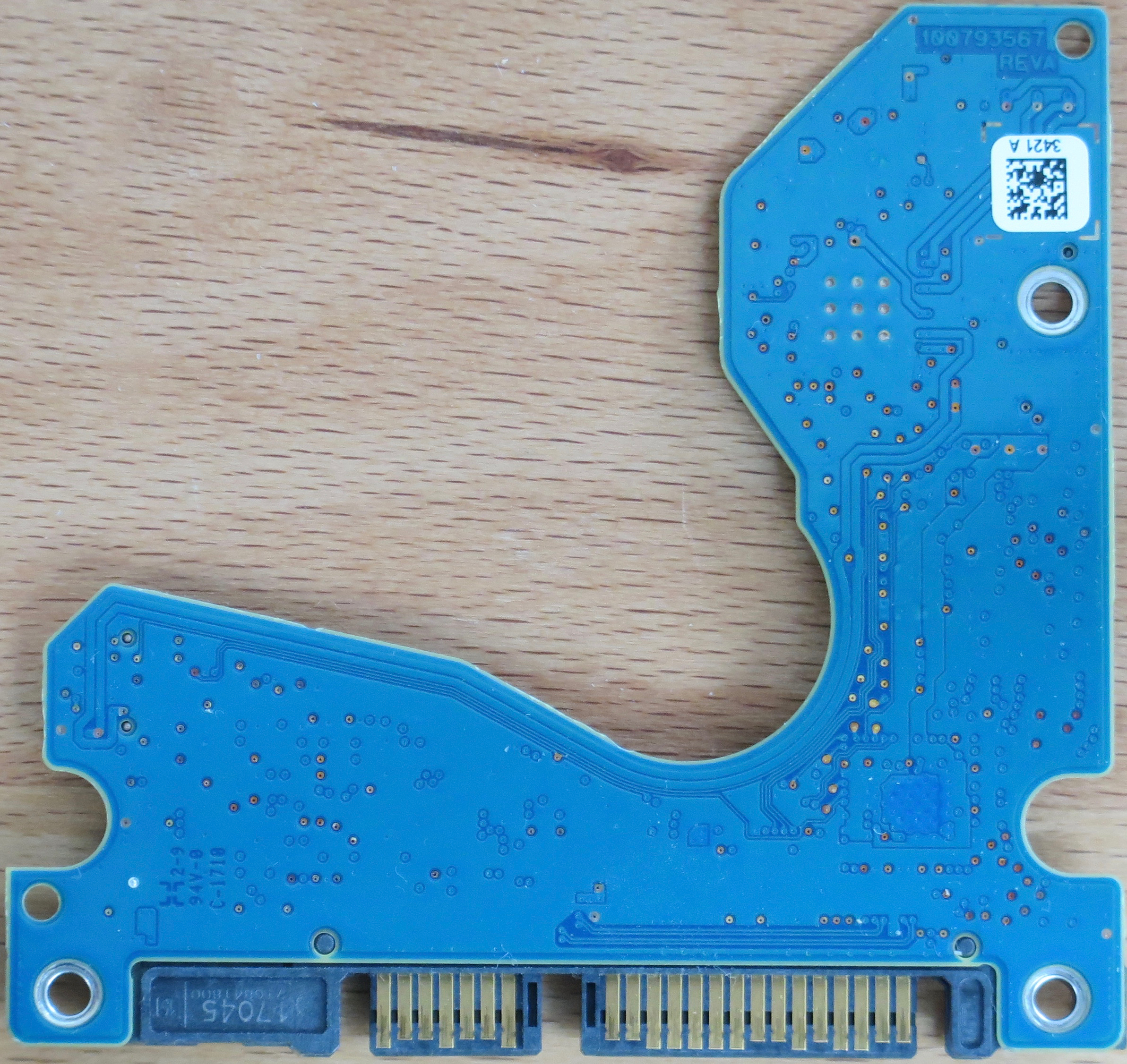

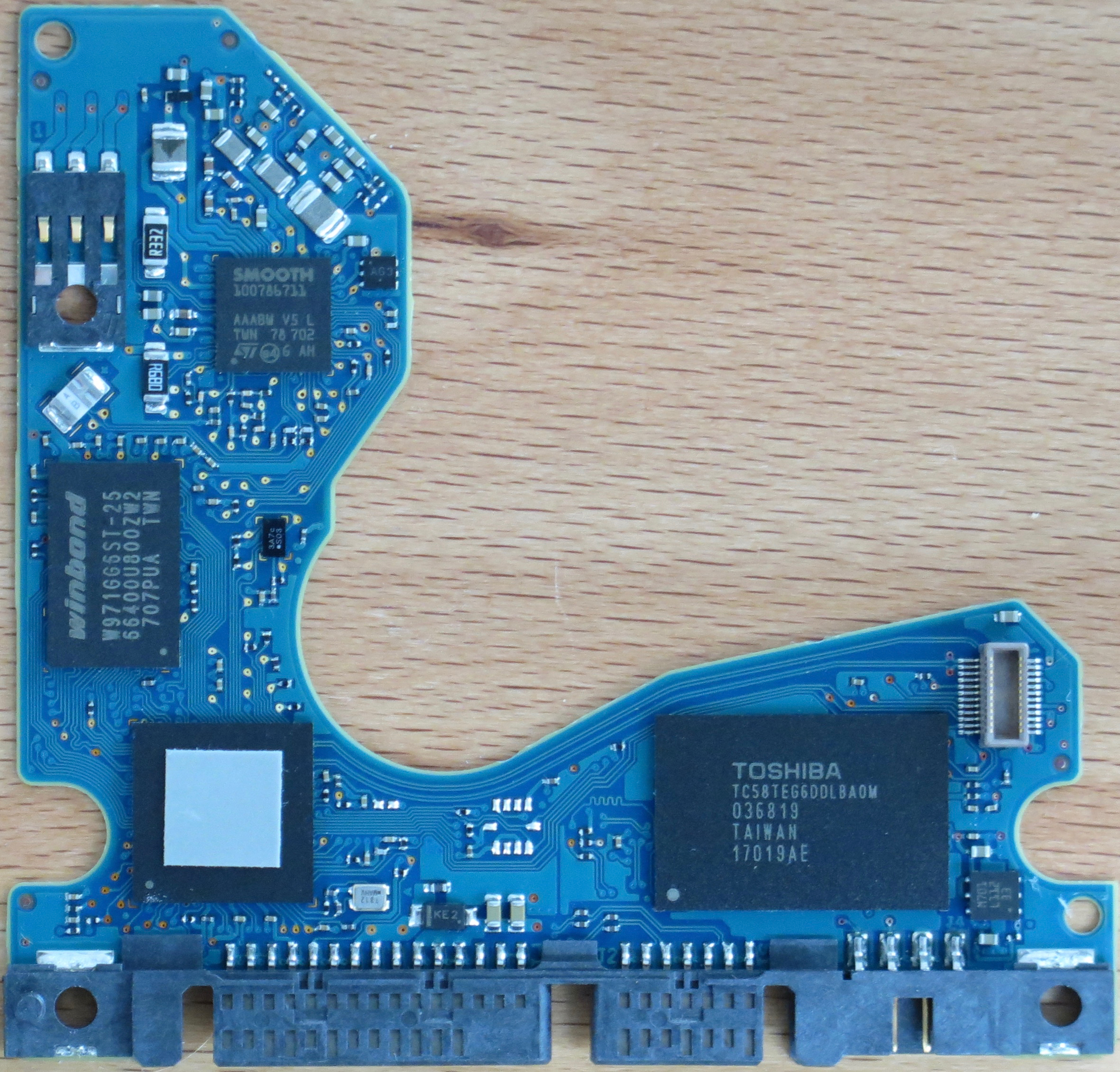

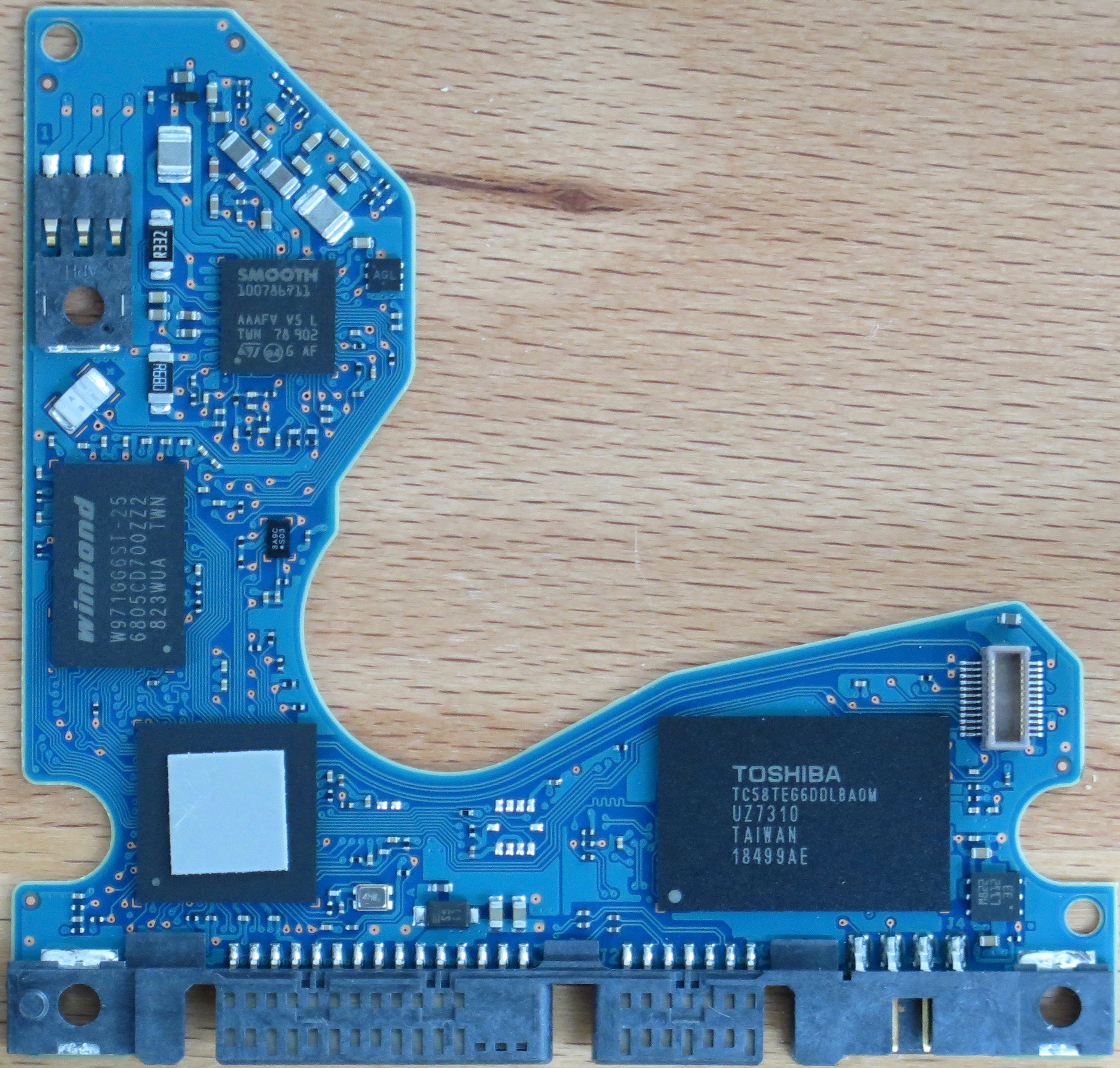

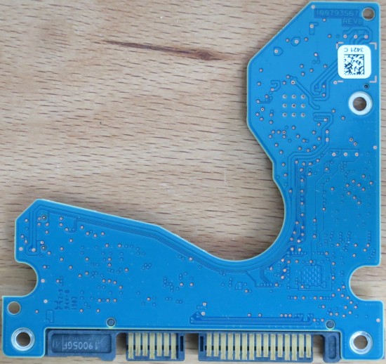

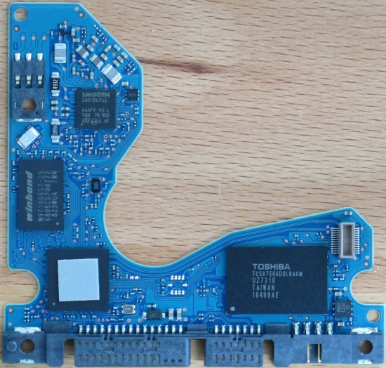

I have a 2TB SSHD that has failed after 1.5 years. Seagate wants $600+ to recover data. Can't afford that. Probably a lost cause for DIY with no special tools (i.e. no PC3000) but I'm fairly technical so I'll ask the experts here.
Background: drive gave no warning to failure; no power issues and no physical abuse - laptop hung during normal use and then drive would not spin up.
Removed the drive and installed in external case where drive appeared dead - no power indication. However, there is some life when connected to the diagnostic terminal port:
Boot 0x80M
           DensityList:0x0000
PrgF
LED:0x000000BD FAddr:0x000059D8
(1Ah)-Serial Port Not Ready
It just keeps printing the "LED..." refrain slowly over and over and reporting "Serial Port Not Ready" on Ctrl-z (or any input).
Purchased a second drive of same type but this "donor" is not identical PCB rev. Failed drive is Rev A and new donor drive is Rev B (see attached photos). I examined the new donor drive from the terminal and discovered that Seagate has locked the port. Not promising. Uncertain if this is also the case on the rev A drive purchased back in 2017.
Just for kicks, I tried to swap the PCB's (I know the ROM must match the platter specs). Here is the terminal session from that (i.e. donor PCB connected to platters from failed drive):

The last thing I can attempt on my own is to move the ROM from the failed drive to the donor PCB and see if the failed platters will then spin up and mount (joy). My question to you all is, what are the chances of this working? I'm not sure how the diagnostic port lock works - if it comes from the ROM, I suppose there may be a chance the old ROM did not have the lock set but I think I must assume I will not be able to issue terminal commands even after the swap due to the lock. So in that scenario, is it worth swapping the ROMS? I have access to a rework station but not sure it's worth the hassle if probability of success is low.
In any case, I hope the data I'm providing to others here will be of some use. BTW, I have examined both PCB's (front and back) and was not able to find any appreciable difference (by eye) to the traces on top and bottom nor the component fills. So the changes between revs must be very minor.
Thanks for your advice.

your chances for recovery are close to nil without extensive knowledge on the FW and some tool to unlock it...
no, because the problem (at least one of them) is in the NAND and it's logical, bringing new NAND on the new PCB(after swapping ROM chip) will bring lots of new problems, swapping the old NAND will leave the old problem unfixed.
no, there is no such chance
it is not, swapping ROMs won't fix the drive
Fixing this drive would require extensive knowledge of drive's FW and know-how. I fixed some of those, it's hard.

That's what I suspected. Although I had read in this forum of a success with a similar drive by performing a ROM swap and then a nand init. Of course, op had diagnostic port access in that case which allowed the nand to be initialized so that might be a problem for me. Here's a link to that post:
https://forum.hddguru.com/viewtopic.php?f=1&t=35895
Thanks for the advice.
edit: BTW - I should have mentioned in the original post that the platters from the failed drive don't spin when paired with the failed PCB but they do spin when paired with the donor PCB so that was a little encouraging. Just not enough to successfully complete the spin up sequence for the donor controller to be happy (the platters just continue to spin without achieving final spin up).
 Post subject: Re: Advice with ROM swap on 2T FireCuda SSHD ST2000LX001 ...
PostPosted: August 6th, 2019, 18:31
Posts: 3598
Location: Chicago
yes, because the problem is in the NAND and drive does not have a chance to spin up
yes, because donor's NAND does not have that problem
yeah, there is very big "not enough" thing that prevents drive from working

In a nutshell : you are trying to fix a drive ( without proper tools and knowledge ) that even some DR professionals ( with proper tools and knowledge ) can't.
If data is really important, stop what you are doing and seek for a professional help near you. ( and I believe they are a lot )

This is very helpful. On another forum, someone reported that these SSHD's are Rosewood drives and that not even PC3000 has diagnostic port unlock for this particular model of Rosewood (others, however, they do have). Can anyone confirm that for me?

I personally do not use pc3k unlock feature most of the times (use my own ways instead). Pc3k should be able to unlock it in theory, but the same mods alone they use on normal RW drives are not enough, so one might need other fixups to make it work.
Thanks.
I think there is no automatic unlock in PC3000 for this model right now but the drive can be unlocked in manual mode by AceLab tech support. However this particular drive won't be unlocked because it requires the drive to spin up and read FW from platters to complete the unlock procedure.
Right now there is no solution for this problem in PC3000, however if you are to submit your drive for recovery to Seagate they should have a solution, because they don't use PC3000 or other commercial tools for recovery.
If you looking for something cheaper that $600, you probably won't find it, $600 is already very cheap :)
