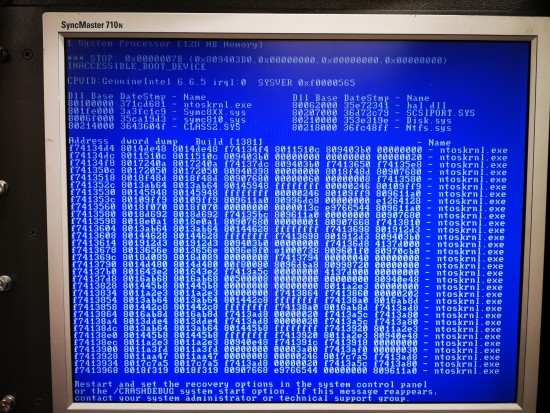

I tried to take a copy of a Scsi hard drive, which is used in a "homag" woodworking router. The router runs on Windows nt4. Would have been nice to have a copy in case of a hard drive failure.
I used HDD Raw Copy Tool to take an image of the machines hard drive. This was run on a Windows 10 pc with a Scsi card in a pci express slot.
I didnt do anything else for the drive than use it as a source for the image.
After the image creation was finished, i turned off the computer and put the scsi hdd back to the router machine.
To my surprise it gave an error i have never seen before, like the boot sector would be somehow screwn over.
The error it gives is attached as a picture in this message.
I have a windows nt cd, which belongs to this machine, but the machine is unable to boot to the cd. The bios is set to boot from cd.
All it does, says on the startup something like: "A bootable cd detected", but does not boot there, so i could try fixing the problem from there.
The router machines computer is an industrial pc called "Eltec eipc-2".
Any suggestions?
I find this weird as i only used the hdd to take the image, and pulled it back out. Can windows 10 somehow automatically go and screw up something?
If anyone knows how to fix such a thing i am willing to pay.
Thank you.
Arto Tuisku, Finland.
File comment: The blue screen error

Yes, Windows 10 can do that. Might be the MBR messed up, but also boot files (boot.ini). Something simple as a win98 boot diskette with Fdisk.exe (fdisk/mbr) may or may not fix it.
https://www.allbootdisks.com/download/98.html
Next thing is to check is if partition table looks ok and if there's an active partition set. The active partition should be the one containing NT's boot files (ntdetect, ntoskrl, boot.ini). And then boot.ini should point to partition containing the windows system folder.
But this is knowledge from a long time ago which ma or may not be correct.

Am I correct in assuming that the BSOD screen shows the router with only your HDD connected? If so, then it appears to have started booting from the HDD, but has subsequently encountered a disc error during the boot process.
Have you tried copying your disc image to a new drive and then booting from that?

does the PC have a PCI controller? did you put it back in the exact same location (same port, cable)?
if yes, try moving it, if no, try putting back exactly where it was.
is your SCSI termination correct? I have shivers remembering some of the hassles we had when SCSI CD burners came out, and the hodge-podge systems we built back then..ughh..

The partition table looks ok and the boot files are there. I will check where the boot.ini points.
There is also a cd drive and floppy drive connected. It seems to be booting on the hdd yes.
Yes i have tried to put the image on another hard disk, the result is the same.

I have tried putting it back to the same and to a different slot, with everything being exactly the same.
I have not changed anything that would have to do with scsi termination.
I assume if i could get this thing booting on the cd i could fix it. I even have a homag specific service cd which contains all the system needed for the machine, the cd is new. Any ideas on that? the cd drive was seemingly working, as it read files from a cd on a desktop environment. Tried it when was still able to get there :P.

Got the problem solved with a bit of luck.
Apparently win10 somehow installs the device for itself, making changes to the hdd.
The way it got solved i went in the Computer management->disk management->Right click the correct drive from list->properties->hardware-> choose the drive from list and click properties->Driver-> Uninstall device.
Than turn off the computer and plug the hdd out before rebooting, to avoid win 10 write stuff there again.
Must say i am relieved as this computer is running a vitally important machine for my company.
