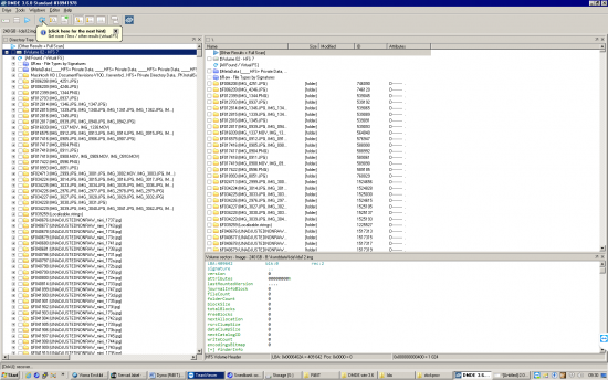

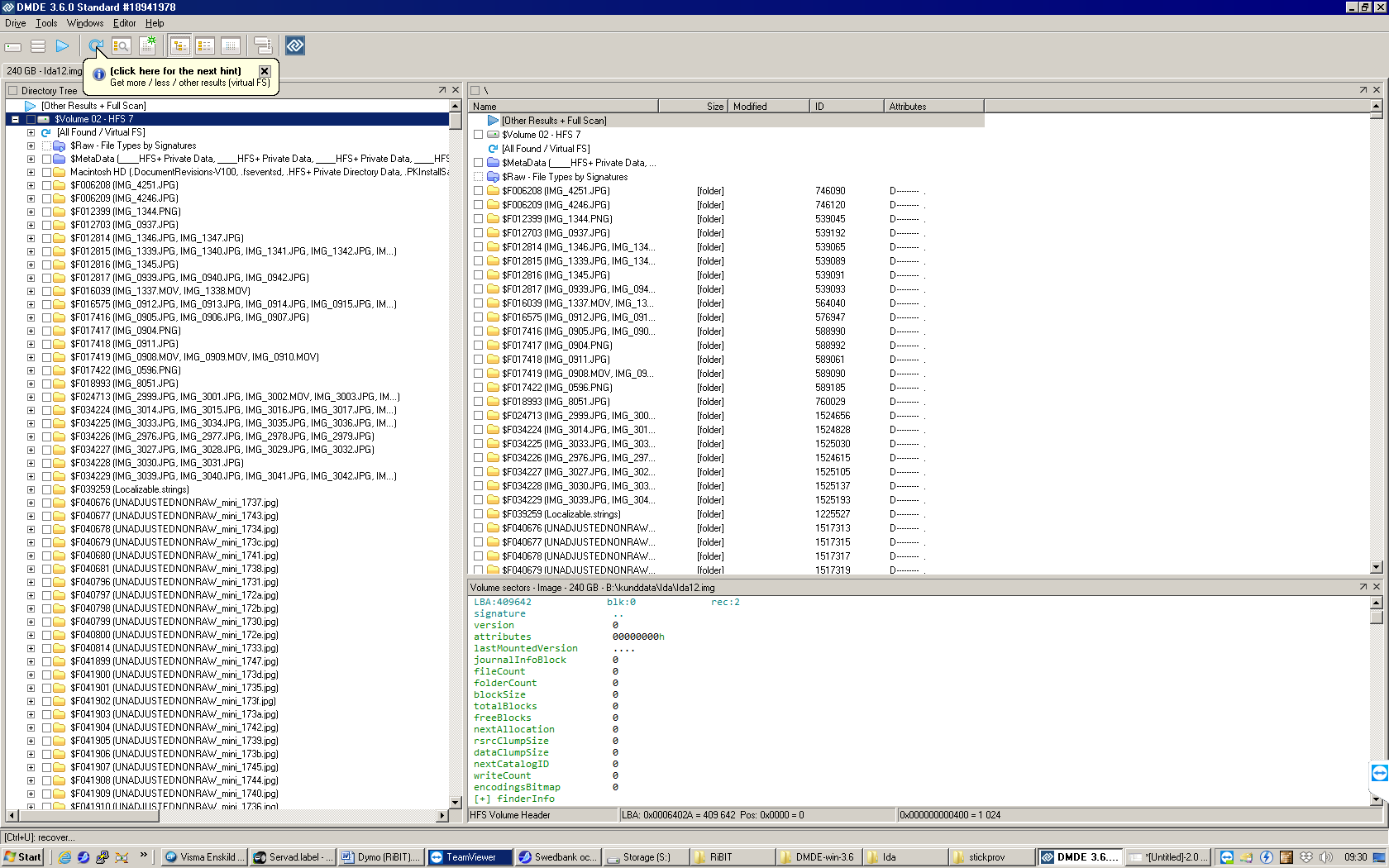

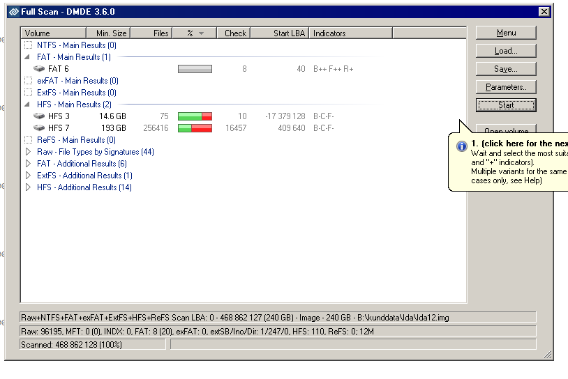

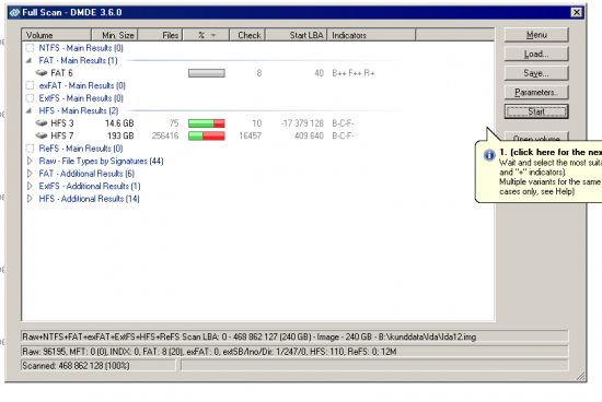

We got a 240GB SSD-drive from a waterdamaged MacBook (2010). The computer itself was full or rust and other kinds of corrosion, but somehow the drive managed to survive (corrosively speaking). I mirrored the drive (0 read errors) and launched DMDE to extract the contents, but alas it was not that simple. DMDE tells me that the filesystem is Unknown. Doing a raw scan I find a lot of jpegs and such, so the drive is not encrypted. I tried to do a HFS-rescan and it finds some fragments but not enough to rebuild the whole filesystem.
Is DMDE the culprit here, for not knowing how to handle this filesystem? What other tools can we try to rebuild the filesystem?
(It is cruical for the customer to get the full file hierarchy back. Carved photo files are useless for her, even if we manage to carve every single file out of the disk)

I have now tried R-Studio, DMDE, and hpfsrecovery and all give the same result: files can be rescued (some without correct names, most with), but the file structure cannot be rebuilt. Despite the drive giving no read errors when cloning it, somehow it seems that some data relevant to the file structures has gone FUBAR for reason unkown to us. Maybe some NAND-cells got killed because of the humidity, maybe some other factors, but if that's the case then we should most likely have had read errors while cloning. That's what confusing me here.
We had an idea that maybe it's possible to do a chip off-recovery and see if there are any older NAND-headers to use for rebuilding the structure, but given the customer's budget we are unsure if that's worth the time and efforts.
This kind of error is new to me, and I am definately stumped since I do not know the root cause for it. Humidity damage is my best guess, but I cannot verify it.
