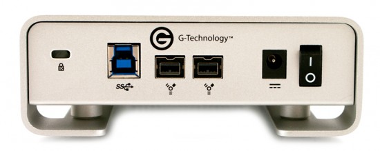

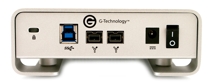

Hello. What is an appropriate UPS for a G-Tech drive (GDREG6EB40001BDB). This drive does not run on my laptop's battery but is connected to the mains with its own AC adapter. I've been navigating both G-Tech and APC websites for an hour now and can't seem to get an answer.
Thanks for any assistance. The load shedding in South Africa these days is a bad joke.
I've attached a photo of the ports for the G-tech model I'm using.
File comment: Ports for G-Tech HDD (GDREG6EB40001BDB)

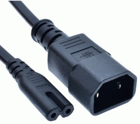

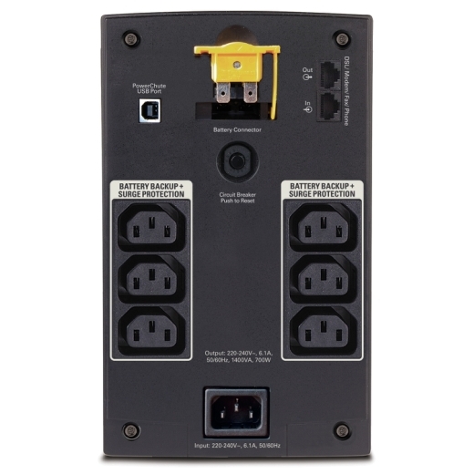

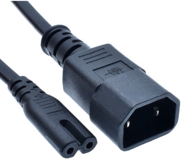

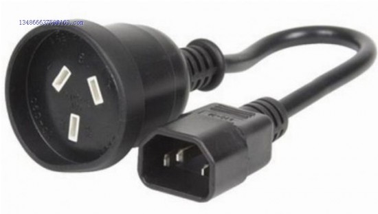

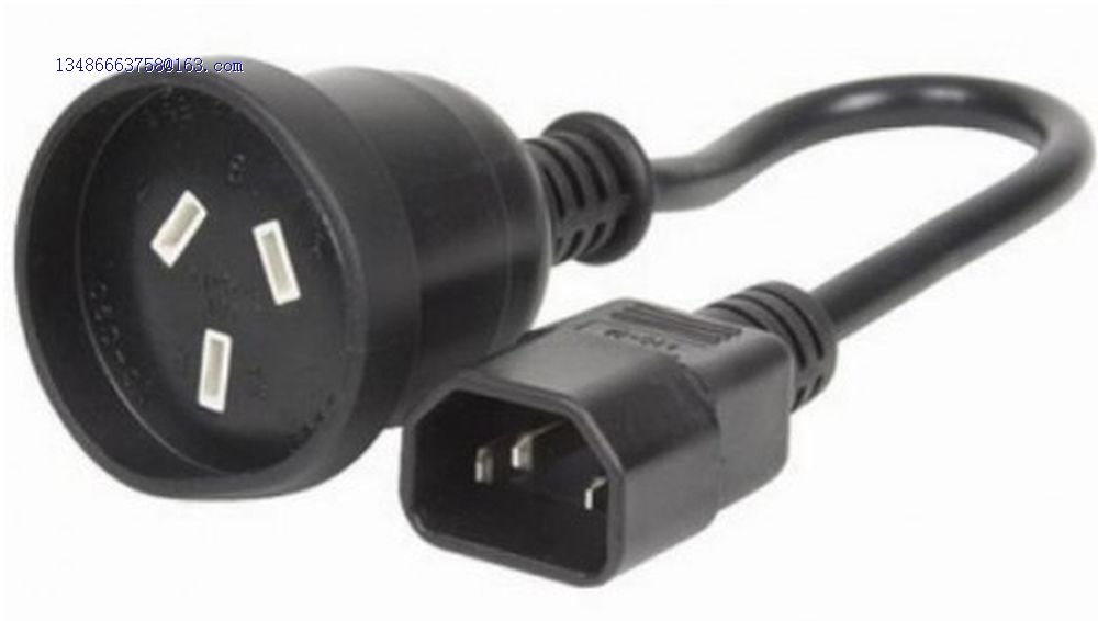

To be clearer, UPS is usually designed for whatever devices you want to plug into it. Not specific UPS for a specific hard drive for example.
S you would buy a UPS either with your socket type (Type D or M I believe, in SA )directly on the UPS and you plug in your standard HDD adapter to it, or buy a UPS with IEC plugs and add a "pigtail" or adapter cable:
UPS:
IEC to Figure 8
or your equivalent to what I would use in Australia:
Your UPS supplier should be able to help you.

Unfortunately APC just confused me again with their response today.
Hey recommended this unit because, I quote, the USB from my drive is supposed to link to it... Is it the USB or the AC adapter? Because the one USB port on my drive obviously has to connect to my laptop.
https://www.apc.com/shop/uk/en/products ... BE850G2-UK
 Post subject: Re: UPS for a G-Tech HDD
PostPosted: November 28th, 2020, 2:18
Posts: 3975
You plug the power supply of the hard drive into the UPS Instead of plugging it into a wall socket. (not the USB)
wall->UPS>Hard drive
if the power from the wall dies, the UPS battery keeps powering hard drive, with the advantage of "cleaner" power as well.
The suggested UPS should be fine. As long as your hard drive power supply plug suits, and the apprx 230v is ok.
The USB on the UPS can be used to charge things like phones I would assume
