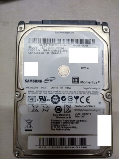

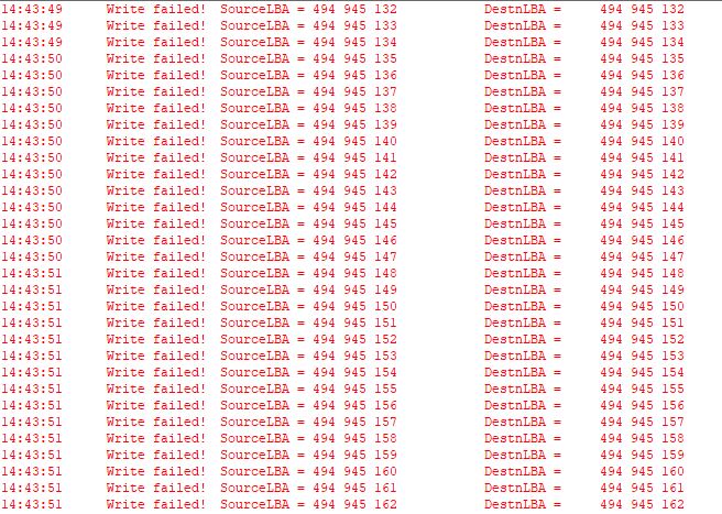

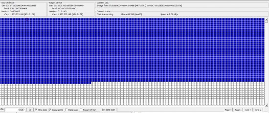

Hello Folks,
I was working a HDD Samsung M8E. Try to recover data from this faulty drive getting below error.
I am using MRT Express card.

Try to Image Head by Head but still same error. Kindly help me.....
Any suggestion appreciated.
Thanks and Regards,
Aloke

Copy Head by Head but still all head same write error issue.
Thanks and Regards,
Aloke

I usually disable a couple of things in firmware to avoid unneccessary writes...
 Post subject: Re: Samsung M8E issue
PostPosted: January 11th, 2021, 2:03
Posts: 411
Location: Romania
I think it is a problem with destination/task settings rather than with the Samsung hdd. In samsung utility, go to Tools->User sector view and check if you can read any sector. If sectors can be read, the problem is elsewhere.
Rgds.

see the hdd model......
+1
Your destination disk has a problem and needs to be replaced!
... write error issue...

The destination disk is mounted by windows.
Modify sector 0 last byte from 55AA to something else
