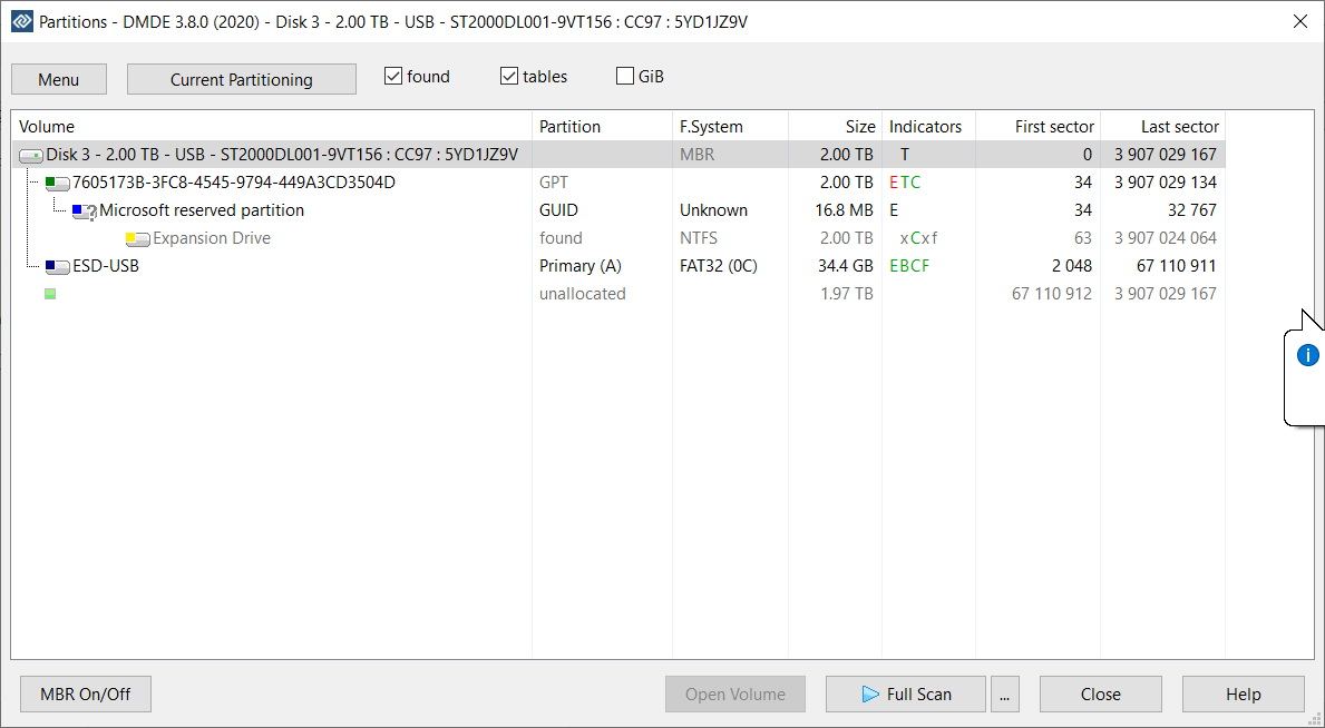

Can you show us the Partitions window in DMDE?

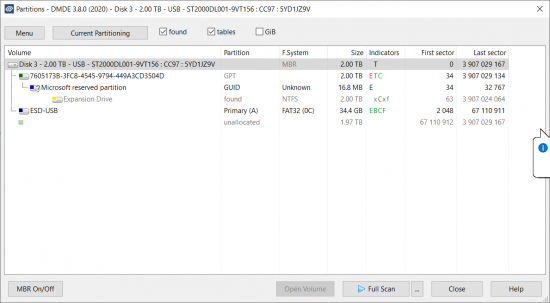

 Post subject: Re: 4GB of 2TB hdd is overwritten, how to recover the rest
PostPosted: January 24th, 2021, 13:29
Posts: 17217
As expected, the $MFT has been overwritten. I think that a raw recovery will be your only option (as already stated), most likely without original file names.
