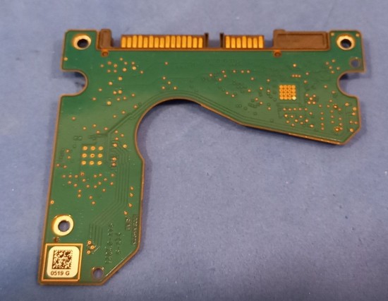

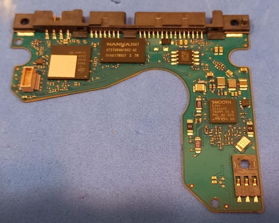

Forum rules
 Post subject: Rosewood short circuiting
PostPosted: January 12th, 2022, 14:10
Joined: January 12th, 2022, 13:53
Location: Brazil
Hello everyone
I need help finding the short circuit points on the SEAGATE ST100LM035
Attached photos for your help
photo1642010575 (1).jpeg
photo1642010575 (1).jpeg [ 126.25 KiB | Viewed 11662 times ]
photo1642010575.jpeg [ 234.91 KiB | Viewed 11662 times ]
