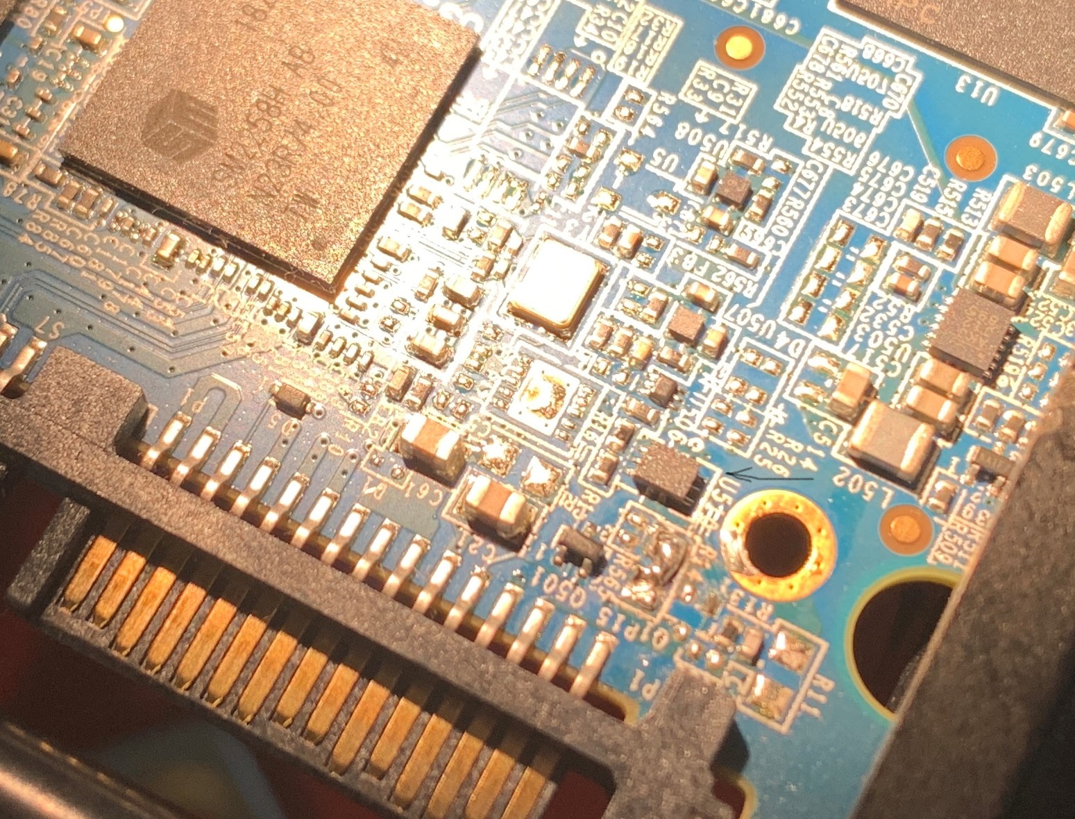

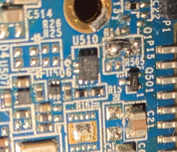

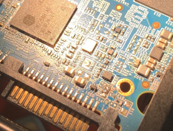

Hello everyone - I'm wondering if some kind soul would help me identify the component shown in the attached pics.
Background: I killed my Crucial MX500 2Tb drive by using the wrong power-supply SATA cables (I have two power-supplies and didn't realize that the power-supply connection cables are not swappable.) PSA: do not assume that ATX power-supply molex connectors are pinned the same way, power-supply to power-supply. I discovered the hard way that they are not. As a result of using the mismatched PS-to-SATA cables, I applied the wrong voltages to the input of the drive. I opened the drive and removed an obviously-blown zero-ohm resistor, replacing the R with a solder-bridge, which brought the drive back to life for a day. Sadly, it has died again. My theory is that whatever 5V regulator which might be on-board was stressed by the repeated application of the incorrect voltage, prior to the zero-ohm resistor failure and subsequently failed after a short period of 5V power re-introduction.

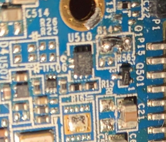

So, I'm guessing that U510 is a power regulator, but I don't know this. With the drive powered off, I traced the 5V connection to U510 (using a multimeter) and the 5V connectivity stops with that component. Perhaps that's to be expected or perhaps it indicates the device is "blown". It's a 10 pin device which is marked with EK72 on the top.
My objective isn't to replace U510, as I'd never be able to get a replacement device soldered on properly. Instead, I'd just like to verify my guess and understand the component operation, such that I could, for instance, properly introduce a regulated 5V externally, to operate the drive long enough to extract the data. Or perhaps my guess is wrong and the failure point is elsewhere.
In one pic, there's a black arrow near U510. My apologies for the lousy pics. Crucial SSD model # CT20000MX500SSD1

MP5016, Monolithic Power, 2.7 - 15V, 0.7 - 5A, Current Limit Switch with Over-Voltage Clamp and Reverse Blocking, marking EK, QFN10:
https://www.monolithicpower.com/pub/media/document/MP5016_r1.0.pdf
This is my HDD/SSD IC database:
http://www.users.on.net/~fzabkar/Datasheets/DATAURLS.HTM
If there is no other fault, you can bridge the Vin and Vout terminals, after removing the IC if necessary.

Markings usually include date and/or batch codes. In your case the part code is "EK", while "72" is a lot number.

Just a quick report that I was able to jumper around the aforementioned component and use a SATA-to-USB converter thing (with wall-wart 12v power supply) to get all the data off of the drive. I did not remove the component, I just installed a jumper from input to output.
Thank you again fzabkar and all for your help!
