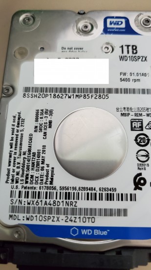

 Post subject: WD10SPZX-24Z10T0 need rom
PostPosted: April 17th, 2022, 12:13
Joined: November 10th, 2009, 13:05
Posts: 31
Location: NYC USA
or closest to this
thanks in advance
S
WD10SPZX.jpg [ 2.06 MiB | Viewed 8050 times ]
 Post subject: Re: WD10SPZX-24Z10T0 need rom
PostPosted: April 17th, 2022, 19:03
Posts: 1768
Location: Verona, Italy
https://firmware.hddsurgery.com/dl.php? ... 7NKHF4.zip
My firmware database:
