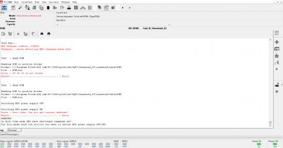

Dear Friends
I have got this case ---
Seagate Mobile HDD 1 TB
ST1000LM035
FW - RKM2
I am using PC3000 UDMA ( latest build 7.1.6) , I am unable to read ROM hence not able to recover data.
ROM is native ,but due to some issue I am unable to read it.
Is there any way to read rom using some secret technique. I can give remote access for the same.
Thanks.
 Post subject: Re: Seagate Mobile HDD ST1000LM035 Rom Reading failure
PostPosted: June 8th, 2022, 7:55
Posts: 402
Location: Moscow
ROM 1,8V

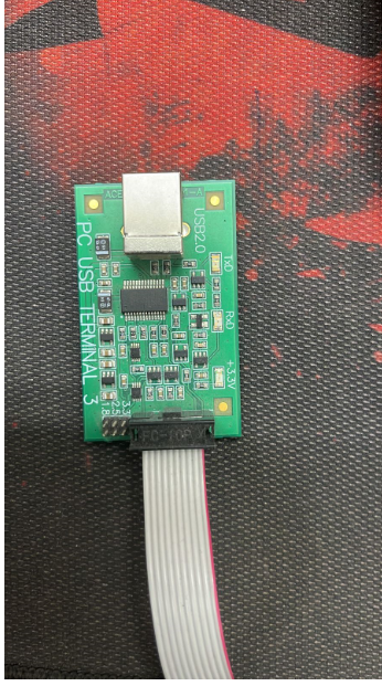

Can you post a picture of your v.3 adapter?
PostPosted: June 15th, 2022, 6:19
Posts: 548
Location: brisbane
here it is ,its from ace only .
I have tried all speeds but no success .Finally I have given up and informed customer that recovery is not possible .I cannot cross technical limits :(
