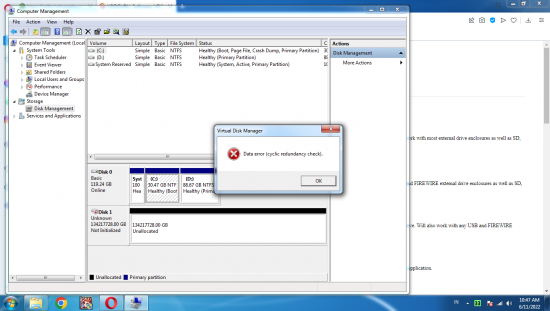

 Post subject: ST1000LM048
PostPosted: June 11th, 2022, 0:11
Banned User
Joined: June 11th, 2022, 0:02
Location: indonesia
Hi there,
i'm new in here ... i dont know is the topic in the right place
well i want to use my ext hdd .. the hdd didnt show up in my computer .. then i check in disk management it show 134217728.00GB
what should i do?
thanks
image_2022-06-11_111106819.png [ 144.35 KiB | Viewed 5425 times ]
 Post subject: Re: ST1000LM048
PostPosted: June 14th, 2022, 3:04
Posts: 3550
That's interesting.
I haven't seen this error before, but 134217728 is not a random number obviously.
I'd put my money on some firmware glitch, but could be anything.
Can you connect terminal and show us output?
At the very least, can you describe how your drive behaves? Does it click? Does it even spin up? Any weird noises?
hex.PNG [ 61.46 KiB | Viewed 5320 times ]
 Post subject: Re: ST1000LM048
PostPosted: June 14th, 2022, 8:56
Posts: 1726
northwind wrote:
That's interesting.
I haven't seen this error before, but 134217728 is not a random number obviously.
I'd put my money on some firmware glitch, but could be anything.
Can you connect terminal and show us output?
At the very least, can you describe how your drive behaves? Does it click? Does it even spin up? Any weird noises?
I'd put my money on a defective SATA cable :)
 Post subject: Re: ST1000LM048
PostPosted: June 19th, 2022, 8:30
Banned User
Joined: June 11th, 2022, 0:02
Location: indonesia
northwind wrote:
That's interesting.
I haven't seen this error before, but 134217728 is not a random number obviously.
I'd put my money on some firmware glitch, but could be anything.
Can you connect terminal and show us output?
At the very least, can you describe how your drive behaves? Does it click? Does it even spin up? Any weird noises?
its sound normal ... its spin and no weird noises
i check with almost software, its the same ..
 Post subject: Re: ST1000LM048
PostPosted: June 21st, 2022, 3:19
Posts: 3550
northwind wrote:
Can you connect terminal and show us output?
 Post subject: Re: ST1000LM048
PostPosted: June 21st, 2022, 6:52
Joined: May 13th, 2019, 7:50
Posts: 1197
Location: Nederland
NVM - delete pls.
 Post subject: Re: ST1000LM048
PostPosted: June 21st, 2022, 9:18
Banned User
Joined: June 11th, 2022, 0:02
Location: indonesia
Arch Stanton wrote:
NVM - delete pls.
why ??
i here to learn .. cant anyone enlight me ? if no one ... oks just delete this thread
but if someone dont mind to share ur knowledge n purpose this forum / thread open to share dont they ?
thanks
Users browsing this forum: Clusterzx and 324 guests
