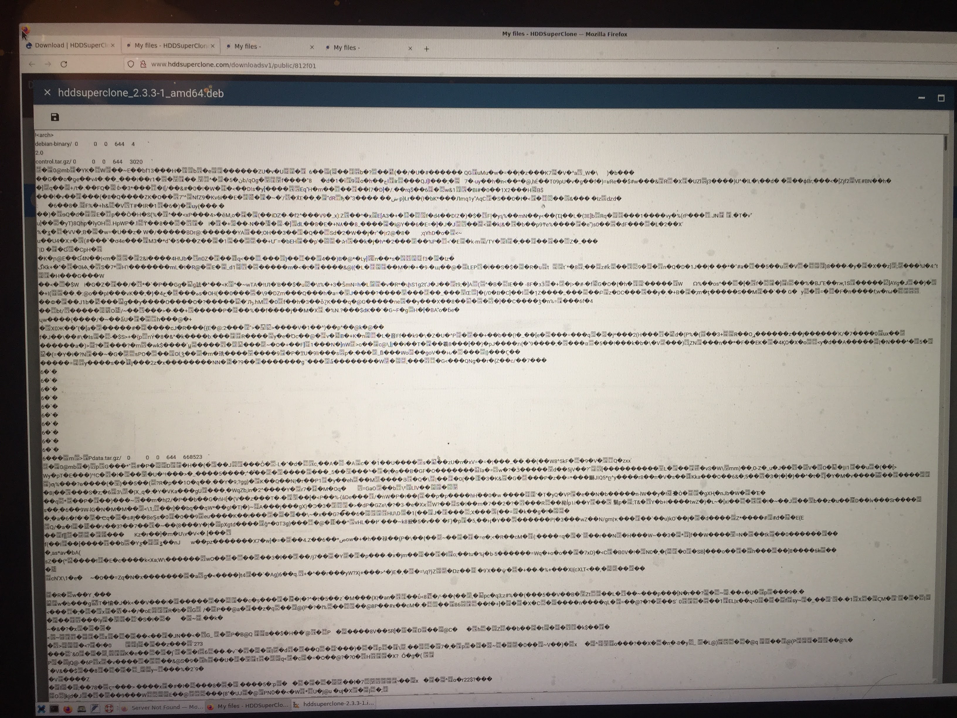

I had already given up but then I saw the video. The problem is that I even problems starting it, downloading it. I get this image when I try to download the latest version

That's the package rather than the livecd ISO You want this file http://www.hddsuperclone.com/sitev1/hddlivecd/download
I have a feeling you may need someone a bit more technical to assist you with this.
