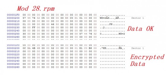

 Post subject: WD40EDAZ-11SLVB0 drive keeps clicking and reset power
PostPosted: November 18th, 2022, 7:32
Joined: July 11th, 2018, 10:55
Posts: 43
Hi all
Problem with the drive is initially drive used to spin, click and reset power(its a external 4 tb wd drive with power adapter)
I have read rom from patient pcb and unlocked rom using pc3k and wrote back the unlocked rom to patient pcb after blocking module 02 drive comes ready and i could even backup complete resources all modules look good, but when i allow access to module 02 drive keeps resetting power i had got help from ACE TS they did the same blocking module 02 and opened t2 recovery and saved as t2data.bin and tried to upload module 02 in ram and did warm rest and drive comes ready with full id using utility reading after routing the saved t2data.bin got access to sector but sector looks encrypted and ace ended up leaving no solution.
FYI - the same problem but its an internal drive i solved using the above mentioned method and data was not encrypted
Does any 1 have solution for this drive
 Post subject: Re: WD40EDAZ-11SLVB0 drive keeps clicking and reset power
PostPosted: November 18th, 2022, 9:42
Posts: 347
Location: india
module 28
28.jpg [ 118.67 KiB | Viewed 3785 times ]
If module 28 is first type then getting Normal,
If module 28 is Second type always getting only Encrypted Data
is there any solution for That ?
 Post subject: Re: WD40EDAZ-11SLVB0 drive keeps clicking and reset power
PostPosted: November 22nd, 2022, 3:33
Posts: 347
Location: india
gps31 wrote:
module 28
If module 28 is first type then getting Normal,
If module 28 is Second type always getting only Encrypted Data
is there any solution for That ?
Sorry It is MOD 25
 Post subject: Re: WD40EDAZ-11SLVB0 drive keeps clicking and reset power
PostPosted: November 22nd, 2022, 5:42
Posts: 1091
Location: Angel Data Recovery
jamesrajesh007 wrote:
Hi all
Problem with the drive is initially drive used to spin, click and reset power(its a external 4 tb wd drive with power adapter)
I have read rom from patient pcb and unlocked rom using pc3k and wrote back the unlocked rom to patient pcb after blocking module 02 drive comes ready and i could even backup complete resources all modules look good, but when i allow access to module 02 drive keeps resetting power i had got help from ACE TS they did the same blocking module 02 and opened t2 recovery and saved as t2data.bin and tried to upload module 02 in ram and did warm rest and drive comes ready with full id using utility reading after routing the saved t2data.bin got access to sector but sector looks encrypted and ace ended up leaving no solution.
FYI - the same problem but its an internal drive i solved using the above mentioned method and data was not encrypted
Does any 1 have solution for this drive
Yes it could be done.
Angel Data Recovery
