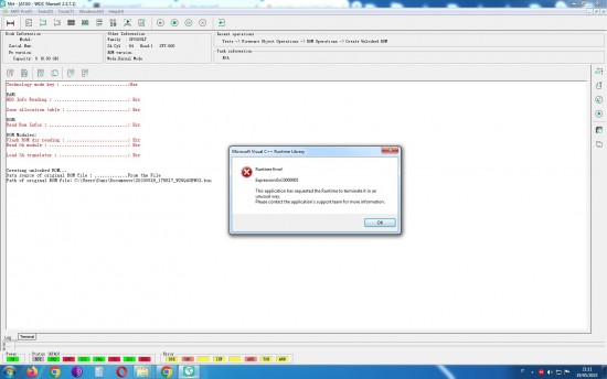

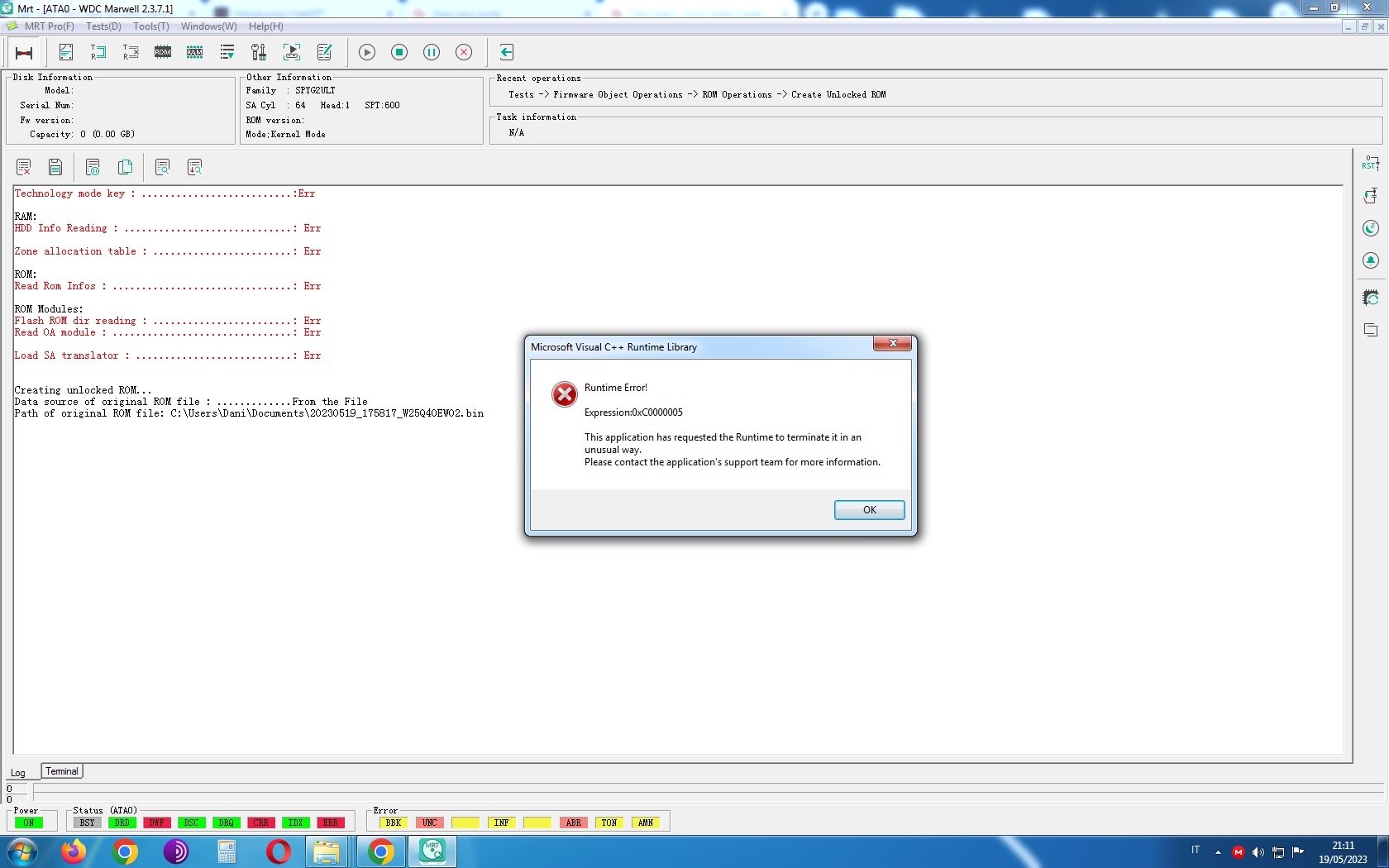

 Post subject: Error while Create unlocked ROM with MRT 2.1.7.1
PostPosted: February 21st, 2023, 13:15
Joined: April 24th, 2018, 11:02
Posts: 288
Hi I have this Rom From 800077 board that gives me error while create unlocked ROM , and with latest update need of new programmer which I dont have, so anyone could unlock this for me? Thanks in Advance.
3224.zip [630.61 KiB]
Downloaded 527 times
 Post subject: Re: Error while Create unlocked ROM with MRT 2.1.7.1
PostPosted: February 21st, 2023, 13:42
Posts: 1318
Unlocked with PC3000 7.2
3224-unlock.zip [631.55 KiB]
Downloaded 593 times
 Post subject: Re: Error while Create unlocked ROM with MRT 2.1.7.1
PostPosted: February 22nd, 2023, 4:44
Joined: April 24th, 2018, 11:02
Posts: 288
Lardman wrote:
Unlocked with PC3000 7.2
Thank you sir, worked even better than MRT :o , with MRT I need to do Exchange command with terminal.
Maybe I bother you later for more request to unlock :lol: :lol: :lol:
 Post subject: Re: Error while Create unlocked ROM with MRT 2.1.7.1
PostPosted: February 22nd, 2023, 9:33
Posts: 1768
Location: Verona, Italy
I unlocked with MRT 2171 "special version" which doesn't require the adapter
Try it if you can and let us know if it works.
3224 RomFile_Unclocked by MRT 2171.rar [407.34 KiB]
Downloaded 542 times
My firmware database:
 Post subject: Re: Error while Create unlocked ROM with MRT 2.1.7.1
PostPosted: February 22nd, 2023, 12:46
Joined: April 24th, 2018, 11:02
Posts: 288
michael chiklis wrote:
I unlocked with MRT 2171 "special version" which doesn't require the adapter
Try it if you can and let us know if it works.
3224 RomFile_Unclocked by MRT 2171.rar
For now Im in imaging process, so can not test rom.
Well I have that version and unlocked many ROMs with it, but i dont know why display error while creating some ROMs process.
Could you upload your special version, maybe mine is not good.
 Post subject: Re: Error while Create unlocked ROM with MRT 2.1.7.1
PostPosted: February 22nd, 2023, 15:26
Posts: 1768
Location: Verona, Italy
MRT 2171 OFFLINE special version
https://www.mediafire.com/file/4t1buonyivfwtdi/
MRT 2171 NET special version
https://www.mediafire.com/file/ekxqfamsskyodym/
My firmware database:
 Post subject: Re: Error while Create unlocked ROM with MRT 2.1.7.1
PostPosted: February 26th, 2023, 1:07
Joined: April 24th, 2018, 11:02
Posts: 288
michael chiklis wrote:
Thanks I let you know after test it.
 Post subject: Re: Error while Create unlocked ROM with MRT 2.1.7.1
PostPosted: March 1st, 2023, 12:48
Joined: April 24th, 2018, 11:02
Posts: 288
michael chiklis wrote:
Thanks it worked.
 Post subject: Re: Error while Create unlocked ROM with MRT 2.1.7.1
PostPosted: March 4th, 2023, 15:28
Posts: 1768
Location: Verona, Italy
Nice :)
My firmware database:
 Post subject: Re: Error while Create unlocked ROM with MRT 2.1.7.1
PostPosted: May 19th, 2023, 15:16
Posts: 1768
Location: Verona, Italy
Special version of mrt 2171 that allows to unlock WD rom without adapter doesn't work anymore for me.
I always get this Visual C++ runtime error everytime i give the command to unlock the rom.
Runtime error.jpg
Runtime error.jpg [ 249.69 KiB | Viewed 9214 times ]
I tried to reinstall Visual C++, updating, reinstall mrt 2171, but i can't make it work again.
Does some of you get same issue?
Can someone try it and let me know if you have the same issue, please?
Thanks.
My firmware database:
 Post subject: Re: Error while Create unlocked ROM with MRT 2.1.7.1
PostPosted: May 19th, 2023, 16:11
Posts: 1768
Location: Verona, Italy
P.S.
i'm using Win7 Pro x64
My firmware database:
 Post subject: Re: Error while Create unlocked ROM with MRT 2.1.7.1
PostPosted: May 20th, 2023, 3:37
Joined: April 24th, 2018, 11:02
Posts: 288
Works fine for me, I suggest to reinstall windows.
 Post subject: Re: Error while Create unlocked ROM with MRT 2.1.7.1
PostPosted: May 20th, 2023, 5:32
Posts: 1768
Location: Verona, Italy
siamak5561 wrote:
Works fine for me, I suggest to reinstall windows.
Thank you, i was thinking that too.
I'm going to install Win10
My firmware database:
 Post subject: Re: Error while Create unlocked ROM with MRT 2.1.7.1
PostPosted: May 20th, 2023, 15:49
Posts: 344
Location: Eastern Europe
Roll back Windows to a restore point when the program was running.
Did not help - disable DEP for this program.
 Post subject: Re: Error while Create unlocked ROM with MRT 2.1.7.1
PostPosted: May 20th, 2023, 22:06
Posts: 17311
FWIW, the error code C0000005 is a "memory access violation". I believe the "expression" is actually an "exception".
I don't know how this info would help you, though.
 Post subject: Re: Error while Create unlocked ROM with MRT 2.1.7.1
PostPosted: May 21st, 2023, 14:28
Posts: 1768
Location: Verona, Italy
siamak5561 wrote:
Works fine for me, I suggest to reinstall windows.
are you using Win 10?
My firmware database:
 Post subject: Re: Error while Create unlocked ROM with MRT 2.1.7.1
PostPosted: May 22nd, 2023, 9:03
Joined: April 24th, 2018, 11:02
Posts: 288
Yes win 10
 Post subject: Re: Error while Create unlocked ROM with MRT 2.1.7.1
PostPosted: May 23rd, 2023, 4:46
Joined: June 26th, 2019, 8:55
Posts: 43
Location: Indore, India
michael chiklis wrote:
Can someone try it and let me know if you have the same issue, please?
Thanks.
It is Because MRT 2.1.7.1 doesn't Support Unlocking SPYGLASS Drives .
This Version Only Support Charger and Palmer , Carmel.
You are Unlocking Spyglass in Older Unsupported Version .
 Post subject: Re: Error while Create unlocked ROM with MRT 2.1.7.1
PostPosted: May 23rd, 2023, 7:17
Posts: 1768
Location: Verona, Italy
You're right!
So now we really need the adapter to unlock spyglass rom :?
Where to find it?
I don't like to buy from mrt because we've to contact them on skype (can't buy directly from mrt website)... i like to buy directly from website with payment protection.
My firmware database:
 Post subject: Re: Error while Create unlocked ROM with MRT 2.1.7.1
PostPosted: May 23rd, 2023, 10:46
Joined: November 5th, 2015, 18:00
Posts: 82
Location: in the lab
There are a few options on Aliexpress:
https://www.aliexpress.com/item/1005005227247203.html
VEXUS Data Recovery
