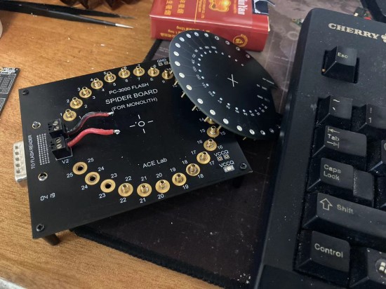

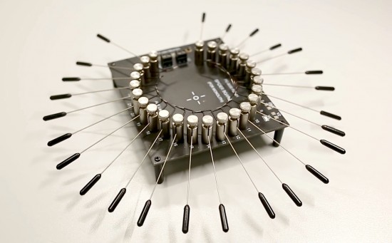

 Post subject: Want to buy 2nd Hand SPIDER BOARD for PC3000 FLASH
PostPosted: April 5th, 2023, 7:25
Posts: 261
Location: Vietnam
As the title says. I am willing to buy 2nd Hand SPIDER BOARD for PC3000 FLASH
Because i feel spending 2000 Euros is to much for me but 1000+ is manageable :cry: :cry: :cry:
If anyone have 1 to spare please PM me or send me an email at gameboybin@gmail.com
Thanks!
Spider_main.jpg [ 278.69 KiB | Viewed 15392 times ]
 Post subject: Re: Want to buy 2nd Hand SPIDER BOARD for PC3000 FLASH
PostPosted: April 5th, 2023, 9:41
Joined: May 13th, 2019, 7:50
Posts: 1197
Location: Nederland
Did you, or anyone else, ever try one of these cheaper spider board clones from Ali?
 Post subject: Re: Want to buy 2nd Hand SPIDER BOARD for PC3000 FLASH
PostPosted: April 6th, 2023, 11:55
Joined: July 8th, 2019, 12:27
Posts: 162
Location: 中国大陆浙江省湖州市
A suggestion from an old user: never rely on having a spider board to avoid welding. For single-cell data recovery, welding is a necessary skill! Probes are not practical! Automatic pin allocation does not always work well all the time. I was lucky enough to succeed once, but only once! The probability of success is only slightly higher than winning the lottery. However, it can indeed achieve relatively good reading results on some individual cells, which is currently the only reason why I use it. Most of the time, it just sits in the corner.
1.jpg [ 249.02 KiB | Viewed 15285 times ]
http://flash-matrix.com/
 Post subject: Re: Want to buy 2nd Hand SPIDER BOARD for PC3000 FLASH
PostPosted: May 7th, 2023, 7:37
Joined: August 29th, 2021, 5:46
Posts: 47
Location: China
I have two spider boards to sell, and these accessories are not regional. I am in China
My Website: https://xgfix.com
SKYPE: soo558
 Post subject: Re: Want to buy 2nd Hand SPIDER BOARD for PC3000 FLASH
PostPosted: May 7th, 2023, 7:39
Joined: August 29th, 2021, 5:46
Posts: 47
Location: China
csava wrote:
A suggestion from an old user: never rely on having a spider board to avoid welding. For single-cell data recovery, welding is a necessary skill! Probes are not practical! Automatic pin allocation does not always work well all the time. I was lucky enough to succeed once, but only once! The probability of success is only slightly higher than winning the lottery. However, it can indeed achieve relatively good reading results on some individual cells, which is currently the only reason why I use it. Most of the time, it just sits in the corner.
没想到在这里碰到你啊,嘿嘿,我是赵飞
My Website: https://xgfix.com
SKYPE: soo558
Users browsing this forum: No registered users and 118 guests
