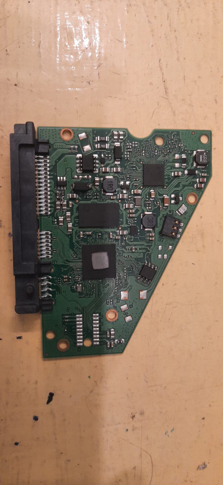

 Post subject: Re: D0 - ST4000DM004-2U9104 ROM ANALYSIS REQUEST
PostPosted: May 10th, 2023, 4:07
Joined: July 11th, 2018, 10:55
Posts: 43

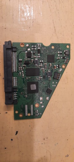

Hi fzabkar ,gps31 post this thread to help me pls find the pcb attached
File comment: Diode was short and i changed them now when i power up i get busy led in tool and drive doesnot spin up

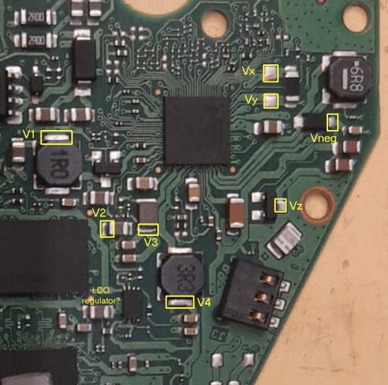

PostPosted: May 10th, 2023, 4:19
Posts: 17339

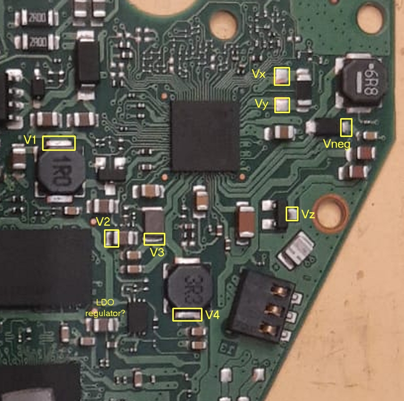

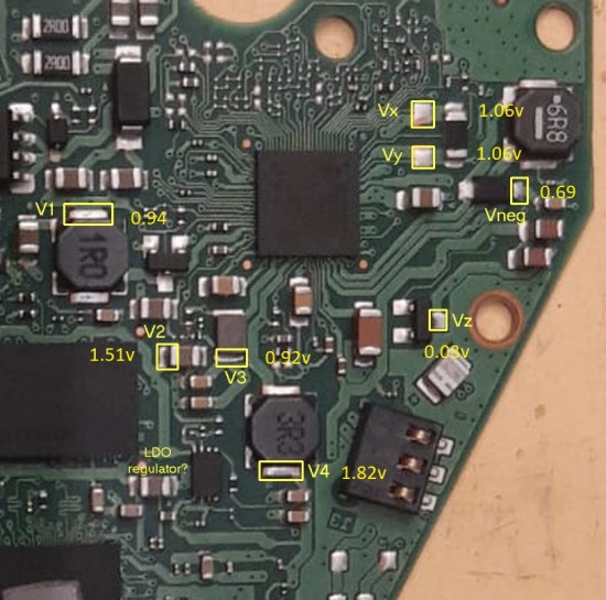

Does the patient spin up after the diode and zero-ohm resistors have been replaced?
Can you measure these voltages?
No it doesnot spin

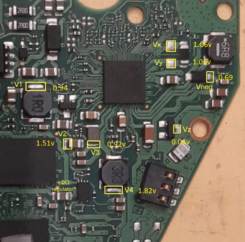

PostPosted: May 12th, 2023, 2:43
Posts: 43
The attachment regs.jpg is no longer available
Hi fzabkar i have marked the volts kindly help and i have already replace zero-ohm resistors
PostPosted: May 12th, 2023, 3:31
Posts: 17339
V1 and V3 look like Vcore supplies. They look OK.
V2 and V4 are I/O supplies. They look OK.
Vneg has either not been switched on by the MCU, or perhaps it has been switched on and then off again when a preamp was not detected.
I don't know what Vx, Vy, Vz are.
The LDO regulator appears to be powering the SDRAM. I would check the voltages at the larger traces going to this chip. I expect you should find 1.35V at the output.
Did you try the donor PCB + donor ROM with patient adaptives?

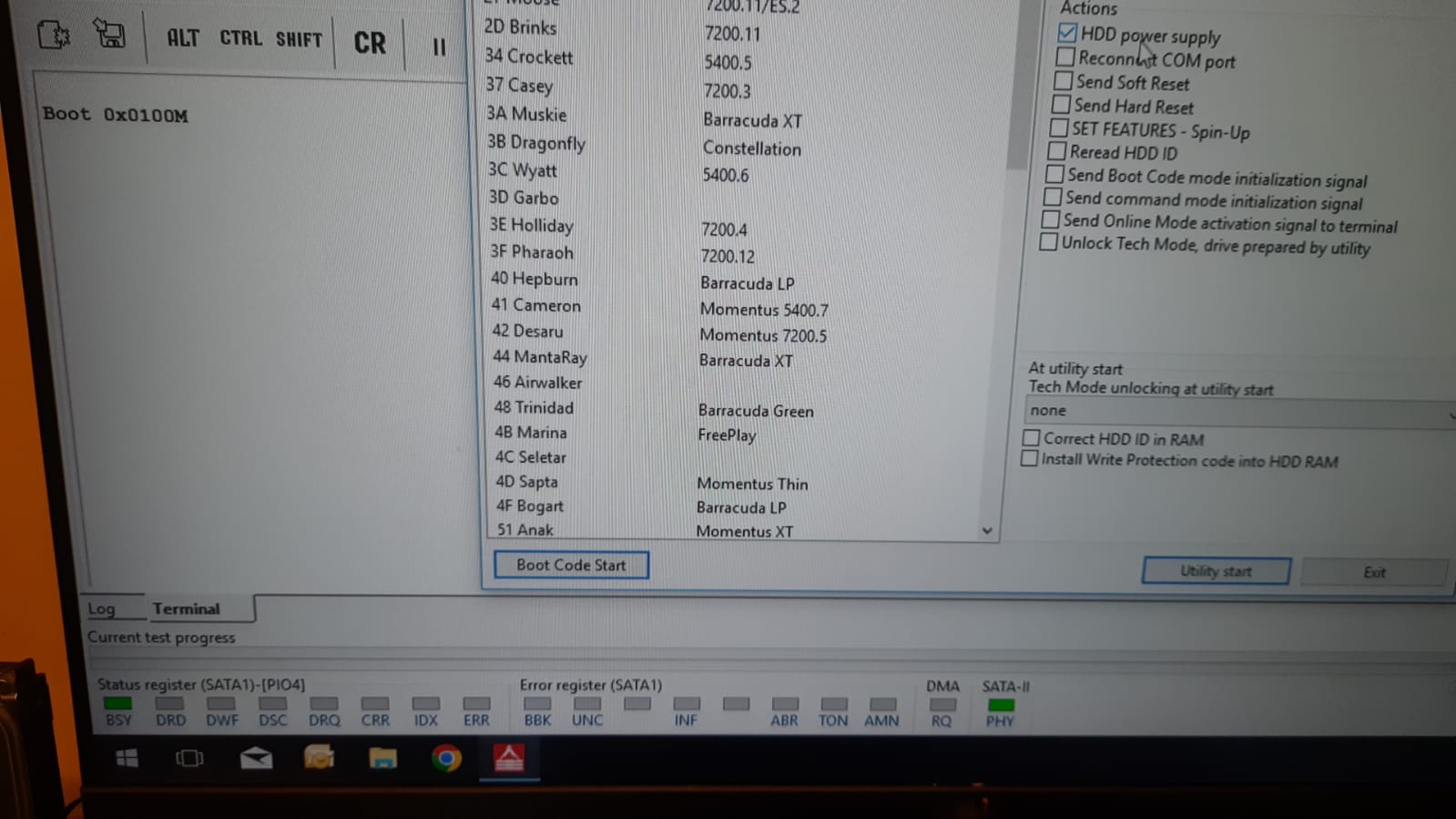

PostPosted: May 12th, 2023, 3:41
Posts: 43

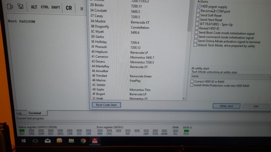

Yes i tried with donor pcb with donor rom and patient adaptives drive spins but i get disc firmware failure error in terminal and no sector access
PostPosted: May 12th, 2023, 12:05
Posts: 347
Location: Eastern Europe
Is it possible to see the start log in the terminal?
It is this ROM. Thank you.
