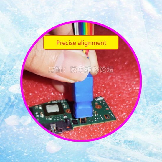

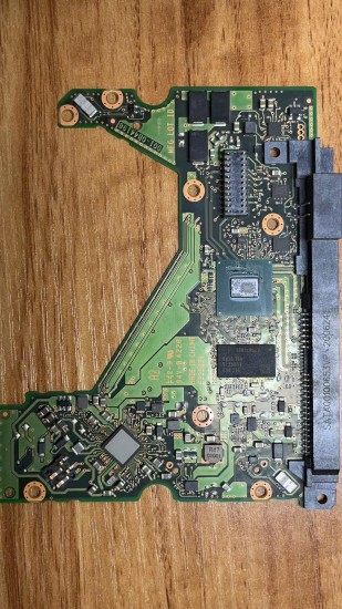

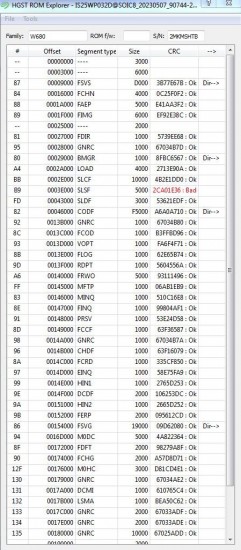

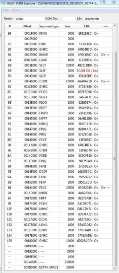

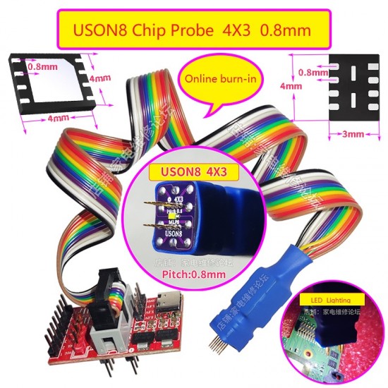

 Post subject: USON8 Chip Probe MLP DFN QFN WSON UDFN 0.8mm 4X3 IC Test Pro
PostPosted: May 23rd, 2023, 2:08
Joined: March 27th, 2014, 2:01
Posts: 52
Location: FLASH GUYS
USON8 Chip Probe MLP DFN QFN WSON UDFN 0.8mm 4X3 IC Test Probe , Compatible with the new HGST WD Seagate 14TB 16TB 18TB ROM read/write, tested without errors and no data loss.
SKYPE :49335007@qq.com
Telegram : @L02233adapter
TEST video: https://drive.google.com/file/d/1_auo8L ... share_link
微信图片_20230505142149.jpg [ 793.13 KiB | Viewed 17111 times ]
photo_2023-05-09_23-22-20.jpg [ 139.49 KiB | Viewed 17111 times ]
photo_2023-05-09_23-22-12 (2).jpg
photo_2023-05-09_23-22-12 (2).jpg [ 140.16 KiB | Viewed 17111 times ]
2.jpg [ 223.26 KiB | Viewed 17111 times ]
3.jpg [ 206.81 KiB | Viewed 17106 times ]
 Post subject: Re: USON8 Chip Probe MLP DFN QFN WSON UDFN 0.8mm 4X3 IC Test
PostPosted: May 24th, 2023, 1:55
Joined: March 27th, 2014, 2:01
Posts: 52
Location: FLASH GUYS
20230524095416.png [ 921.37 KiB | Viewed 16985 times ]
20230524095420.png [ 1.07 MiB | Viewed 16985 times ]
Price: 89USD
 Post subject: Re: USON8 Chip Probe MLP DFN QFN WSON UDFN 0.8mm 4X3 IC Test
PostPosted: May 30th, 2023, 7:31
Posts: 191
Location: Switzerland
Can you share the prise including delivery to Europe ?
 Post subject: Re: USON8 Chip Probe MLP DFN QFN WSON UDFN 0.8mm 4X3 IC Test
PostPosted: May 31st, 2023, 2:50
Joined: March 27th, 2014, 2:01
Posts: 52
Location: FLASH GUYS
Express delivery to which country? Switzerland costs 50USD
 Post subject: Re: USON8 Chip Probe MLP DFN QFN WSON UDFN 0.8mm 4X3 IC Test
PostPosted: June 18th, 2024, 10:46
Posts: 3598
Location: Chicago
deleted
