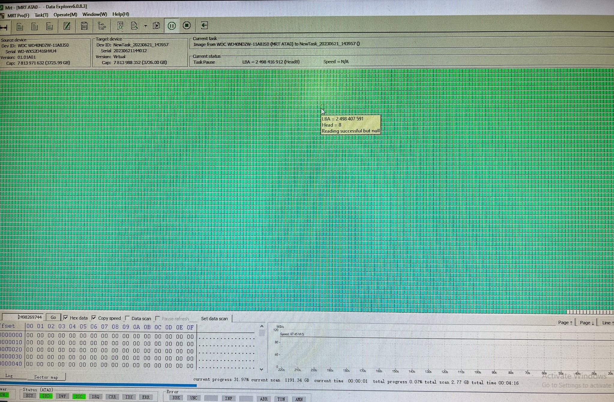

 Post subject: MRT reads and copies all the data as Sector all 0
PostPosted: June 22nd, 2023, 22:44
Banned User
Joined: May 7th, 2023, 20:12
Posts: 26
Location: Earth
WD40NDZW-11A8JS0 with broken heads, unlocked firmware and after head swap and Loading LDR and loading modules 10,11,1B we got access to the data and in File explorer I could see the folders...etc so I started copying the data as virtual VHDX and it was copying green but suddenly turned to blue (sector all 0) so I soft reset and turned off/on the drive and now every time I start the copy it copies blue which means no data is in there? and in File Explorer I get an error and no Folders showing.
14F8BF6A-B6E6-40AB-9B1A-B2C0F3CB05AA.jpg [ 1.67 MiB | Viewed 14071 times ]
1C8341DA-5DEC-44B5-9778-ED45590FEE6B.jpg [ 1.58 MiB | Viewed 14071 times ]
File Explorer 1.jpg
File Explorer 1.jpg [ 211.86 KiB | Viewed 14071 times ]
 Post subject: Re: MRT reads and copies all the data as Sector all 0
PostPosted: June 23rd, 2023, 5:35
Posts: 3551
is module 190 alive?
 Post subject: Re: MRT reads and copies all the data as Sector all 0
PostPosted: June 23rd, 2023, 7:51
Posts: 4840
donor heads killed T2 for good... most likely.
 Post subject: Re: MRT reads and copies all the data as Sector all 0
PostPosted: June 23rd, 2023, 7:51
Posts: 4840
donor heads killed T2 for good... most likely.
 Post subject: Re: MRT reads and copies all the data as Sector all 0
PostPosted: June 23rd, 2023, 9:22
Banned User
Joined: May 7th, 2023, 20:12
Posts: 26
Location: Earth
northwind wrote:
is module 190 alive?
I think it is. after head swap I backed up and saved all modules including 190, so I can load it if I need to.
190 Copy1.jpg
190 Copy1.jpg [ 437.33 KiB | Viewed 13979 times ]
190 Copy11.jpg
190 Copy11.jpg [ 387.1 KiB | Viewed 13979 times ]
190 Copy0.jpg
190 Copy0.jpg [ 450.7 KiB | Viewed 13979 times ]
190 Copy00.jpg
190 Copy00.jpg [ 394.66 KiB | Viewed 13979 times ]
 Post subject: Re: MRT reads and copies all the data as Sector all 0
PostPosted: June 23rd, 2023, 9:24
Banned User
Joined: May 7th, 2023, 20:12
Posts: 26
Location: Earth
pepe wrote:
donor heads killed T2 for good... most likely.
The donor was brand new and exact model number and same date so it is compatible, I don't know why it would kill T2. is there any way to find out for sure in T2 is dead? and if it is then is there anyway to recover the data?
 Post subject: Re: MRT reads and copies all the data as Sector all 0
PostPosted: June 23rd, 2023, 9:47
Banned User
Joined: May 7th, 2023, 20:12
Posts: 26
Location: Earth
northwind wrote:
is module 190 alive?
on the Log I got all these errors when it was reading module 190
190 Copy1 errrr.jpg
190 Copy1 errrr.jpg [ 311.14 KiB | Viewed 13971 times ]
190 Copy1 errr.jpg
190 Copy1 errr.jpg [ 310.99 KiB | Viewed 13971 times ]
 Post subject: Re: MRT reads and copies all the data as Sector all 0
PostPosted: June 24th, 2023, 3:10
Posts: 3551
190 is dead/wiped, ergo T2 killed.
I don't know if MRT has the ability to do anything about it, pc3k can recover it probably.
The main reason is that you didn't write protect the drive after head swap.
 Post subject: Re: MRT reads and copies all the data as Sector all 0
PostPosted: June 25th, 2023, 3:23
Banned User
Joined: May 7th, 2023, 20:12
Posts: 26
Location: Earth
northwind wrote:
190 is dead/wiped, ergo T2 killed.
I don't know if MRT has the ability to do anything about it, pc3k can recover it probably.
The main reason is that you didn't write protect the drive after head swap.
Is there any link or tutorial to explains how to write protect the drive after head swap, so next time I can avoid this problem?
You were right 190 and T2 were dead. I found a tutorial on MRT shows how to fix it. but even after I fixed it every time I tried to start copying data the hard drive turned itself off and on and killed T2. so I had to send 190 to MRT technician to modify it for me and sent it to me then I loaded it to the RAM and it's working now.
here is the link in case someone comes cross the same problem.
how to fix dead 190 T2 with MRT: http://us.mrtlab.com/tech/wdc/321.html
 Post subject: Re: MRT reads and copies all the data as Sector all 0
PostPosted: June 26th, 2023, 2:31
Posts: 3551
Adam112255 wrote:
Is there any link or tutorial to explains how to write protect the drive after head swap, so next time I can avoid this problem?
I don't know MRT so I can't help, maybe the tech that helped you with this case can point you to the right direction.
Generally, there are two ways: Hardware WP and software WP. PC3k has implemented a software WP solution a long time ago and it works quite nice. To me, hardware WP is even better.
 Post subject: Re: MRT reads and copies all the data as Sector all 0
PostPosted: June 30th, 2023, 13:37
Posts: 4840
to my understanding, sw WP requires writing to SA, so it is kind of strange...
i've been using hw wp about since i know my name...
 Post subject: Re: MRT reads and copies all the data as Sector all 0
PostPosted: July 1st, 2023, 13:30
Joined: April 24th, 2018, 11:02
Posts: 288
Hi pepe
How to do " hw wp "
Users browsing this forum: Google [Bot] and 8 guests
