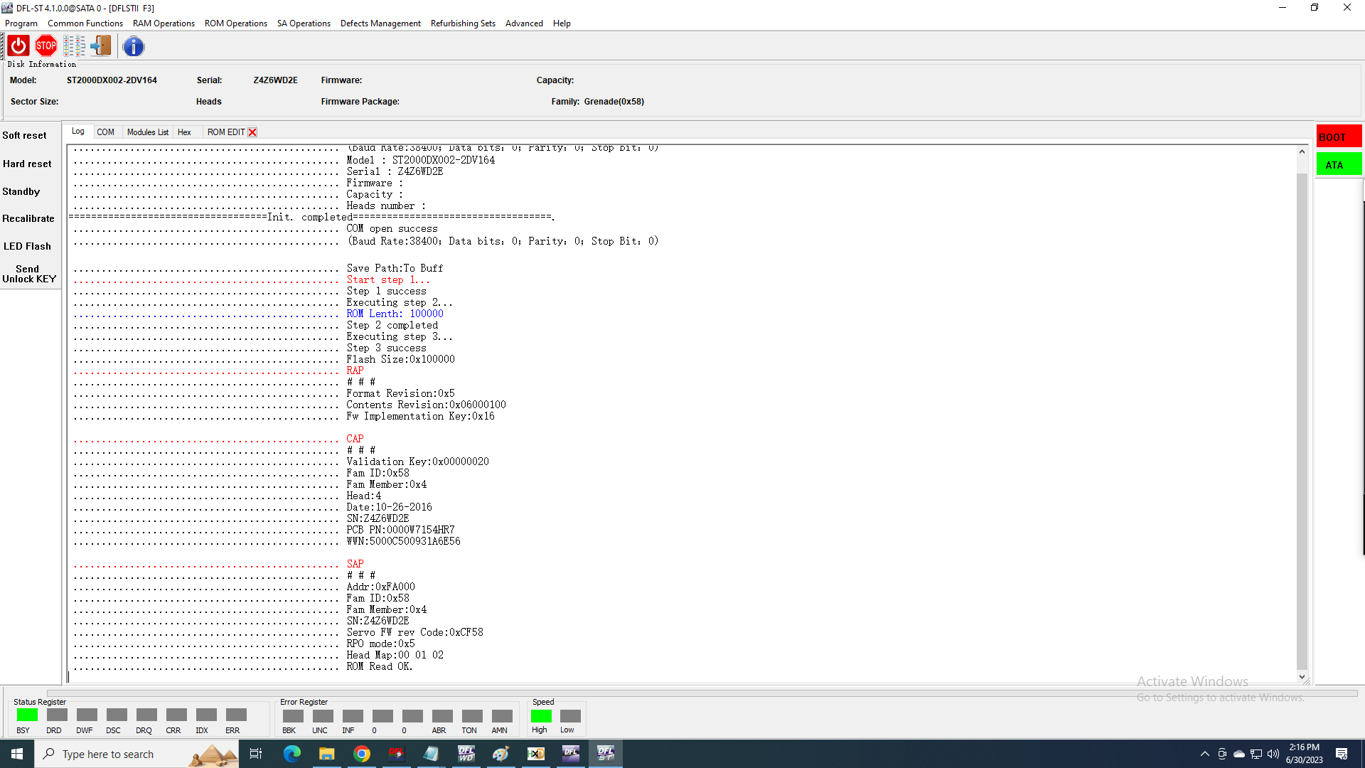

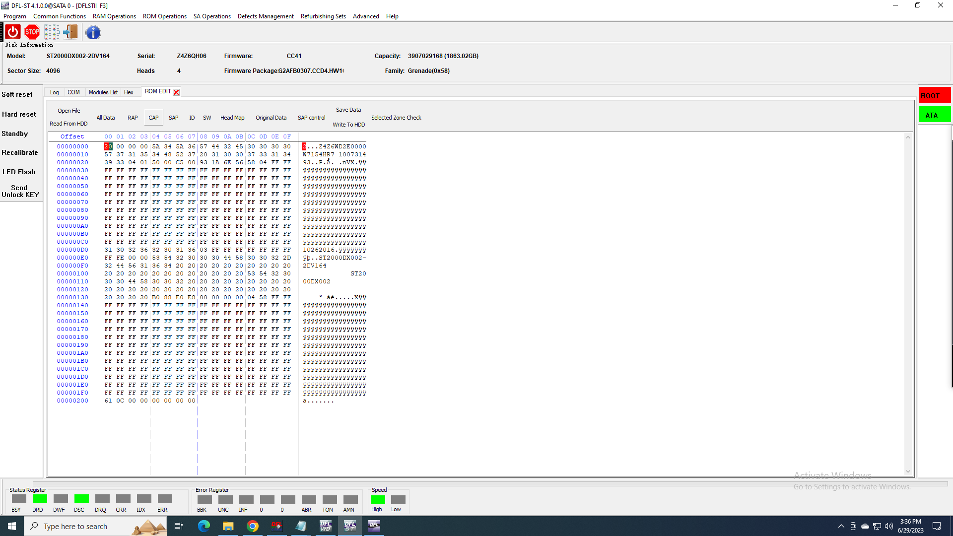

I need help on this drive and believe it is a ROM read/transfer issue that I have.
The patient drive does not spin up dead only terminal that ends with " ALFRecorder: End of ALF Recorder Trace" and believe it is NAND faillure.
SO I sourced two donor drives I did a ROM read from patient and wrote it to the donor PCB after I did zero the donor drive, I swapped the PCB the drive spins gets ready but no sector access and the donor serial number is still in details. If I read the ROM while in the ready state then the patient details is displayed in CAP details as in the picture ?
I believe that there is more to just a ROM read/write that I need to do.

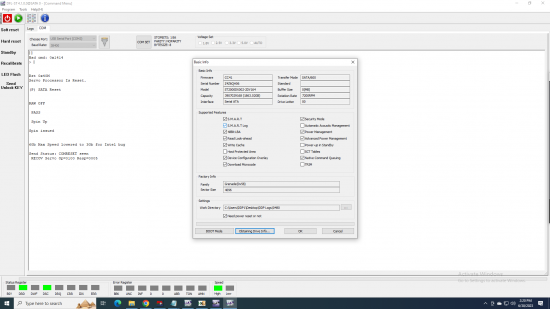

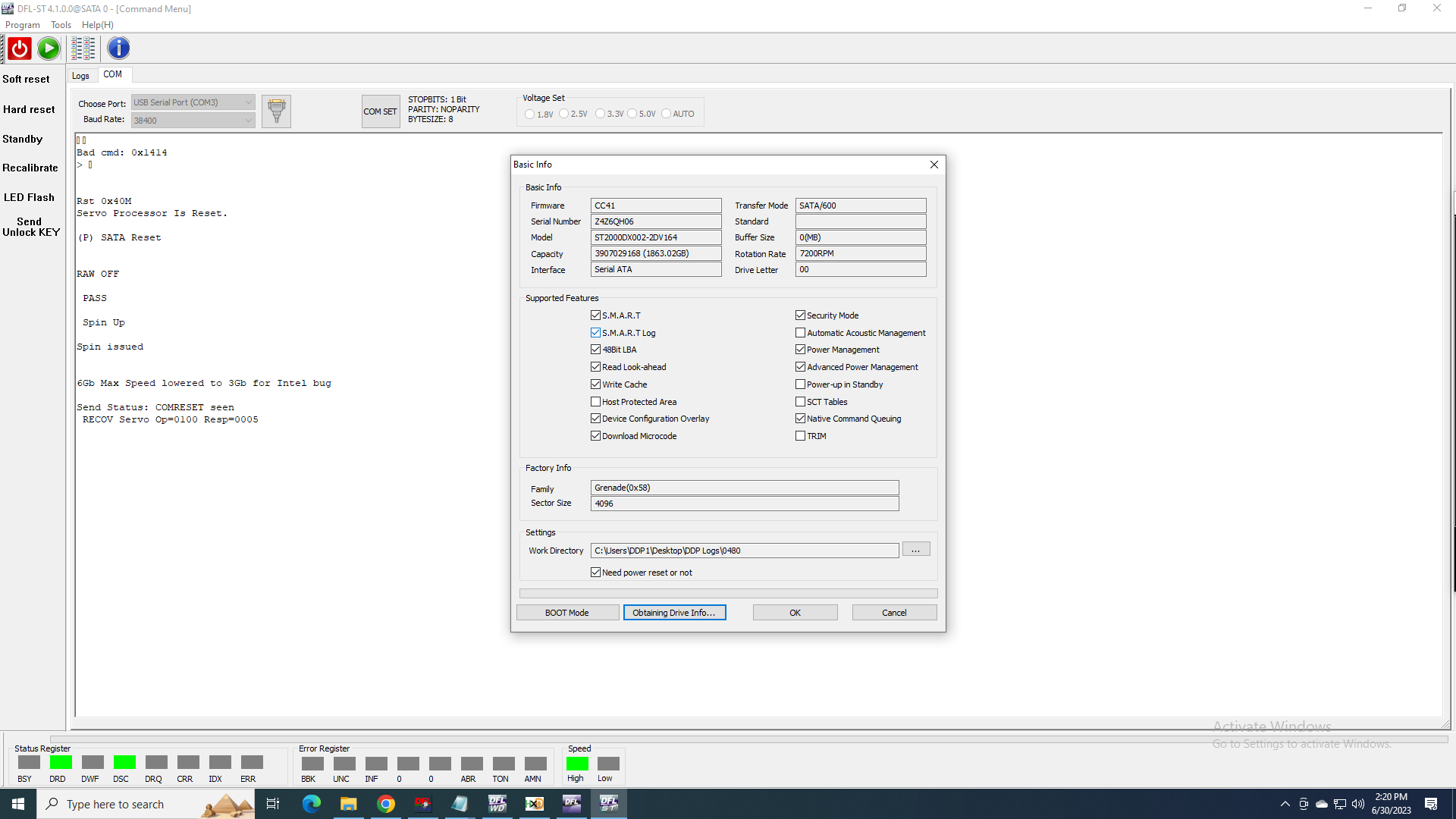

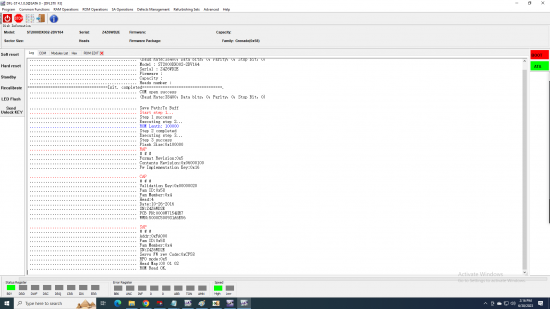

Thanks for that link and my hopes was up because the link describes the exact same problem that I am facing, I did a ATA secure erase on the donor then I run the terminal
F3 O/I command and that was successful. I then wrote the patient ROM to the donor pcb and swap the pcb to the patient drive.
Power on I get the same as in the link with a servo error and ready and still the same problem donor details in normal boot and patient ROM detail in "Bootmode" as the pictures below.
In other words it looks like the drive still boot with donor ROM details and that is reason for servo error but boot in patient ROM if select "Bootmode"
And if I just swap the PCB back to donor then the donor boots up fine with sector access even with patient ROM loaded on it
Patient serial : Z4Z6WD2E
Donor serial: Z4Z6QH06

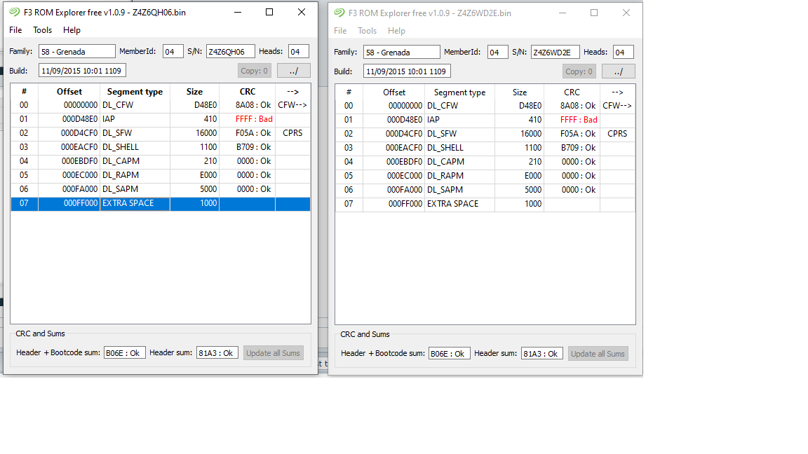

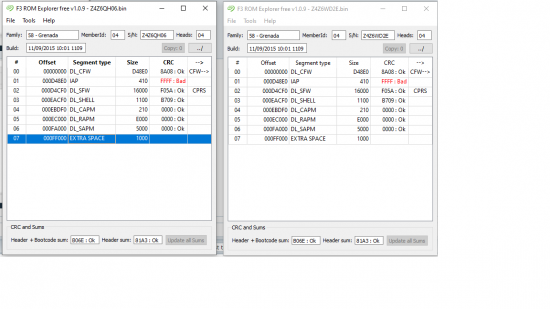

is there any solution to this issue, I attached a screen shot of the patient and donor ROM in F3 explorer and attached both ROMs.
Something tells me that writing via comm port does not replace all ROM versions on the Donor PCB and that is why I get two deferent details from the same board
