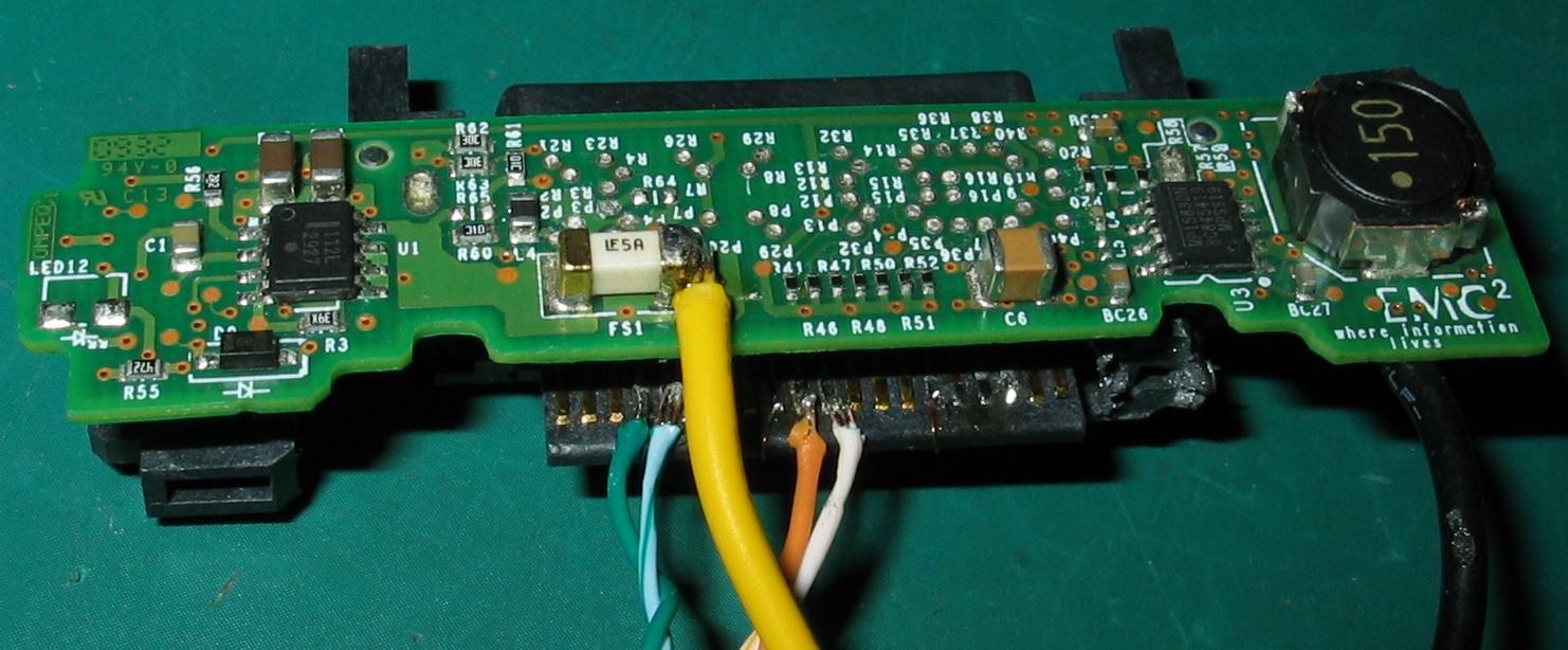

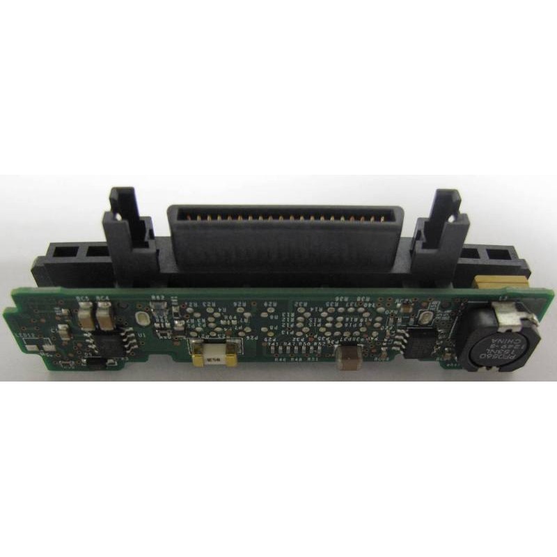

Reviving this old thread because I need to test (SCA-40) FC drives (EMC).
Looks like it's not necessary as hard&expensive. Someone is selling old FC controllers (HHBA-5101) modded by adding a cable with SCA-40 connector:
https://www.ebay.com/itm/314245319246
Maybe I can get a SCA-40 interposer board from a dead EMC drive, solder a cable to pins 24, 25 (+IN1, -IN1) and 30, 31 (+OUT1, -OUT1) and connect the other end to the GBIC or SFP on a FC HBA card? I have some extra QLE2460 HBAs...
The pinouts are here: https://en.wikipedia.org/wiki/Fibre_Cha ... _interface

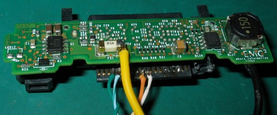

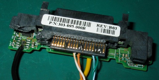

The EMC interposer board 303-095-002B provides 5V supply to drive (older drives without this board are 12V-only) using MP1583DN step-down converter and also short-circuit protection using NIS5112D1 electronic fuse and 5A fuse. It also contains READY and FAULT LEDs.
The input and output SCA-40 connectors are wired 1:1 on most pins, except:
Pin 3 on the input side is not connected with other +12V pins but used as pull-up voltage for NIS5112D1 enable input.
Pin 8 on the input side is connected to NIS5112D1 enable input.
Pins 19, 20, 40 are not connected on the input side. They are connected to the onboard 5V regulator on the output side.
So connect GND, short input pins 2+3 together, connect 12V there (or to the fuse on the bottom side) and ground pins 9, 10 to enable spin-up.
Seagate drives will spin up but FAULT LED is ON.
Some HGST drives will spin up without FAULT LED.
But some other HGST drives will not spin up, FAULT LED is blinking some error code (1 long, maybe 5-6 short blinks).
I don't have FC connected yet. Hopefully the FAULT LED behavior is caused by the lack of FC link.

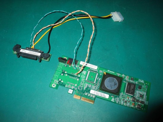

Removed SFF from QLE2460 and connected HDD +IN1/-IN1 to TD+/TD- (SFF pin 9/10) and +OUT1/-OUT1 to RD+/RD- (SFF pin 5/4). Used twisted pairs from an ethernet cable.
Unfortunately, it does not work. With a HGST drive, I get even LOOP UP at 1Gbps but the drive itself is not detected:

Got LOOP UP with Seagate too, the SCA connector was probably not inserted enough before. But drive not detected, though...
 Post subject: Re: SFP to FC schematic
PostPosted: June 29th, 2023, 8:57
Joined: July 17th, 2022, 13:26
Posts: 49
Location: Slovakia
Success!
According to HGST Ultrastar 15K600 (FC-AL) Hard Disk Drive Specification, SEL_ID of 0x7F (which is the default as there are pull-ups on all SEL_IDx pins) "forces the drive to obtain a soft address". Don't know what is a soft address but it's not enough for the drive to be detected.
It also says:
These 7 signals define 128 possible values and are directly translated into an 8 bit hard AL_PA via the table below. Only AL_PA's with neutral disparity are valid values.
Neutral disparity means that the byte must have 4 zero and 4 one bits.
Is grounding one SEL_IDx pin enough to get a valid AL_PA? Yes, e.g. SEL_ID=0x77 means valid AL_PA 0x17 (0b00010111).
So grounded pin 15 (SEL_ID3) and it works!

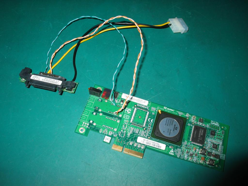

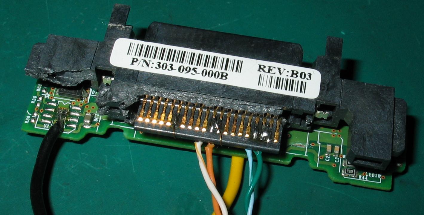

Some photos.
I should probably use some better cable (shielded) for data wires. This seems to work but might fail with big data transfers.

Looks like the 4 non-working drives don't support 1Gbps rate.
Grounded pin 18 (DEVCTRL1) and they now work!
