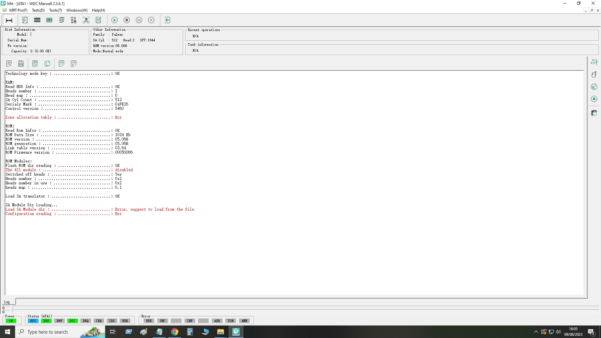

 Post subject: WD10SPZX-75Z10T2, 1Tb. Busy, ready, spin down, no SA.
PostPosted: July 25th, 2023, 23:49
Joined: January 20th, 2021, 0:27
Posts: 109
Location: Indonesia
I got WD10SPZX-75Z10T2, 1Tb. Busy, ready, spin down, this kind of problem usually head issue.
But after head replacement from good working donor ( follow all those donor criteria), problem is remain. Lock or unlock, problem remain same :
- Spindle up then down
- No access to SA
Any body knows, what is the problem?
itbwd.jpg [ 140.29 KiB | Viewed 11171 times ]
 Post subject: Re: WD10SPZX-75Z10T2, 1Tb. Busy, ready, spin down, no SA.
PostPosted: July 26th, 2023, 5:19
Posts: 1768
Location: Verona, Italy
Remount original heads!!
SMR drives can spin down if mod 190 is corrupted.
Enter in the utility in kernel mode, backup rom then disable mod 411 on rom, repower the drive and check if still spins down, if still spins go in normal mode and backup all modules (tick skip mod 190). Backup 190 and 183 manually (double click on each one) in module list, then follow the procedure to repair T2 translator from mod 190 and load it on ram.
Follow video from 20m 56s
https://youtu.be/3HSPQIeRqJw?t=1256
My firmware database:
 Post subject: Re: WD10SPZX-75Z10T2, 1Tb. Busy, ready, spin down, no SA.
PostPosted: August 9th, 2023, 0:49
Joined: January 20th, 2021, 0:27
Posts: 109
Location: Indonesia
Hi michael chiklis,
Thanks for advise, I will try it and get back
 Post subject: Re: WD10SPZX-75Z10T2, 1Tb. Busy, ready, spin down, no SA.
PostPosted: August 9th, 2023, 5:03
Joined: January 20th, 2021, 0:27
Posts: 109
Location: Indonesia
In Kernel mode ; disable mod 411.
Repower, spin down occurred. unable to carry on.
 Post subject: Re: WD10SPZX-75Z10T2, 1Tb. Busy, ready, spin down, no SA.
PostPosted: August 9th, 2023, 5:09
Joined: January 20th, 2021, 0:27
Posts: 109
Location: Indonesia
411 disable, keep spin down
411.jpg [ 257.91 KiB | Viewed 10629 times ]
 Post subject: Re: WD10SPZX-75Z10T2, 1Tb. Busy, ready, spin down, no SA.
PostPosted: August 10th, 2023, 7:03
Posts: 1768
Location: Verona, Italy
really don't know then, sorry.
Maybe original heads got bad?
Does something change if disable mod 183 ?
My firmware database:
Users browsing this forum: No registered users and 1 guest
