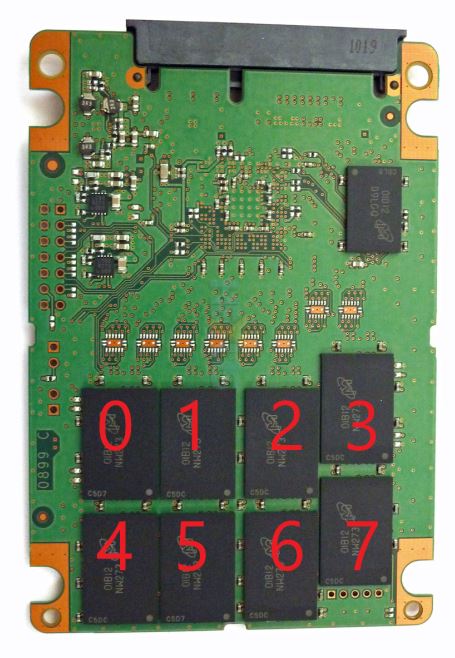

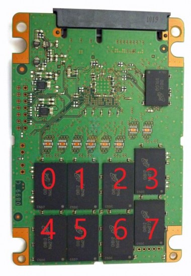

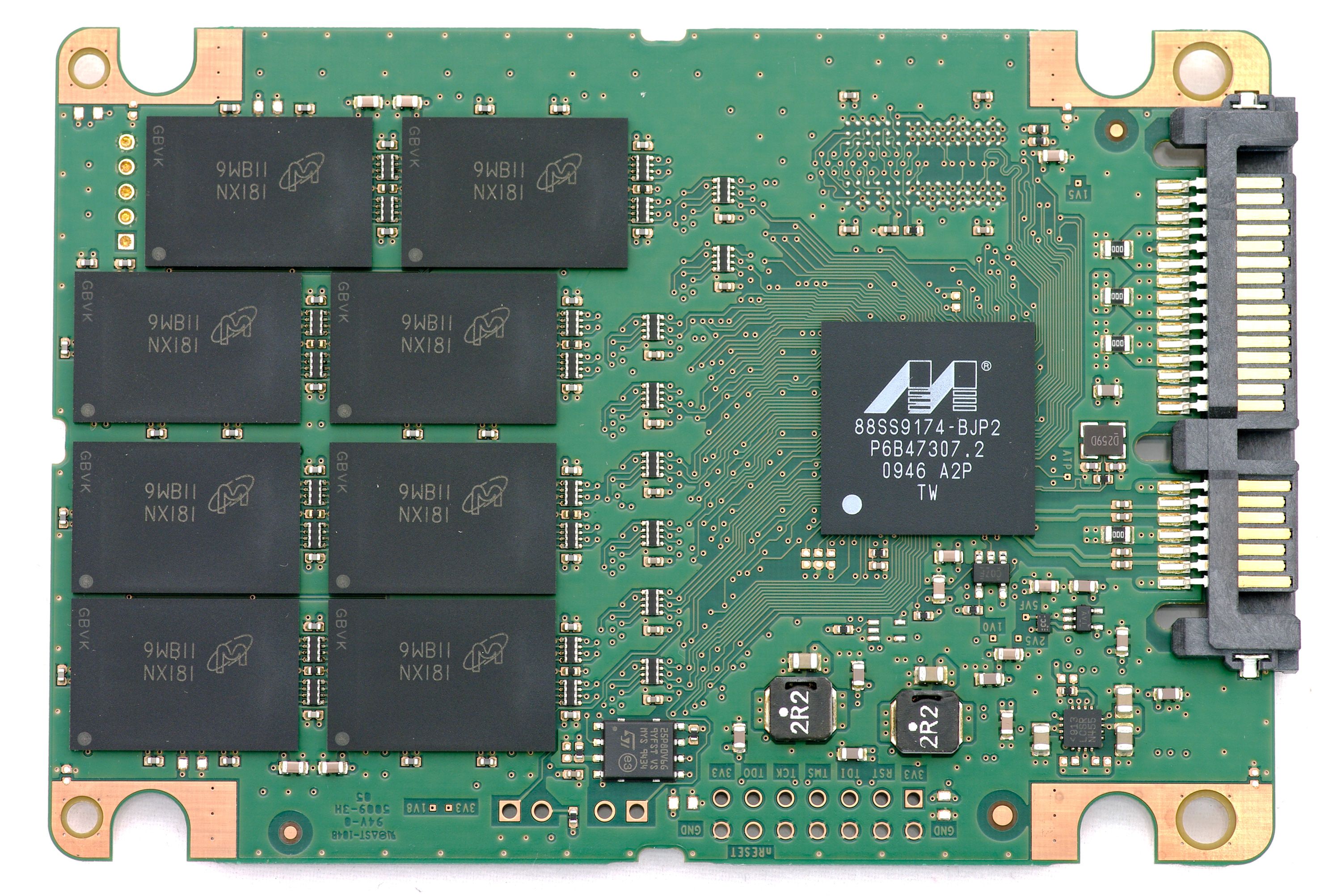

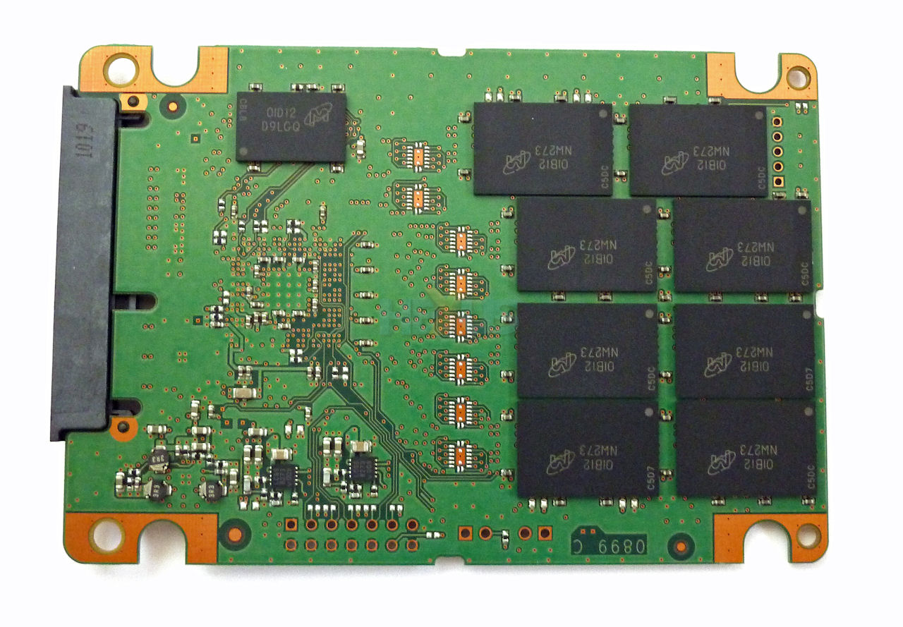

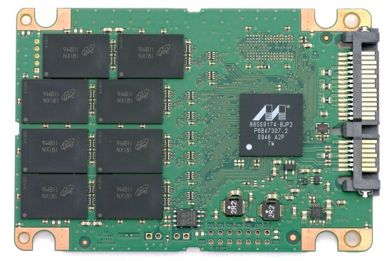

Hello guys does somebody know the CHANNEL configuration for this SSD drive??
short story dead pcb and maybe dead controller.

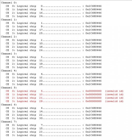

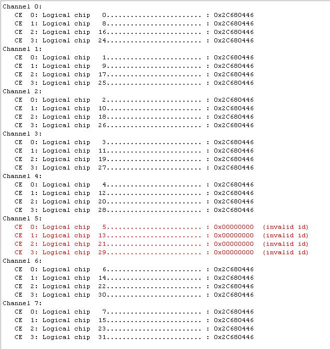

i reballed and soldered the NAND chips on the donor pcb and finally i can turn in on with full id on pc-3000.... however some nand flash ID cannot be readed :(
Roman helped me with many advices and i did reballed AGAIN all the NAND CHIPS ... now only CHANNEL 5 cannot be readed ...i would like to reball it but unfortunatelly i cant figure out what phisical NAND is the CHANNEL 5" since on the PCb nothing is written"....
PLEASE if you have experience with same or simila ssd help me.... this is a crucial 128GB with 16 NAND chips

My guess would be back of the pcb nearest the gpio. I'd pull 1 nand and retest to see if anything else disappears. Until you've had responses from the chips previously you can't be 100% it's not just dead.

The 2 sets of 7 holes, and by back I mean side without controller.
Thank you Sir back side i see. you mean the NAND next to the holes is CHANNEL 0?
there is 16 NAND FLASH but onky 8 CHANNELS on pc-3000..... im confused
 Post subject: Re: NAND CHANNEL configuration of Crucial C300 HELP PLEASE
PostPosted: August 21st, 2023, 6:34
Posts: 1319
You can either wait for someone who has direct experience of pulling nand form a c300 or you can find out by experimenting. The chip you have labelled 0 is where I'd start.
If you remove nand you have marked 0 or 1 and recheck it will give you an idea of the channel layout.

thank you Sir^^ you are very kind. still i dont understand why is showing 0123 for each channel. according to you calculation channel 5 will be nand 5? im confused

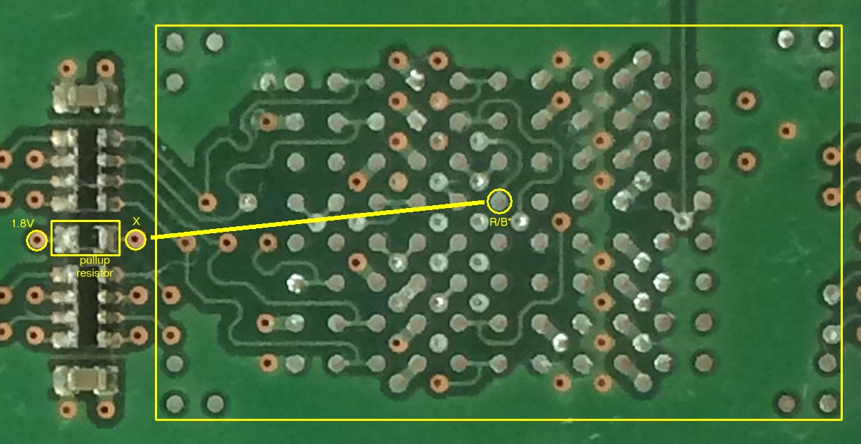

PostPosted: August 21st, 2023, 22:50
Posts: 17316

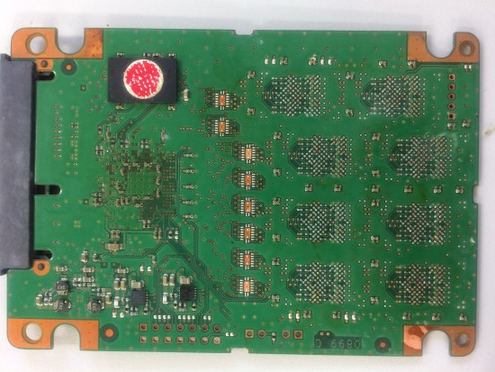

Show us a photo of the unpopulated PCB.
I would locate the Ready/Busy* pins of each IC. I expect that each pin will be connected to a pullup resistor. If so, then you can safely short this pin to ground (because it is open drain) while using PC3000 to scan for IDs. This should tell you which chip(s) is/are associated with a particular channel.

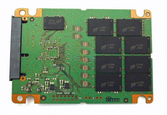

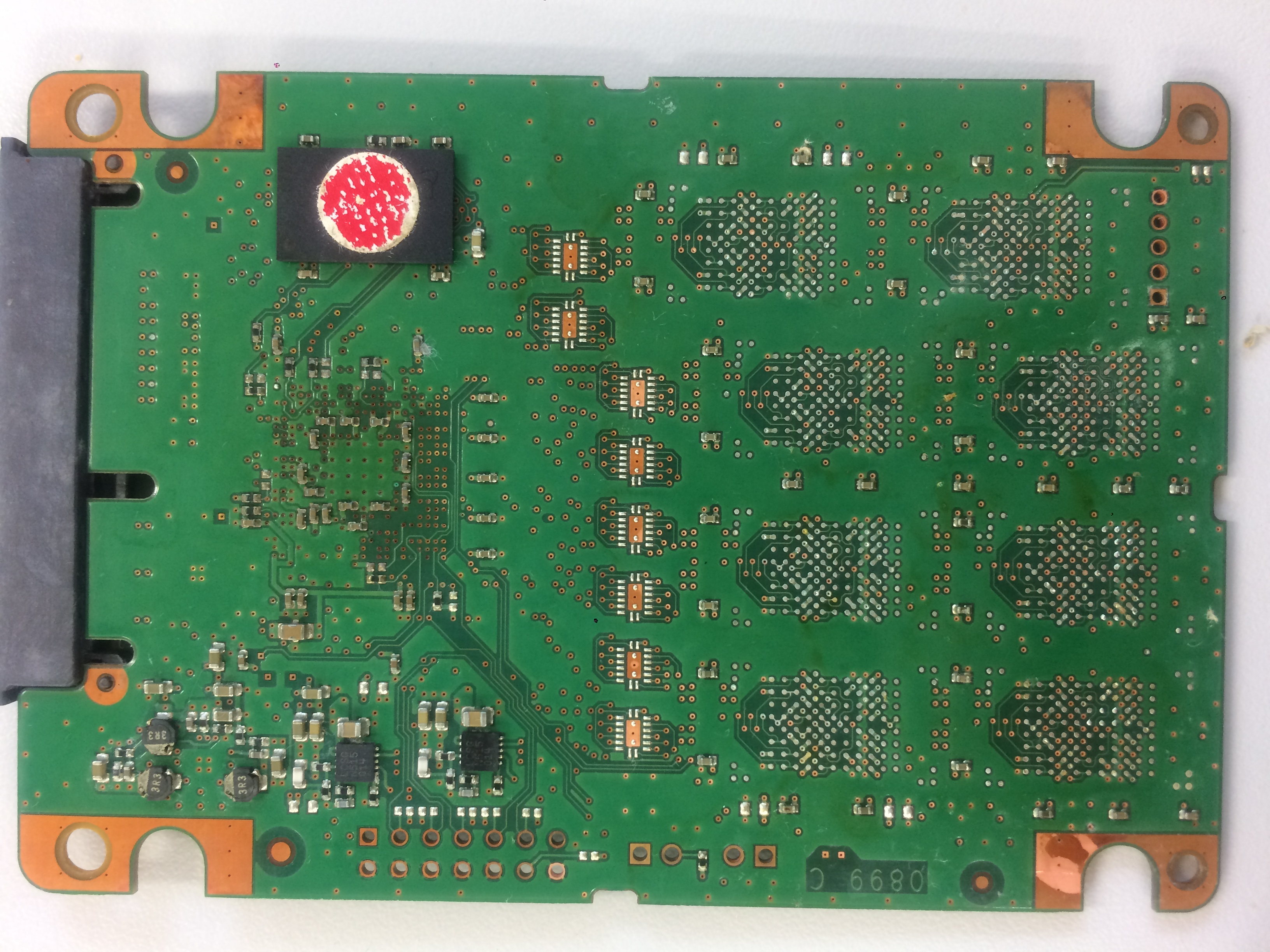

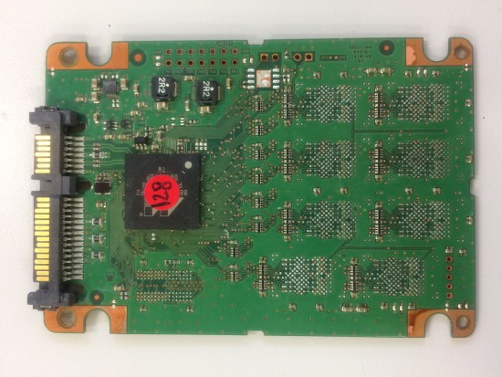

Sir you mean a picture of the PCB without NAND FLASH on it?
PostPosted: August 21st, 2023, 23:44
Joined: November 28th, 2021, 22:35
Posts: 162
Location: japan

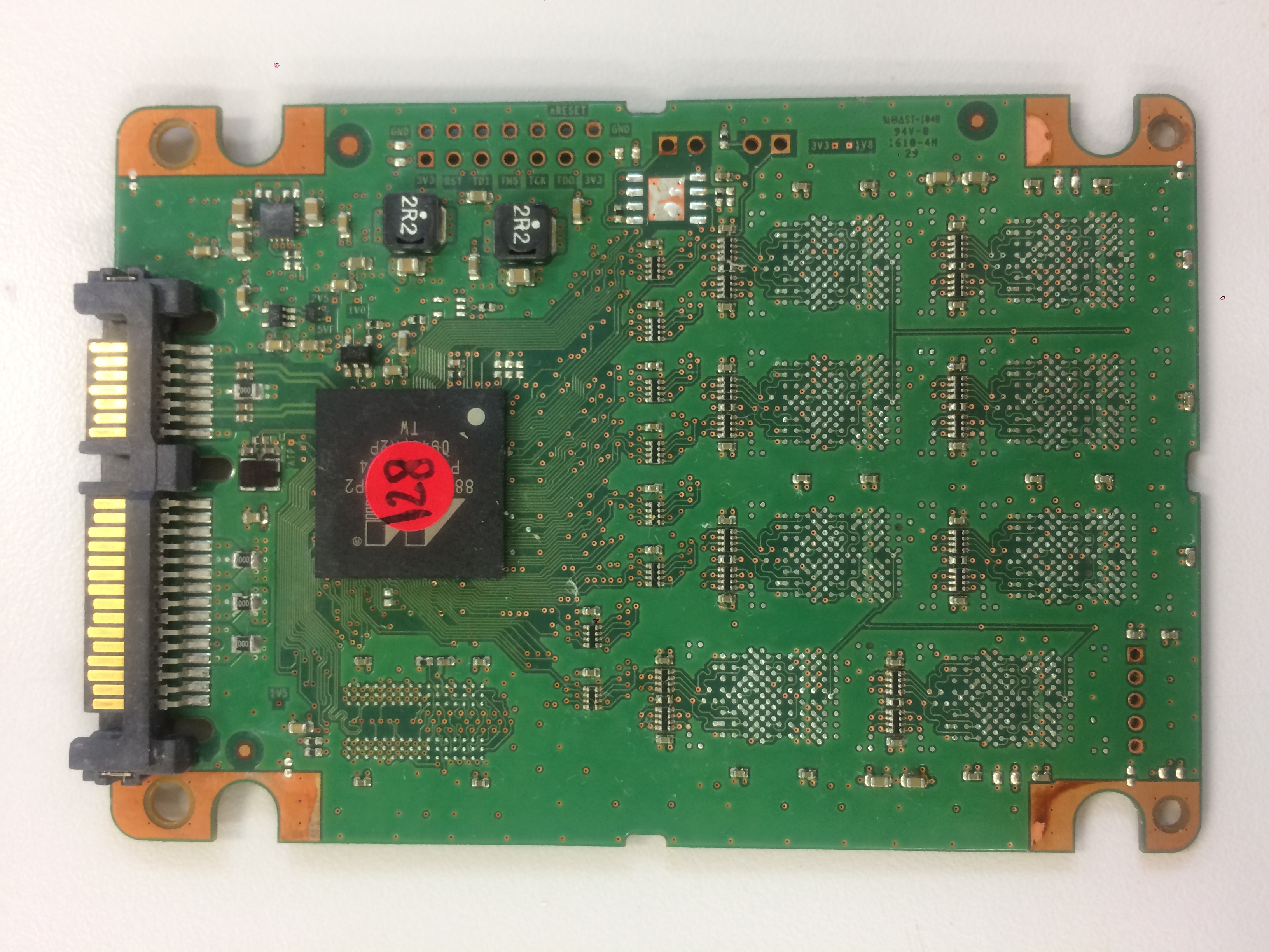

this is ok?

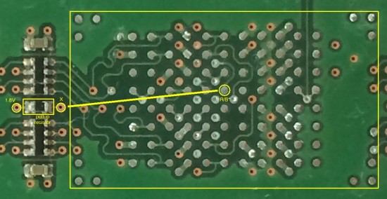

This is my guess for the Ready/Busy* logic.
I would confirm that the 1.8V end of the resistor is indeed at 1.8V. You could do this on the unpopulated PCB. There is also a 1.8V test point which you could use for this purpose.
Also confirm that the other end of the resistor (X) is indeed connected to the NAND's R/B* pin (continuity test on multimeter).
If all is OK, you can then short point X to ground during the ID check in PC3000. I expect that the corresponding channel will fail to ID, in which case this method should narrow down your candidates to 2.
PostPosted: August 22nd, 2023, 1:52
Posts: 17316
1. Check continuity on either donor or patient while powered off. It's probably better to do this on the 200 ohms range of your meter.
2. Ground is any screw hole. You can make a tiny probe with one end wired to ground and the other end wired to a sharp pointer. Then you can touch the pointer to point X while you are running your PC3000 ID check. Tweezers would be too big and risky.

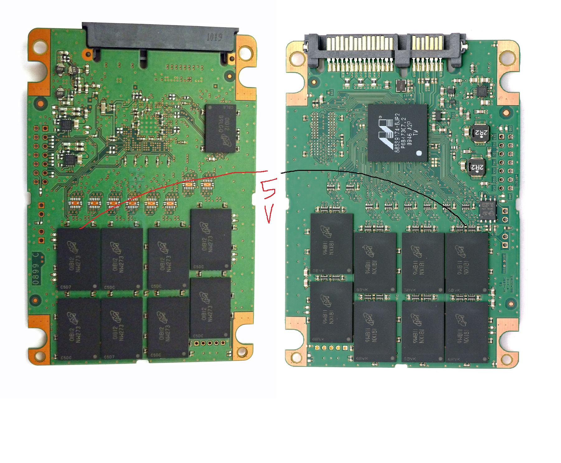

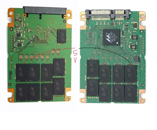

Sir on the side of the controller i got 5V......
PostPosted: August 22nd, 2023, 3:02
Posts: 17316
That means I'm wrong. What about the other side? Does it connect to R/B*?
PostPosted: August 22nd, 2023, 3:31
Posts: 162
Location: japan
what is R/B* means Sir?
back side also 5V
PostPosted: August 22nd, 2023, 3:41
Posts: 17316
Sorry, I don't think I can help you.
