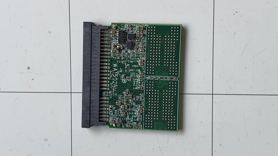

 Post subject: Wise CFast 2.0 256GB
PostPosted: September 13th, 2023, 8:01
Joined: September 4th, 2019, 2:25
Posts: 64
Location: Germany
Hello guys!
I have this Wise CFast 2.0. It is getting voltage and with short the PC3K is recognize the SSD with 4MB...
I ordered a new one to check the scematic layout but its a different PCB...
My problem is that i want to get the data, but the pc is not recognize the SSD.
I am not sure if its the controller or the NAND chips... i didnt find any shorts.. does anyone have any experience with a case like this?
Is reballing an option?
Thank you guys!
CFfast 2.jpg
CFfast 2.jpg [ 5.1 MiB | Viewed 6339 times ]
CFast 1.jpg
CFast 1.jpg [ 4.87 MiB | Viewed 6339 times ]
 Post subject: Re: Wise CFast 2.0 256GB
PostPosted: September 13th, 2023, 9:26
Joined: July 8th, 2019, 12:27
Posts: 162
Location: 中国大陆浙江省湖州市
http://www.flash-extractor.com/library/JMF/JMF670/
http://flash-matrix.com/
 Post subject: Re: Wise CFast 2.0 256GB
PostPosted: September 13th, 2023, 9:44
Joined: September 4th, 2019, 2:25
Posts: 64
Location: Germany
csava, Hello, how does this helping me?
 Post subject: Re: Wise CFast 2.0 256GB
PostPosted: September 13th, 2023, 10:12
Joined: July 8th, 2019, 12:27
Posts: 162
Location: 中国大陆浙江省湖州市
The only solution for this controller chip is chip off
http://flash-matrix.com/
 Post subject: Re: Wise CFast 2.0 256GB
PostPosted: September 14th, 2023, 1:42
Posts: 925
You need read chip at external reader and assembly the data. Usually swap or reballing not help, just makes bigger degradation of memory modules.
 Post subject: Re: Wise CFast 2.0 256GB
PostPosted: September 14th, 2023, 3:09
Joined: September 4th, 2019, 2:25
Posts: 64
Location: Germany
csava, arvika, thank you guys! I work with the PC3K Flash.. i hope they have a solution for it...
 Post subject: Re: Wise CFast 2.0 256GB
PostPosted: September 14th, 2023, 12:10
Posts: 925
Ihab wrote:
csava, arvika, thank you guys! I work with the PC3K Flash.. i hope they have a solution for it...
I'm sceptic, but you can try ;)
 Post subject: Re: Wise CFast 2.0 256GB
PostPosted: September 15th, 2023, 3:14
Joined: September 4th, 2019, 2:25
Posts: 64
Location: Germany
arvika, anything else to recomand?
 Post subject: Re: Wise CFast 2.0 256GB
PostPosted: September 15th, 2023, 10:03
Posts: 925
For this case probably Flash Extractor or VNR will be the best.
Users browsing this forum: jimmydata and 15 guests
