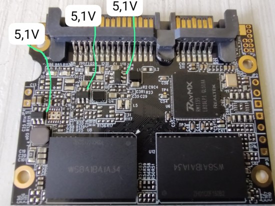

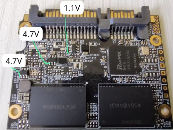

 Post subject: Kingspec Raymx RM1135 - No life signal
PostPosted: October 9th, 2023, 12:47
Joined: October 20th, 2017, 9:14
Posts: 124
Location: Brazil
Hello guys, good day.
I'm struggling with a SSD Kingspec Raymx RM1135, with no life signal. It does't turn on any status register when powered.
Made some measurements. Both three 6 pin mosfets are receiving 5.1V and delivering 4.7V (U17 and U4) and 1.1V (U18) on outputs.
Don't know what would be the next steps. If someone could please help me. Thank you for any answer.
ab5ac923-af86-41e6-ba6b-3fc5dd162c77.jpeg [ 195.13 KiB | Viewed 21499 times ]
 Post subject: Re: Kingspec Raymx RM1135 - No life signal
PostPosted: October 9th, 2023, 13:58
Posts: 17340
You have measured the inputs. Now measure the outputs.
 Post subject: Re: Kingspec Raymx RM1135 - No life signal
PostPosted: October 9th, 2023, 15:21
Joined: October 20th, 2017, 9:14
Posts: 124
Location: Brazil
fzabkar, Thanks for your reply.
Those are the outputs
WhatsApp Image 2023-10-09 at 16.20.12.jpeg
WhatsApp Image 2023-10-09 at 16.20.12.jpeg [ 192 KiB | Viewed 21461 times ]
 Post subject: Re: Kingspec Raymx RM1135 - No life signal
PostPosted: October 9th, 2023, 15:42
Posts: 17340
L1, L4 and L6 are the outputs. If you really are measuring 5V at the outputs, then the converter ICs are faulty.
 Post subject: Re: Kingspec Raymx RM1135 - No life signal
PostPosted: October 19th, 2023, 17:12
Joined: October 20th, 2017, 9:14
Posts: 124
Location: Brazil
Hello guys. I'm comming only to give a feedback.
I've found that one capacitor was shorted and switched it from another equal ssd, and it worked flawless.
Thank you so much fzabkar, as allways a very kind help.
 Post subject: Re: Kingspec Raymx RM1135 - No life signal
PostPosted: January 24th, 2024, 9:46
Joined: January 24th, 2024, 9:30
Location: brasil
amigo qual o capacitor,to tendo o mesmo problema
 Post subject: Re: Kingspec Raymx RM1135 - No life signal
PostPosted: May 22nd, 2024, 1:13
Joined: May 22nd, 2024, 0:56
Location: Karachi
i have same as this 2tb.. bios and windows detecting properly, problem is ssd showing multiple size (1GB+,2GB, 4GB, 8GB, 16GB, 1.8TB) 16 patitions unformated some unallocated space, over all not all accessible... (Hard disk Sentinel) application working on it, report is read Test 100% ok, write test 0% when i start write test ssd hide from every ware, like ghost. when i restart my computer, again showing same as before.... kindly tell me solution
 Post subject: Re: Kingspec Raymx RM1135 - No life signal
PostPosted: August 15th, 2024, 5:57
parmindo wrote:
Hello guys, good day.
I'm struggling with a SSD Kingspec Raymx RM1135, with no life signal. It does't turn on any status register when powered.
Made some measurements. Both three 6 pin mosfets are receiving 5.1V and delivering 4.7V (U17 and U4) and 1.1V (U18) on outputs.
Don't know what would be the next steps. If someone could please help me. Thank you for any answer.
Hi ,
Anyone knows safe mode short pins on this
