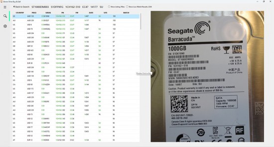

 Post subject: Donor Drive App
PostPosted: October 31st, 2023, 1:56
Posts: 487
This app automatically searches ebay for matching donor drives.
donor-drive-buy-app-2-results.jpg [ 254.64 KiB | Viewed 31162 times ]
We have eliminated the boring and time consuming process of manually searching ebay for donor hard drives.
The app is free.
We are launching this in pre-release beta for testing, user feedback and bug reporting
Download: https://www.zeroalpha.com.au/donor-drive-app
With the price of some donor drives now exceeding $600 this app can find and match all the low price unlisted bargains by using an add on image search application from Google.
Write me back here for any questions and we hope to continue to improve the product if you guys find it useful :)
Zero Alpha: zeroalpha.com.au
Find Cheap Donor Drives App: https://www.zeroalpha.com.au/donor-drive-app Updated February 2026
 Post subject: Re: Donor Drive App
PostPosted: October 31st, 2023, 5:11
Posts: 3548
That's awesome!
I'll be sure to check it and give feedback!
 Post subject: Re: Donor Drive App
PostPosted: October 31st, 2023, 6:00
Posts: 548
Location: brisbane
Zero Alpha wrote:
This app automatically searches ebay for matching donor drives.
We have eliminated the boring and time consuming process of manually searching ebay for donor hard drives.
The app is free.
We are launching this in pre-release beta for testing, user feedback and bug reporting
Download: https://www.zeroalpha.com.au/donor-drive-app
With the price of some donor drives now exceeding $600 this app can find and match all the low price unlisted bargains by using an add on image search application from Google.
Write me back here for any questions and we hope to continue to improve the product if you guys find it useful :)
Thanks Zero Alpha for all the efforts.
I have just visited your website & found other useful technical references too. I will check it & update you.
Pls.keep me active on mailing list for future releases and other tech info.
 Post subject: Re: Donor Drive App
PostPosted: October 31st, 2023, 15:09
Posts: 1744
Location: Verona, Italy
Python is required, otherwise will not be possible to install app.
Last python version is 3.12 which works only with Win 8.1 or higher, the minimum python version needed for this app is 3.11 (which also works only on Win 8.1 and above).
My firmware database:
 Post subject: Re: Donor Drive App
PostPosted: November 6th, 2023, 19:41
Posts: 487
michael chiklis wrote:
Python is required, otherwise will not be possible to install app.
Last python version is 3.12 which works only with Win 8.1 or higher, the minimum python version needed for this app is 3.11 (which also works only on Win 8.1 and above).
The app is a stand alone .exe file. This shouldn't be the case but curious to see what is happening here
Zero Alpha: zeroalpha.com.au
Find Cheap Donor Drives App: https://www.zeroalpha.com.au/donor-drive-app Updated February 2026
 Post subject: Re: Donor Drive App
PostPosted: November 6th, 2023, 19:46
Posts: 487
Here is a youtube video showing how to install and use the donor drive app
https://youtu.be/Zg5U-q7-dIc
Zero Alpha: zeroalpha.com.au
Find Cheap Donor Drives App: https://www.zeroalpha.com.au/donor-drive-app Updated February 2026
 Post subject: Re: Donor Drive App
PostPosted: November 7th, 2023, 7:25
Posts: 3548
It's brilliant. One problem I've found is that sorting on the results didn't work properly. I tried to sort results by price and nothing happened. Other than that, perfect :cool:
 Post subject: Re: Donor Drive App
PostPosted: November 8th, 2023, 7:17
Posts: 1744
Location: Verona, Italy
Zero Alpha wrote:
michael chiklis wrote:
Python is required, otherwise will not be possible to install app.
Last python version is 3.12 which works only with Win 8.1 or higher, the minimum python version needed for this app is 3.11 (which also works only on Win 8.1 and above).
The app is a stand alone .exe file. This shouldn't be the case but curious to see what is happening here
The 1st error message it returns to me is identical, the second one is very similar
https://answers.microsoft.com/it-it/win ... e281cbf02b
This is the exact 2nd error message that your app returns
Immagine.png [ 34.72 KiB | Viewed 30360 times ]
As usual, the solutions reported on microsoft community are never helpful, in fact they do not solve the problem.
My firmware database:
 Post subject: Re: Donor Drive App
PostPosted: November 20th, 2023, 1:58
Posts: 487
northwind wrote:
It's brilliant. One problem I've found is that sorting on the results didn't work properly. I tried to sort results by price and nothing happened. Other than that, perfect :cool:
Thanks for the feedback. The app uses a free public forex currency converter to display prices in your local currency. Similar to many free public services, it frequently goes offline, causing the app to lose its ability to sort by prices, thus ruining the user experience.
I'll make this a priority to fix it.
Zero Alpha: zeroalpha.com.au
Find Cheap Donor Drives App: https://www.zeroalpha.com.au/donor-drive-app Updated February 2026
 Post subject: Re: Donor Drive App
PostPosted: November 20th, 2023, 2:26
Posts: 487
The 1st error message it returns to me is identical, the second one is very similar
https://answers.microsoft.com/it-it/win ... e281cbf02b
This is the exact 2nd error message that your app returns
As usual, the solutions reported on microsoft community are never helpful, in fact they do not solve the problem.
Thanks for sharing! I see your problem now! You are using Windows 7 which Microsoft ended support for. Unfortunatley this app will not work with legacy Windows.
Zero Alpha: zeroalpha.com.au
Find Cheap Donor Drives App: https://www.zeroalpha.com.au/donor-drive-app Updated February 2026
 Post subject: Re: Donor Drive App
PostPosted: November 20th, 2023, 6:09
Posts: 1744
Location: Verona, Italy
That's right, i use Win7
I will build new PC with Win11 soon, thanks.
My firmware database:
Users browsing this forum: No registered users and 46 guests
