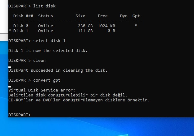

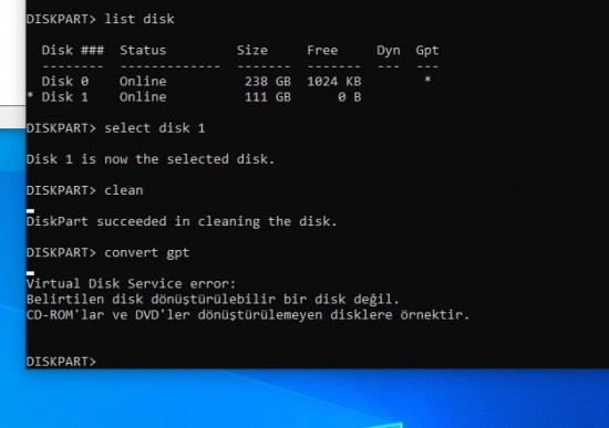

hi guys
I have a disk biostar brand model name INIC6081SSDWP and fw : INICWP00
I cannot format this disk.
I tried to make gpt with diskpart but it didn't allow it either.
It gives a warning that the specified disk is not a convertible disk :(
I tried everything and realized that it is locked.
If I update the firmware to this disk, will it be fixed?
Where can I get the firmware and with which program can I flash it????

 Post subject: Re: Kingstone CP33238B satafirm s11
PostPosted: November 7th, 2023, 2:33
Posts: 411
Location: Romania
magnetepazzo wrote:
Hi guis I have this kingston unit, it's first unit for me, how can it's possible to recover data from this product ? Thanks
As far as I know you have MRT tool....Give it a try. In SSD section you have a utility -Kingston2(Phison)-Enter the utility and wait until it finish it's job. Create translator and start to recover data with DE .
Rgds
www.datasave.ro
