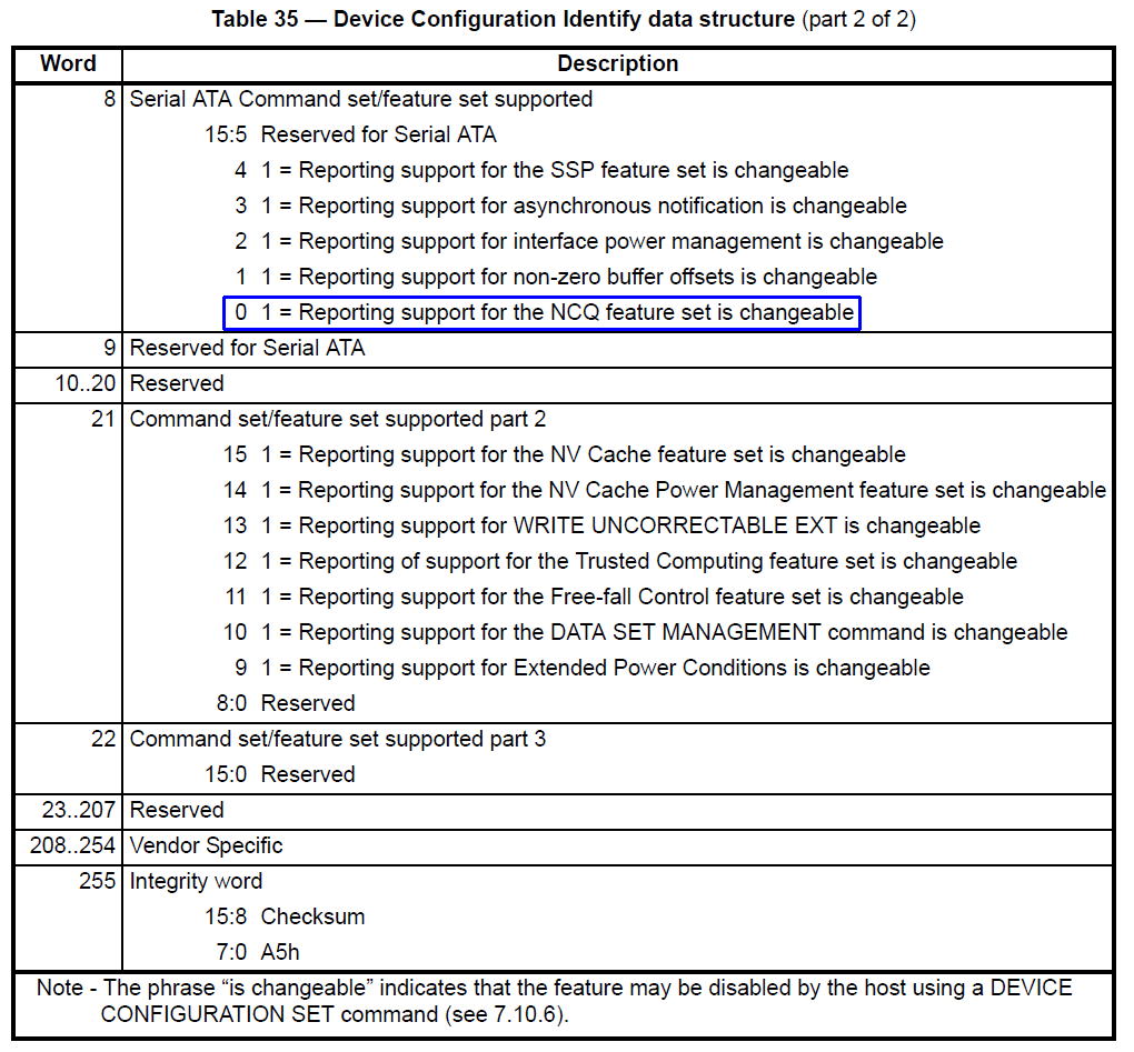

Can you dump the Device Configuration Overlay (DCO) information using HDAT2? The solution may be as simple as flipping the NCQ Feature Set Supported bit in word 76.

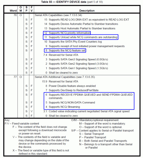

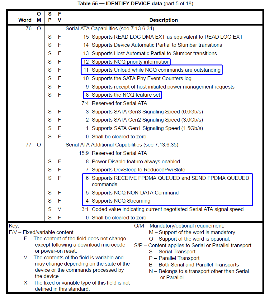

I think these are the relevant excerpts from the ATA standards. I could be wrong, though.

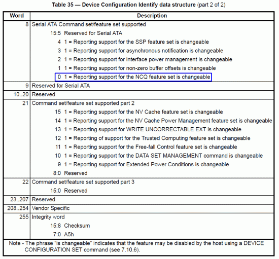

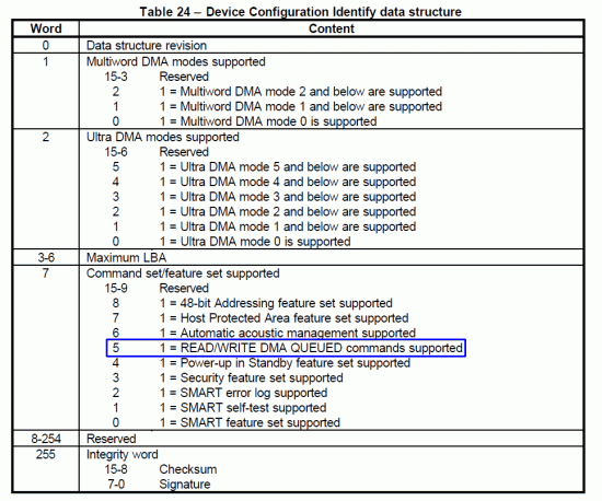

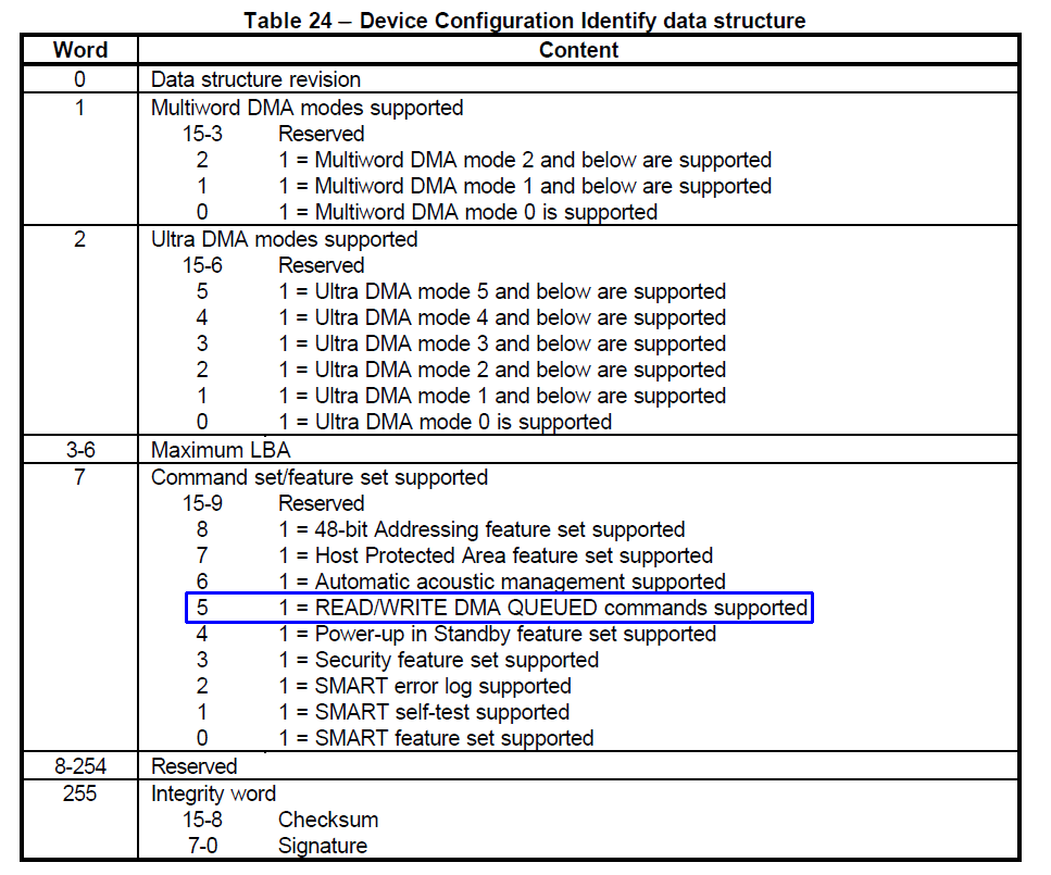

This is an excerpt from a later standard:
https://web.archive.org/web/20160701095638/http://www.t13.org/documents/UploadedDocuments/docs2011/d2015r7-ATAATAPI_Command_Set_-_2_ACS-2.pdf

Identify Device word #76 has a value of 0x840E. This means that the NCQ features were disabled for this drive.
