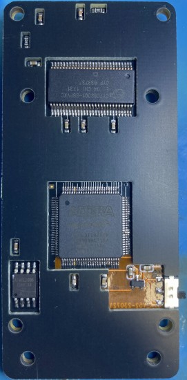

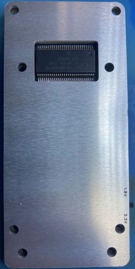

 Post subject: Flash Extractor Reader Low Voltage Modification Patch
PostPosted: July 27th, 2023, 4:47
Joined: July 8th, 2019, 12:27
Posts: 162
Location: 中国大陆浙江省湖州市
https://www.youtube.com/watch?v=eIFhLcDbNi0&t=8s
The principle behind this patch is to modify the perception capability of the Reader unit towards low voltage signals, rather than relying on an external level-shifting chip. About six months ago, I attempted to address reading VCCQ 1.8-1.2 Low VCCQ NAND Flash by creating additional adapters. However, on certain chips, this approach significantly reduced the reading quality. I cannot tolerate such results, so despite producing dozens of these adapters in small batches, they are all sitting unused in a corner now. The current solution I have developed is the best one I have tried so far. With the modified Reader, certain chips like 45 3C 98 B3 achieve a more stable dump quality compared to the original Reader.
If you are interested in this patch, you can find it on my website.
2023_07_26_21_16_IMG_2334.jpg [ 872.11 KiB | Viewed 13986 times ]
2023_07_26_18_16_IMG_2333.jpg [ 4.42 MiB | Viewed 13986 times ]
2023_07_26_18_16_IMG_2332.jpg [ 4.3 MiB | Viewed 13986 times ]
http://flash-matrix.com/
 Post subject: Re: Flash Extractor Reader Low Voltage Modification Patch
PostPosted: July 27th, 2023, 14:00
Joined: September 23rd, 2019, 2:55
Posts: 112
This is very cool mod, but I see that it is required to desolder the FPGA and solder again. If it's work that good news :) I quick check and this old Altera Cyclone also use 1,5V and 2,5V for VCCIO, saddy no 1.2V - this voltage is support form Cyclone III :( But if only 1.8V do the work, I am interested in this modification.
 Post subject: Re: Flash Extractor Reader Low Voltage Modification Patch
PostPosted: December 18th, 2023, 14:08
Joined: April 18th, 2020, 8:29
Posts: 13
Flash extractor power adapter v3 required
Adapter_Power (1).gif
Adapter_Power (1).gif [ 20.71 KiB | Viewed 10087 times ]
