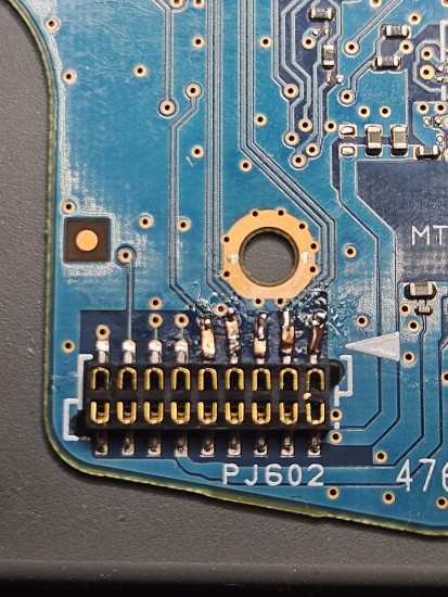

Hey Guys
Anyone willing to share how to hardware block the write channel on a MQ04ABF100.
I tested with a donor PCB yesterday with the two sets of lines from controller to connector.
I assumed the write channel is the line with voltage, but tried both set anyway.
After cutting the drives just hangs on BSY.
I repaired the lines after and the PCB boots up fine, so its not that I caused other damage cutting them.
Image attached of the lines cut and tested.
Not pretty as its was just an experiment.
Anyone willing to share?
Tim

You need to find the Write Gate and disable it.
Here is a Seagate example:
https://www.hddoracle.com/viewtopic.php?p=22105#p22105
"PA_WRE - write enable"

See the "-WG" test point on this old PCB (Write Gate, active low, top left corner, near cutout):
https://www.hddoracle.com/download/file.php?id=88&mode=view
https://www.hddoracle.com/viewtopic.php?p=135#p135

Here is another possibility (Toshiba MK2016GAP):
https://bugworkshop.blogspot.com/2020/07/toshibamk2016gap-20gb-hard-disk-drivepcb.html
It has a discrete R/W Channel IC -- Marvell 88C4210.
Not much info here (as is usually the case with Marvell):
https://www.digchip.com/datasheets/download_datasheet.php?id=95107&part-number=88C4200
However, page 155 of this patent has a pinout:
https://patentimages.storage.googleapis.com/e6/9c/f6/d1ac4d3e7e2509/WO2004100131A2.pdf
