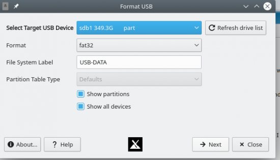

 Post subject: USB external Seagat SATA drive. RAW and unallocated
PostPosted: December 31st, 2023, 17:05
Joined: December 31st, 2023, 16:53
Posts: 13
Location: west coast us
thanks in advance
I just found an old Seagate external USB drive. I am wondering if something went wrong with its power supply as it did not show up on either my linux box or my windows box when plugged in. The plug itself looked wonky with one of the male parts being loose. I think someone tried to cram it into an over crowded AC outlet and it shorted or something like that....
I took it apart, taking the raw drive out of the plastic and caddie. I put a aftermarket USB power supply and all of that on it and have plugged it into a linux box and a windows box. I think, but am not certain, that it had music and pictures on it.
facts:
1. Does snot show up in linux or windows file managers when installed.
2. Does show up in Disk management app of windows and linux.
3. Linux disk management shows it as being about half RAW and half unallocated. hmmm.... sounds like it might have had two partitions ? I think back in the day I did a FAT32 and an ext3 but do not recall for sure...
4. I can post screenshots of anything that might help you.
5. I ran the old seatools and it says the disk is healthy using the quick and fast tests.
So,,, really I am just wondering if it somehow got borked and there might be data on it or if it is entirely safe to format to ext4 with my Linux box and use it. I don't want to lose pics of kids or music if there were / are files before a possible short or other incident.
Thanks !
Linux USB format app.png
Linux USB format app.png [ 32.77 KiB | Viewed 2317 times ]
Linux USB format app.png
Linux USB format app.png [ 32.77 KiB | Viewed 2317 times ]
 Post subject: Re: USB external Seagat SATA drive. RAW and unallocated
PostPosted: January 1st, 2024, 18:28
Joined: July 2nd, 2011, 14:16
Posts: 463
Can you post some pictures of the original drive PCB and also the USB interface adaptor. Perhaps the adapter can be fixed and that can read the drive as normal.
Also does the drive start as normally?, like can you hear it start up and not make any strange clicking sounds and spin normally?
 Post subject: Re: USB external Seagat SATA drive. RAW and unallocated
PostPosted: January 1st, 2024, 19:13
Posts: 17335
Same case ...
https://forum.hddguru.com/viewtopic.php?f=1&t=43957
 Post subject: Re: USB external Seagat SATA drive. RAW and unallocated
PostPosted: January 3rd, 2024, 2:01
Joined: December 31st, 2023, 16:53
Posts: 13
Location: west coast us
Yes. this thread was being ignored like a redheaded stepchild and the other post took over as the moderator was kind enough to say that he had seen this post while it was in limbo and responded with help in the other thread
- delete this one ? Seems like they should be merged here as the other subject will get no attention at all ?
Users browsing this forum: Google [Bot] and 38 guests
