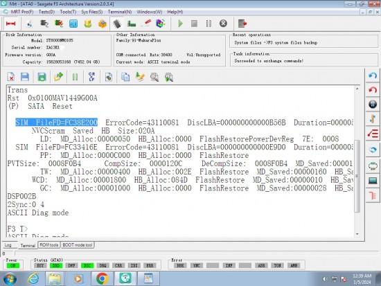

 Post subject: 8tb seagate
PostPosted: January 5th, 2024, 4:41
Posts: 153
Location: Karachi
hi
need help,
what is this error, how to solve
thanks
456.jpg [ 284.48 KiB | Viewed 10574 times ]
Users browsing this forum: No registered users and 1 guest
