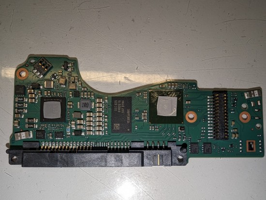

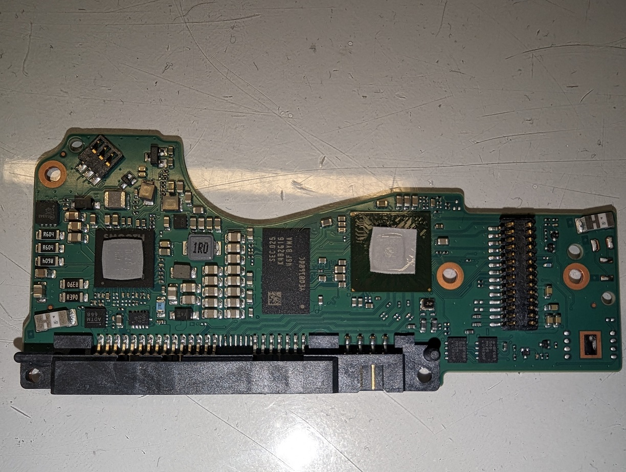

Hello fzabkar, this is the ROM i initially readed via bootcode and terminal via PC3K.
I was not aware that there are 2 ROMs. So i checked the PCB and yes, those 2 small little ones right beside the heads connector are most likely the ROM-Chips (see the attachment).
Any idea how to read both? I think they are too small for our pin reader / programmar.
 Post subject: Re: Seagate Exos 16TB ST16000NM001G
PostPosted: February 29th, 2024, 15:59
Posts: 17225
The chips are 16Mbit (2MB) memories. I wonder what would happen if you told PC3K to dump a 4MB ROM instead of 2MB? Would that work, or would it just dump the first ROM twice?

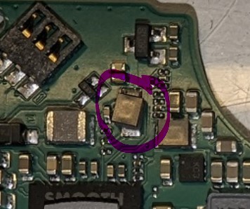

FWIW, I noticed this:
