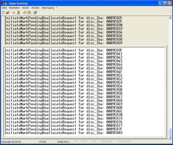

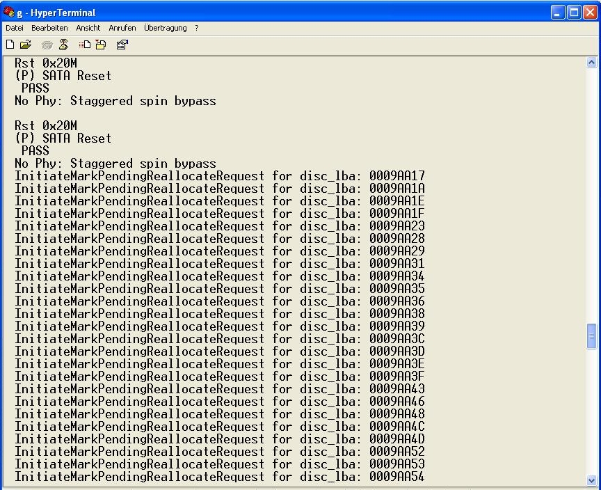

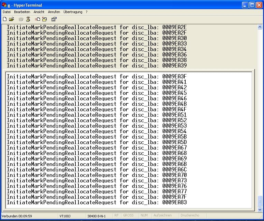

- after SMART-reset i got this output in terminal, any ideas how to fix this drive?:

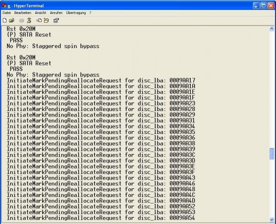

i executed the "ST_congen4"-script from here: https://www.hddoracle.com/viewtopic.php?p=10886#p10886
Now i get a message while starting:
Drive AMPS Configuration has been modified from compiled defaults.
Drive must be re-initialized to controller firmware defaults by re-downloadingcontroller firmware
But i still get also the "Initiate Mark Pending Reallocate Request for disc_lba:"-messages after startup.
What to do now?
 Post subject: Re: No TTL-connection to Seagate HDD
PostPosted: August 12th, 2023, 20:08
Posts: 4816
i vote for a weak head...

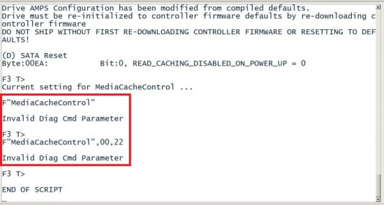

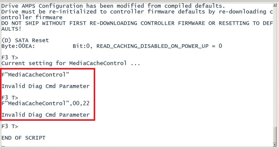

i tried the script a second time and noticed that it didn't finish complete, look what:
So i guess some commands are unknown for the drive and the script stops at this point and can't finish?
