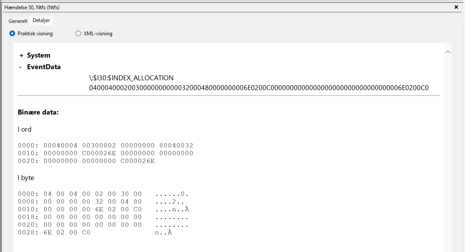

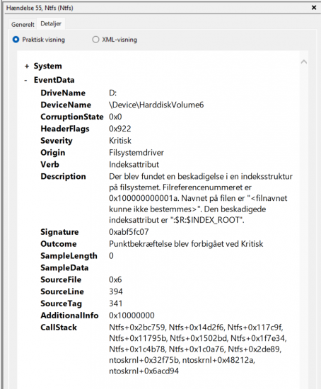

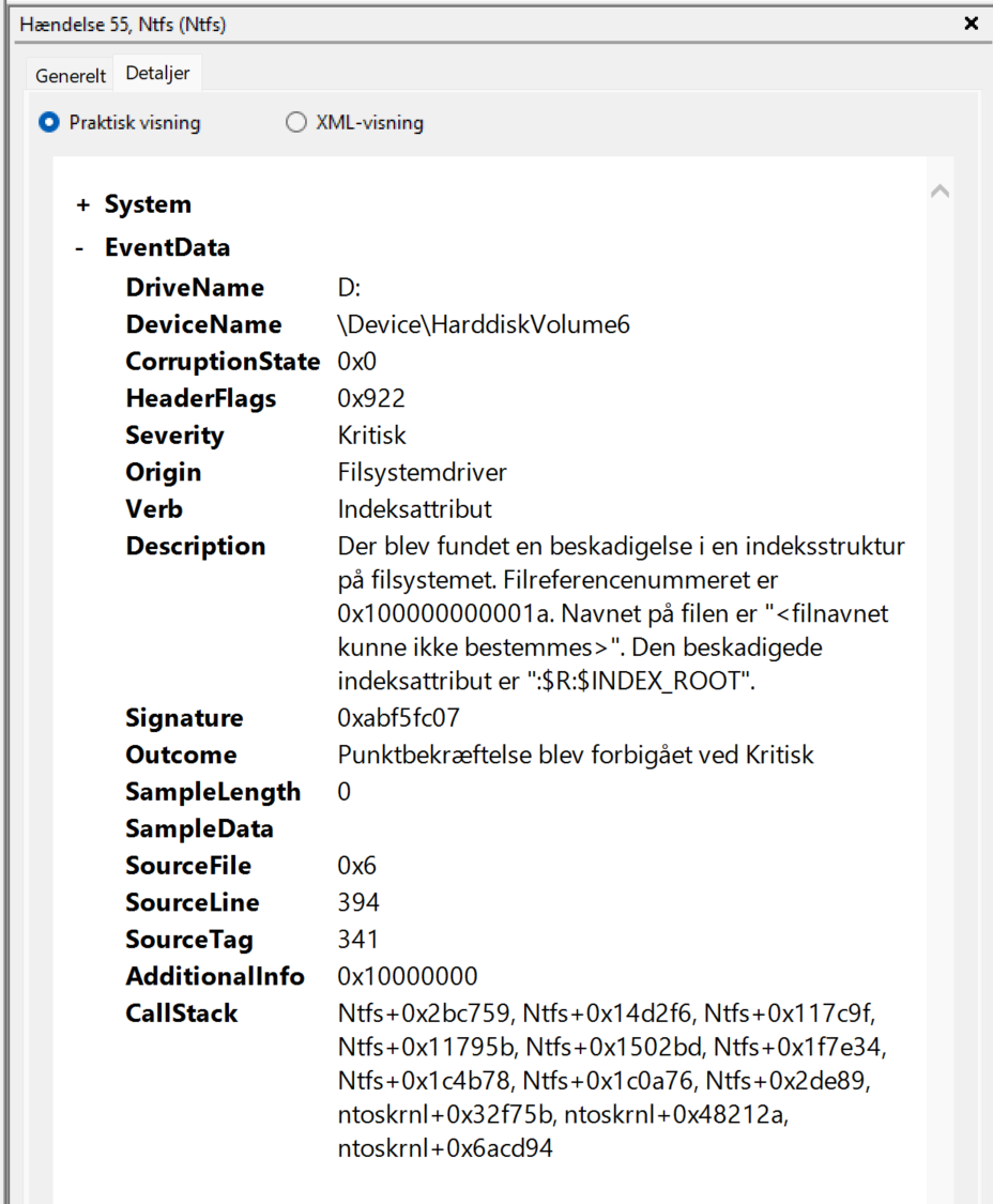

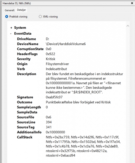

Windows Event Viewer reports:
Event ID 55:
Corruption in:
$R:$INDEX_ROOT
The file reference points to MFT record 26, which DMDE identifies as:
$Extend\$Reparse

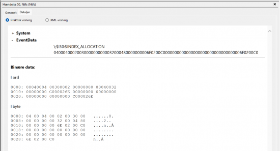

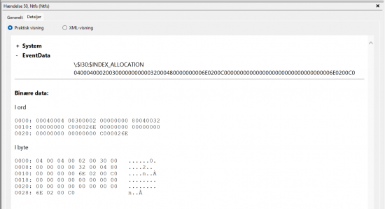

Event ID 50:
Delayed Write Failed for:
$I30:$INDEX_ALLOCATION
In DMDE, MFT record 26 contains:
- $INDEX_ROOT:$R
- $INDEX_ALLOCATION:$R, size 16384 bytes
- $BITMAP:$R, value 0F 00 00 00 00 00 00 00
The bitmap therefore appears to mark four 4096-byte INDX blocks as allocated, matching the 16384-byte INDEX_ALLOCATION size.
DMDE does not show obvious red logical errors, and the directory repair function is unavailable for this special system index.
