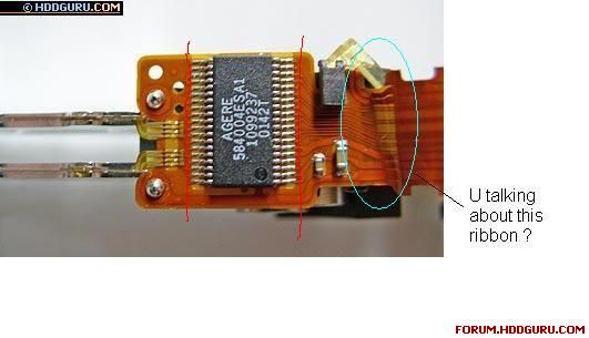

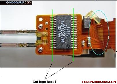

 Post subject: Maxtor swaping heads - what model is THE ONE
PostPosted: March 26th, 2007, 6:02
Joined: March 23rd, 2007, 14:52
Posts: 9
I really know that some of you guys have already written this, but allow me to ask you once again. I got this Maxtor DiamondMax Plus 9, 6Y080LO, firmware YAR41BWO, NGBA with lost preamp on heads and really would like to know what models I can use to take out healthy heads and use for pulling out the data from my disk. What about models 6Y080M0 or others.
Veni K.
 Post subject:
PostPosted: March 26th, 2007, 13:14
Posts: 637
Location: Canada
This article should be helpful: Head stack.
 Post subject:
PostPosted: March 26th, 2007, 18:40
Posts: 4806
first I would probably replace the bad preamp, because there is a risk of heads' misalignment if U swap the MHA.
 Post subject:
PostPosted: March 27th, 2007, 8:49
Joined: March 23rd, 2007, 14:52
Posts: 9
I appreciate your answers. Would you advice me on following:
1. Maxtor DiamondMax Plus 9 series 6Y080
Mine is 6Y080L0
Can I use heads from the model 6Y080M0
2. What is easier to do:
Swap heads or swap media
I am fully aware about the problem in aligement
 Post subject:
PostPosted: April 6th, 2007, 6:31
Posts: 1079
Location: canada
pepe wrote:
first I would probably replace the bad preamp, because there is a risk of heads' misalignment if U swap the MHA.
you can not replace the preamp chip on the hard drive
as this is connected to the head inside and is on wafer
so it will burn right away
only way is a head swap
unless im missing something here ????
 Post subject:
PostPosted: April 6th, 2007, 7:36
Posts: 4806
craig6928 wrote:
unless im missing something here ????
yes, U are surely missing something :lol:
For Calypsos with preamp burned the best solution is to replace the preamp (and it is the same with other Maxtor and quantum drives too). At least I found it the best, since head alignment would change if U replace the whole MHA and it is critical in most of these drives, probably it will not like the new stuff :))
Of course preamp replacement is also critical since one can easily damage the otherwise useable heads without proper technology and knowledge.
regards,
 Post subject:
PostPosted: April 8th, 2007, 2:51
Joined: October 1st, 2006, 6:29
Posts: 107
hi pepe, you got the point there..Maxtor or WD are too sensitive for HDA exchange...some Maxtor preamp chips are fused to the board no pins exposed to desolder, how you go about changing it? cut the flexible ribbon cable and solder the ribbon cable with good preamp?
feedback appreciated.
 Post subject:
PostPosted: April 9th, 2007, 12:09
Posts: 4806
Here the question was about calypso drives, those have SMD preamps 'easily' changeable.
regards,
 Post subject:
PostPosted: April 10th, 2007, 10:08
Joined: April 10th, 2007, 9:53
Posts: 335
Pepe, how many sets of hands do you have, and what kind of soldering station are you using to be able to desolder the preamp, and remount a new one without damaging any peripherals? Hats off to you.
 Post subject:
PostPosted: April 10th, 2007, 14:56
Posts: 2288
Location: In ur HDD !
yes that confuses me too because beneath the preamp there is a plastic wire that might melt if u use hot station so what do u use to replace the preamp ?
 Post subject:
PostPosted: April 14th, 2007, 21:54
Joined: November 15th, 2005, 11:05
Posts: 189
Location: Canada
That is easy answer, though not easy in practice. Cut donor from ribbon (by cutting ribbon) & desolder, cut legs on dead chip & be quick & gentle with soldering, 12v & grounded as these IC's are sensitive to ESD. You can use 3M fineline blue tape to hold chip on ribbon while you solder. Microscope is useful also. :D
I think ST is a sub company of Lucas
 Post subject:
PostPosted: April 15th, 2007, 4:16
Posts: 2288
Location: In ur HDD !
Thanks for reply ur talking this ribbon :
from where do i cut the ribbon and how do i join back .
 Post subject:
PostPosted: April 19th, 2007, 9:14
Joined: November 15th, 2005, 11:05
Posts: 189
Location: Canada
yes use Xacto knife or razor to cut the good pream chip off your donor then de-solder legs, as you are only after the chip. then cut the legs off of the dead pre-amp chip to remove. If you are careful you can solder your donor agere chip to the trimmed legs or gently heat & remove them first. You need low heat & be grounded as they are VERY sensitive to ESD. Image
you can buy these agere chips new also but the only supplier I have found has $500.00 US minimum order :shock:
easier to cut off a donor
I think ST is a sub company of Lucas
 Post subject:
PostPosted: April 19th, 2007, 9:19
Joined: November 15th, 2005, 11:05
Posts: 189
Location: Canada
sorry red wasn't best color, To be clear you don't try and splice the ribbons you cut it to make it easier to remove the donor chip intact
I think ST is a sub company of Lucas
 Post subject:
PostPosted: April 19th, 2007, 12:04
Joined: April 10th, 2007, 9:53
Posts: 335
Are you using an air soldering station for this? What temp are you using?
 Post subject:
PostPosted: April 19th, 2007, 13:09
Posts: 2288
Location: In ur HDD !
Thanks for reply yes i think that would be the best thing to do .
Very clever Shortscurcuits.
 Post subject:
PostPosted: April 21st, 2007, 22:22
Joined: November 15th, 2005, 11:05
Posts: 189
Location: Canada
Hi, no I use low temp 12 v solder gun & microscope, you could hot air the donor off the ribbon, but hot air would melt the plastic on the ribbon, it's better to use a fine tipped iron for the replacement
I think ST is a sub company of Lucas
 Post subject:
PostPosted: April 22nd, 2007, 7:24
Posts: 2984
Very interesting topic :D
 Post subject:
PostPosted: April 23rd, 2007, 12:11
Posts: 637
Location: Canada
Shortscurcuits wrote:
cut the legs off of the dead pre-amp chip to remove.
Interesting. That's a good point. It's easier to solder to the cut-off legs than to the pads. Also, you don't have to heat the ribbon twice. Will try that method. Thanks.
PS: You mean cut legs here, right?
 Post subject:
PostPosted: April 24th, 2007, 18:05
Posts: 4806
I don't use hot air, that would be definitely harmful.
but I use radiated heat (like infrared).
This way it takes about 5 minutes to desolder and 10 to solder back the preamp :)
qtd4242: I have only 2 hands, I mean one set 8)
Users browsing this forum: No registered users and 196 guests
