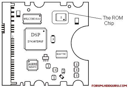

 Post subject: ROM 4D0
PostPosted: April 10th, 2007, 15:46
Posts: 2288
Location: In ur HDD !
I got a across a many 4D040h2 drives something really confused me i had seen in some drives there were ROM chip and in some drives i did not see any ROM chip . How can they possibly function without the ROM chip ?
Below attached is a picture of the ROM chip .
Thanks .
 Post subject:
PostPosted: April 10th, 2007, 21:07
Joined: October 7th, 2005, 2:03
Posts: 152
Location: serbia
Rom is integrated in DSP....
Users browsing this forum: No registered users and 189 guests
