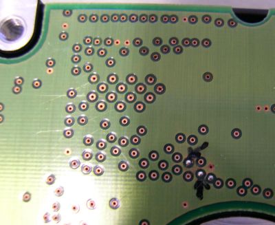

 Post subject: where are Password removal pins on HTS726060M9AT00 ?
PostPosted: August 26th, 2007, 22:34
Posts: 1238
Location: inside ROM
Hi gurus
Where are the pins to remove password on HTS726060M9AT00? is it the same as HTS548 ? i can't seems to get it working....anyone got photo for HTS726060M9AT00 pins?
 Post subject: Re: where are Password removal pins on HTS726060M9AT00 ?
PostPosted: August 27th, 2007, 1:06
Posts: 1238
Location: inside ROM
Did as shown on photo, jumpered pins with arrows, and follow instructions on screen but still does not unlock. :cry:
DSCN1320.JPG [ 327.02 KiB | Viewed 3680 times ]
 Post subject: Re: where are Password removal pins on HTS726060M9AT00 ?
PostPosted: August 27th, 2007, 10:46
Joined: May 21st, 2007, 16:10
Posts: 1592
Location: Gothenburg/ Sweden
Hi there,
It's the right place, and you should use your probe not a jumper.
What version do have of your pc3000? Real ACE or chinese crap?
Bosse
http://www.rescue-it.se
 Post subject: Re: where are Password removal pins on HTS726060M9AT00 ?
PostPosted: August 27th, 2007, 21:23
Posts: 1238
Location: inside ROM
got it working thanks all, one of the probe component is not connected properly.
Users browsing this forum: Google [Bot], Majestic-12 [Bot] and 165 guests
