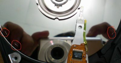

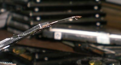

 Post subject: Seagate ST320014A
PostPosted: October 6th, 2007, 4:16
Joined: October 6th, 2005, 3:00
Posts: 657
Here I got one Seagate 20 GB Useries X ST320014A
Drive got knocking Sound after opened found head have been damaged ( see My Picture )
I take a see with its platter and a little scracthed in its platter. See My Pic for detail.
I have change head from A good donor drive. but drive got no detect and still knock.
I return back donor head and got nothing problem just in second drive got detect as well.
please give me advise. is it possible with this problem
and what is the scracthed area. is it SA ZONE ot not. I am affraid Boot Code in SA have damaged. please give addvise
platter damaged.jpg
platter damaged.jpg [ 202.02 KiB | Viewed 3781 times ]
damage head.jpg
damage head.jpg [ 91.93 KiB | Viewed 3779 times ]
Спасибо
СУТИОНО / АПИНГ
 Post subject: Re: Seagate ST320014A
PostPosted: October 6th, 2007, 4:29
Posts: 1238
Location: inside ROM
SA damaged, unfortunately nothing can be done
 Post subject: Re: Seagate ST320014A
PostPosted: October 7th, 2007, 22:49
Joined: October 6th, 2005, 3:00
Posts: 657
thanks You friend...
I will stop this recovery process
Спасибо
СУТИОНО / АПИНГ
Users browsing this forum: Hardcore Games and 276 guests
