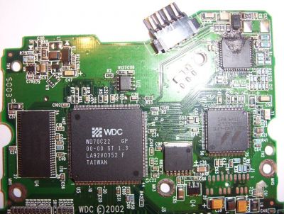

 Post subject: Wanted to Buy - Drive or PC Board for WD 160gb IDE
PostPosted: August 7th, 2008, 17:43
Joined: August 7th, 2008, 12:20
Posts: 5
MDL: WD1600JB - 00FUA0
Date: 09 Jan 2004
DCM: HSBACVJAA
One down, one to go. Saved the data on my other HD that had the same fried component on the pc board - anything reasonabley close should do the trick.
Much appreciated!
Cordially
Glen
 Post subject: Re: Wanted to Buy - Drive or PC Board for WD 160gb IDE
PostPosted: August 8th, 2008, 17:06
WD Marvel drive, you 99% surely will need the info off the ROM on the PCB, either read/write or physically xfer the ROM chip to the new PCB.
 Post subject: Re: Wanted to Buy - Drive or PC Board for WD 160gb IDE
PostPosted: August 8th, 2008, 18:24
Joined: August 7th, 2008, 12:20
Posts: 5
Thanks for your reply but I'm not sure I understand your directions. Can you explain or point me to a thread that can provide further details please?
The last WD drive (120gb) with the same burned out component, I just removed the old pcb and popped in the new one and it ran fine.
 Post subject: Re: Wanted to Buy - Drive or PC Board for WD 160gb IDE
PostPosted: August 8th, 2008, 21:48
Joined: August 7th, 2008, 12:20
Posts: 5
Here's a picture of the fried component on the pcb.
The pcb number is 2061-001179-000-DH
With the 120gb drive that had the same fried part (both taken out simultaneously by a failed psu) I just swapped in the new pcb and it fired right up (external drive).
PCB.jpg [ 154.51 KiB | Viewed 8211 times ]
 Post subject: Re: Wanted to Buy - Drive or PC Board for WD 160gb IDE
PostPosted: August 9th, 2008, 15:18
Posts: 2288
Location: In ur HDD !
I have this PCB in stock PM for details .
 Post subject: Re: Wanted to Buy - Drive or PC Board for WD 160gb IDE
PostPosted: August 11th, 2008, 4:39
oops. I was wrong, looking at the pic and having the PCB p/n helps. This isn't Marvel drive, I was thinking of GU family, not FU like this is.
PCB should work if ROM version is the same and the head map is the same.
Users browsing this forum: No registered users and 103 guests
